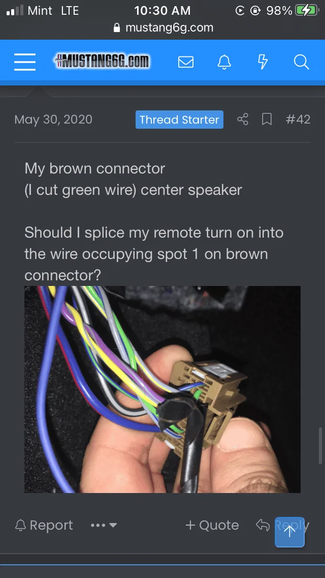

pop kick panel off, you can snip the green wire, I can post a pic of it and the connector or undo the molex connector clip and pop the pin out. I snipped myself
only 9 and 12 have center
12 speaker system should have subwoofer
mines a 17 9 speaker car, all the cars I read about the center speaker is also the green wire. It may of changed for 18+ I think it’s the brown connector, I’d have to look at an old post of mine I happened to take a photo doingother stuff
it’s the green wire with the black tape on it, I wrapped it up to make sure wouldn’t touch wnything. It’s next to the blue wire w green stripe I think that is.
I eventually just pulled that pin out.I will never reconnect it
