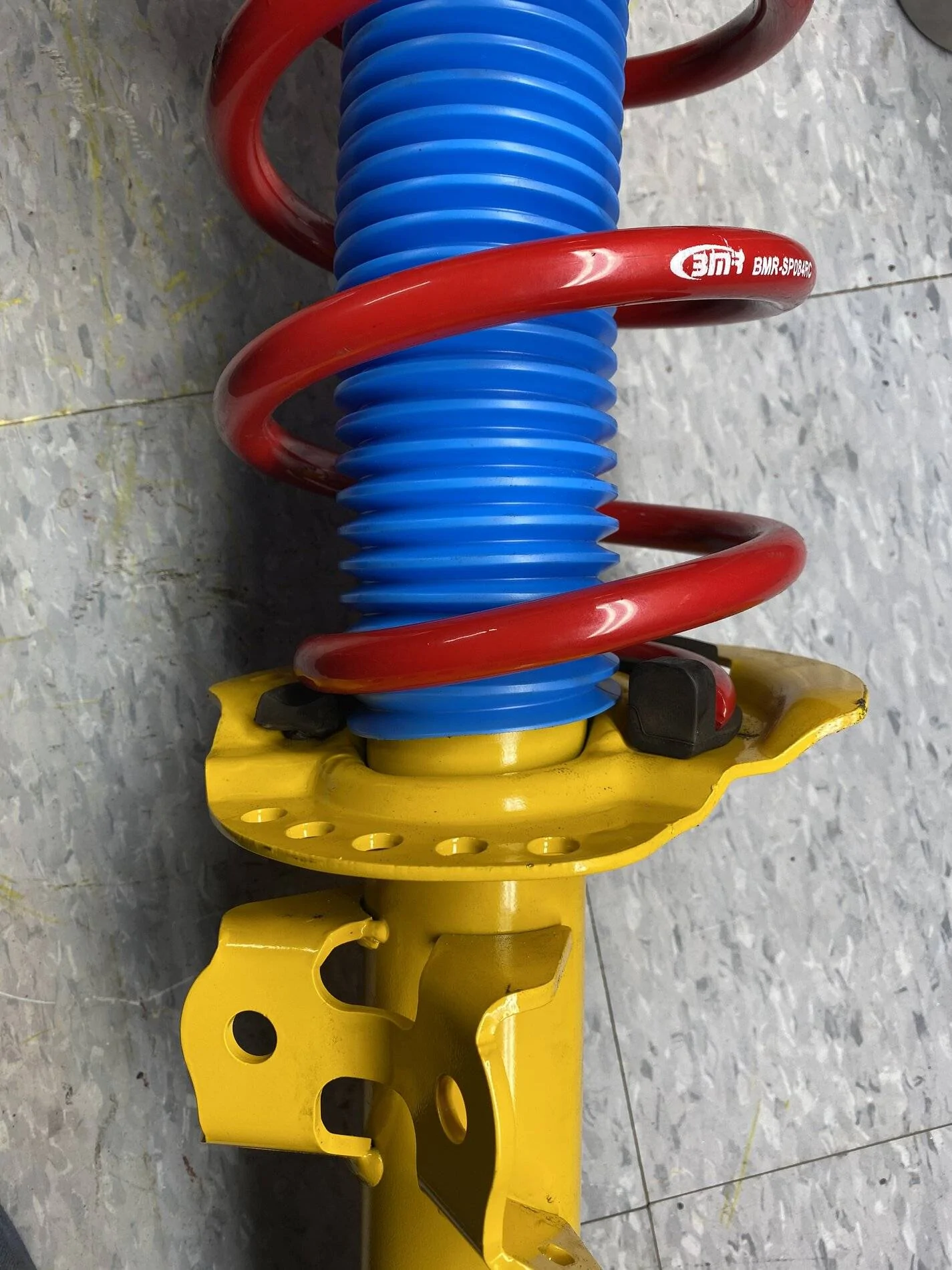

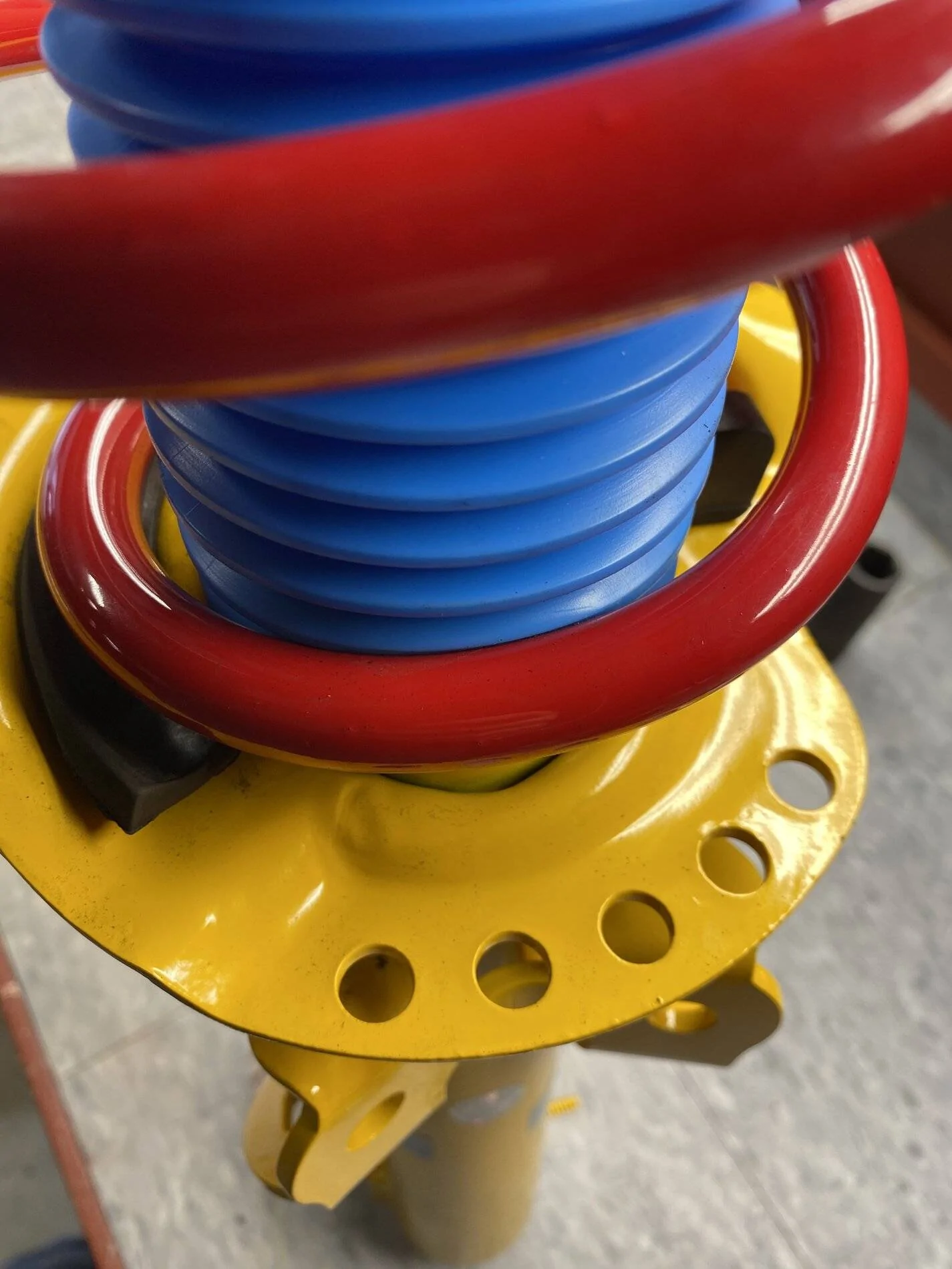

I’ve completed the fronts, I did both sides to see if this was consistent across them. It is. My question to those that have installed the BMR SP083 spring and Bilstein B6 damper combo is, did your spring sit in the lower perch like the stock spring or not? The spring is seated properly against the lower perch stop, I tried to capture that in the pics, but it’s about a 1/2 inch too far in where the spring starts to rise up out of the lower perch. So much so that the spring actually pinches the dust boot against the strut body. This is consistent on both sides. I do know the parts are identical left/right, it was my attempt at a quality check. I still have to complete the rears, so I haven’t driven on them yet. Pics below, let me know what you guys think and I appreciate the input.
