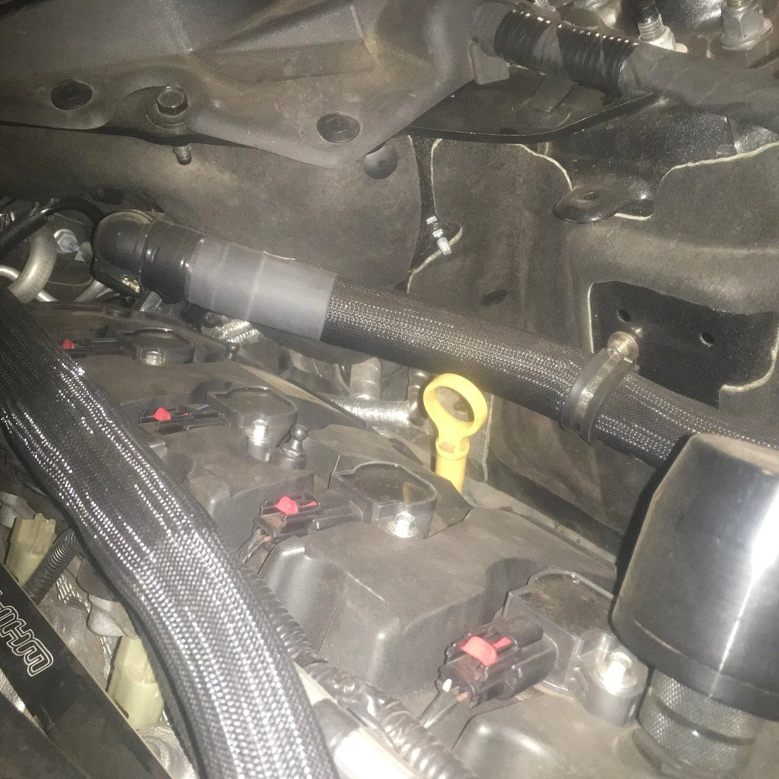

IMO, the biggest mistake people make is removing the stock sound tube as per the Whipple instructions.
I just installed an elbow and some tube from the factory tube to the airbox and it works well.
Not crazy loud but you can hear it when you’re into it.
