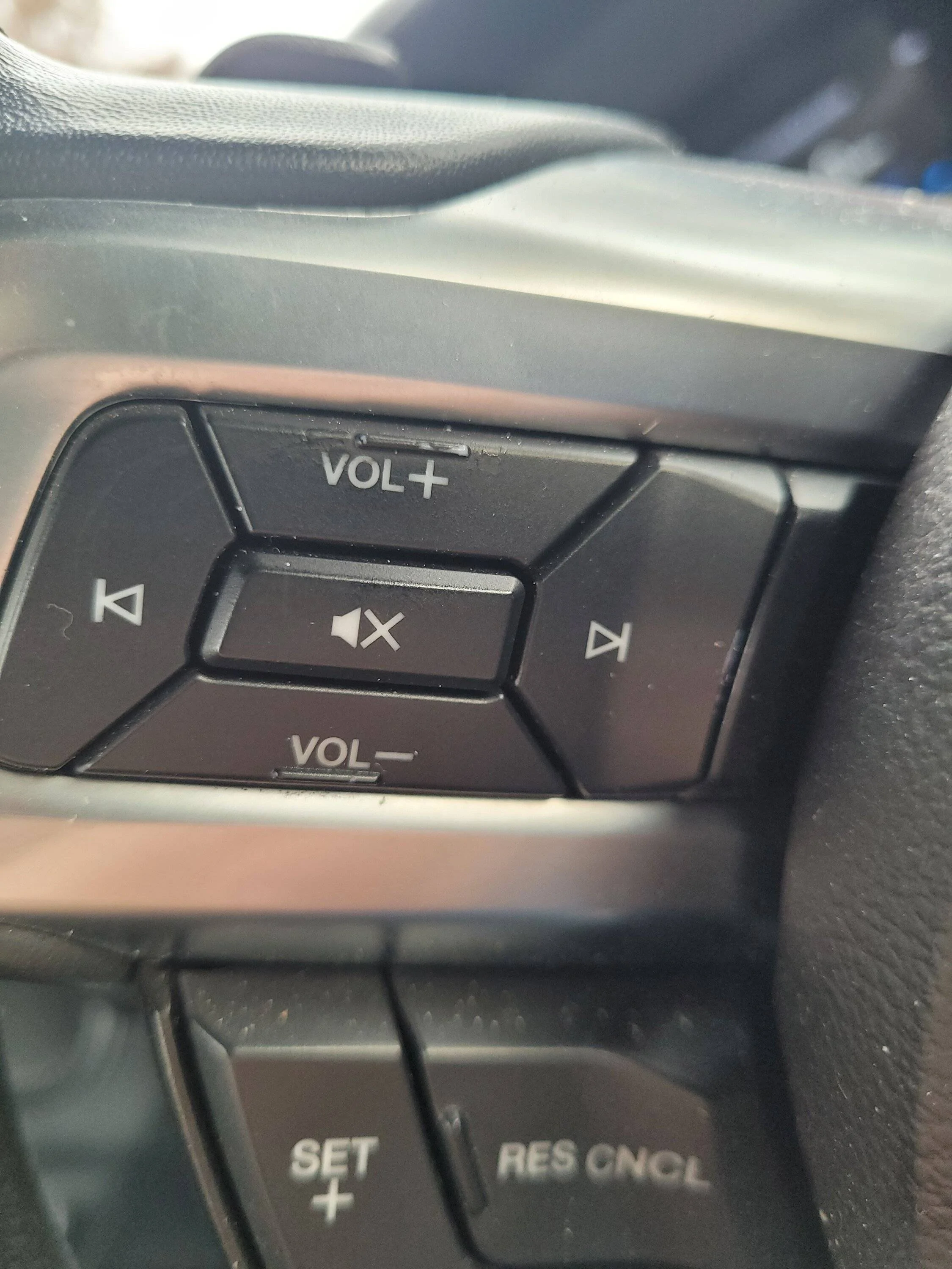

Not on mine. The button with the speaker followed by an "x" turns off the sound whether I'm on radio or the USB.
I was just coming to post this, I went out and checked. Obviously, you're right, however, using the volume for the radio still works.
Huh, how about that? I guess I never tried just turning the volume up after using that button. I always just pushed it again and it goes back to the volume it was at before. Learn something new every day...
