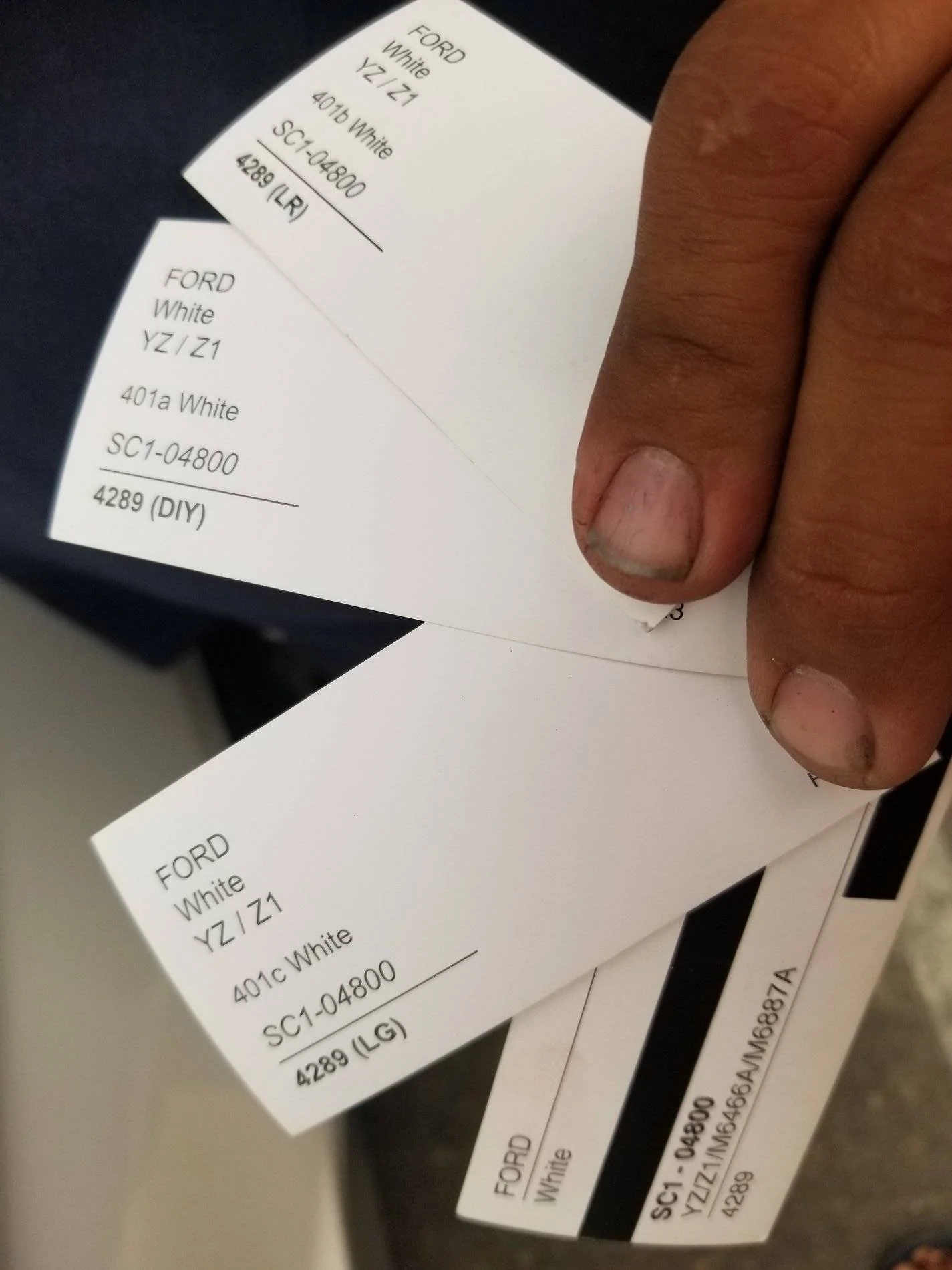

There are 4 or more different paint codes for each year color. It has nothing to do with blending or lighting, or a painters touch. All it takes is some due diligence. Get the sample color chart for your year vehicle. Place the color sample chart next to your car, select the matching color. Its simple
It isn’t that simple, In an extremely rare case you might luck out with a paint chip. The paint chip is a starting point and almost always needs worked with to get a good color match. We deal with this stuff every day.
Agree to disagree. I deal with it also. I can post a pic of 4 different oxford white color codes.

I wish I had seen this thread earlier. This is not a blending issue, this is a Ford issue.
Oxford White is not one color, and never has been despite what Ford, PPG, and the other paint companies tell you. On our GT350s Oxford White is a bright white. On a 2001 Ranger it’s a different color despite identical name and paint code. If you buy Ford Oxford White touch up paint it’s a cream white, not a bright white.
In the name of Shelby himself, do not let any body shop blend the cream “Oxford White” off-the-shelf paint with the bright white “Oxford White” on your surrounding panels. It’ll look like crap.
Source: 30 year body guy at one of the biggest Ford dealers in Texas. After multiple failed attempts to match the factory paint with Ford touch-up, Dupli-Color, etc., I went into the dealer’s body shop seeing if they could mix me a match. Before even telling him what color he said, “Let me guess, Oxford White?”
Interesting as well. Giving a name to a color and attaching a paint code to said name with different tints is plain weird. I’m guessing the year of car would be the differentiating factor.
Curious how Dr Color Chip approaches this problem.

I dont post much. But when i do.....i post facts...
Enjoy my friend.
Btw...this is why companies that send out pre-painted parts are doing the customer a disservice. Not their fault, OR is it?
Ive seen some companies charge an extra $600 to color match, because they cant find the right code. And to think theryre supposed to be professionals...
Lmk if anyone needs any help with paint codes, etc...
