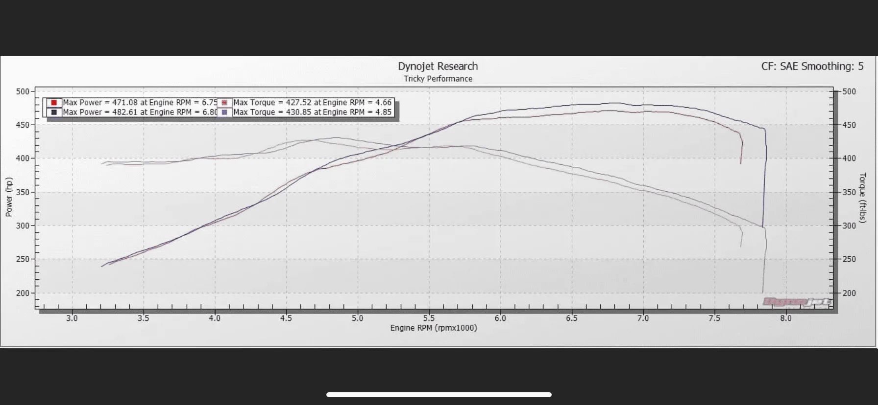

15 hp? Any loss of torque? Also if I was to go that route, would my stock throttle & intake box still work?
This is stolen from TrickyPerformance. 10 numbers without any tuning adjustments and nearly identical curve until 5800. Gen3 car. I’ve ran them both personally and can tell you 350 is faster. There’s a reason Ford offers it as an upgrade and the Mach1/Bullit was an up-trim. Stock TB needs either the Holley or VMP adapter
That looks promising.
