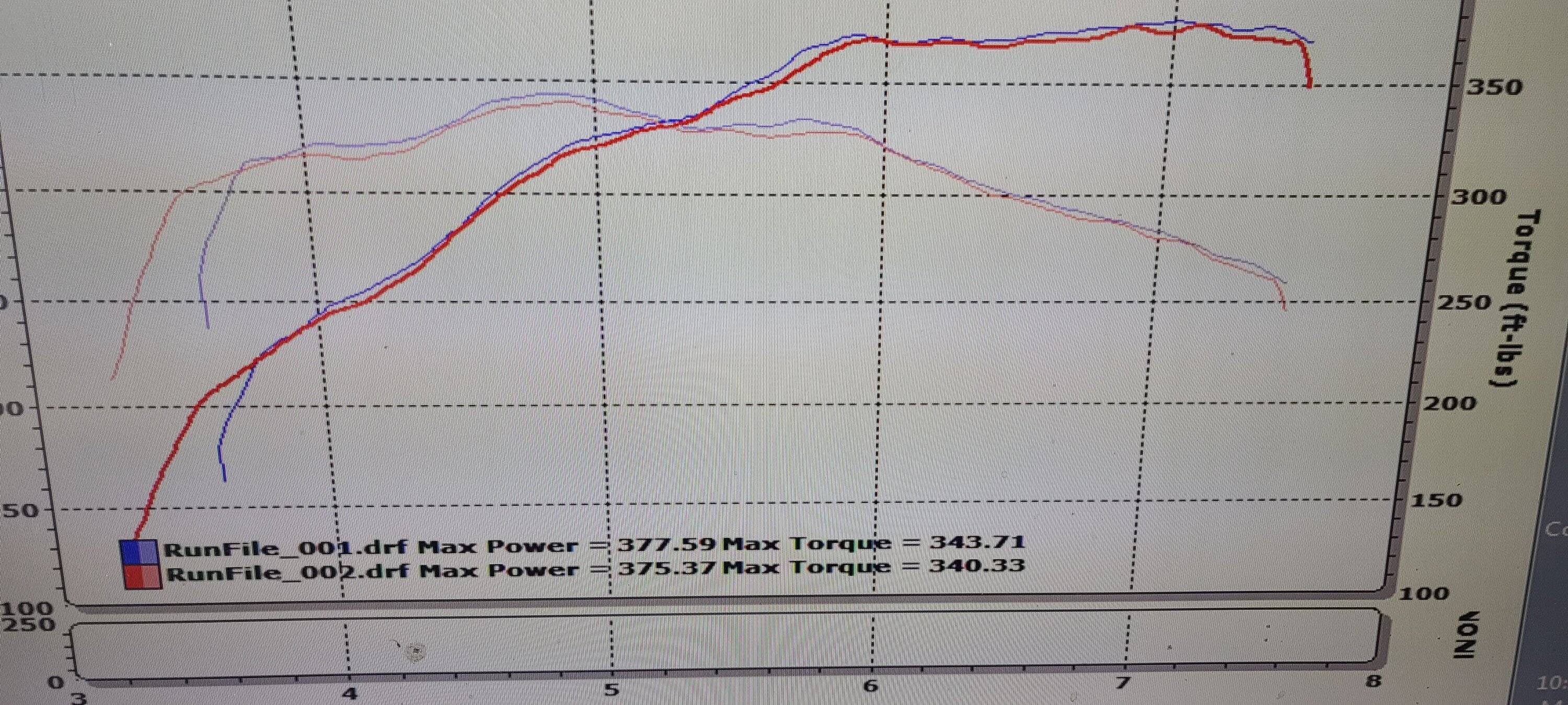

For anyone that was curious and still watching I got the car on the dyno today stock it put down 377 rwhp kinda low I think the dyno reads on the lower side considering most gts seem to put down 400ish. After headers and e the car put down 415 we then added the Soler throttle body and the jlt and it put down 446 rwhp. we didn’t have a chance to add the ported manifold today but curious to see what It reads in about a week after adding manifold and redyno. Also I’m more than positive the e content was prolly rising with each pull I don’t think intake and throttle body would add nearly 40 hp. Also I have to say the throttle body is awesome has great drivability and seems way snappier whole car feels smoother as well a lot of what seemed like lag and hesitation is gone when getting on it would definitely recommend.

Also sorry I only have stock graph I got like a little kid after hearing the car rip on the dyno and forgot to go snap pics when I redyno I’ll make sure to go snap pics.

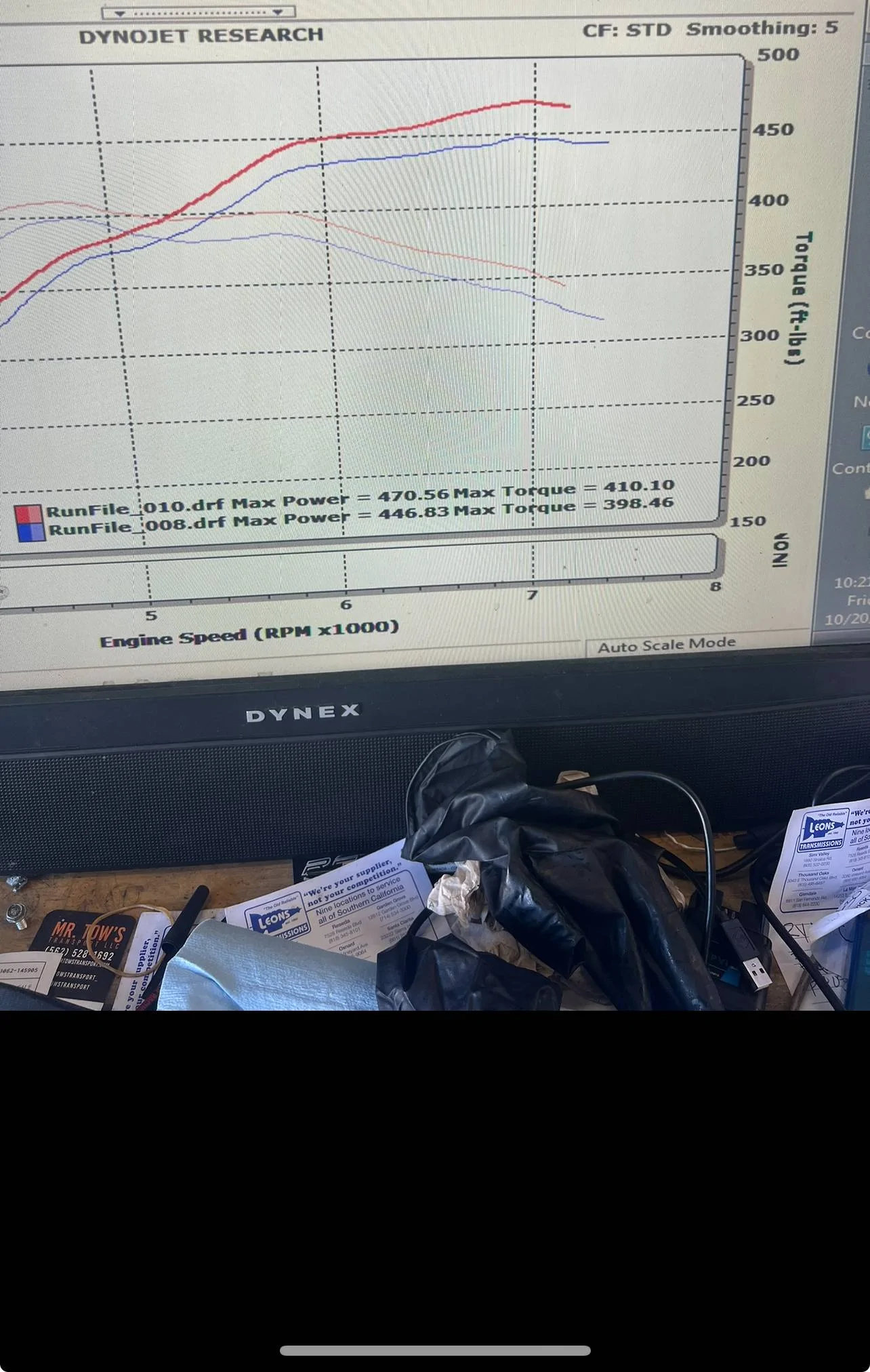

We’ll took longer than I thought life happens but manifold is on attached is the dyno suck I cut off half the graph but can see where it deffiantly made gains now this is on different days so can’t say this was all manifold but it deffiantly feels stronger when driving seems to pull harder in the top end I’ll attach the stock graph below

Stock graph for reference on the other graphs the 446 was with arh long tubes corsa extreme catback jlt cai and e85 soler 85 throttle body

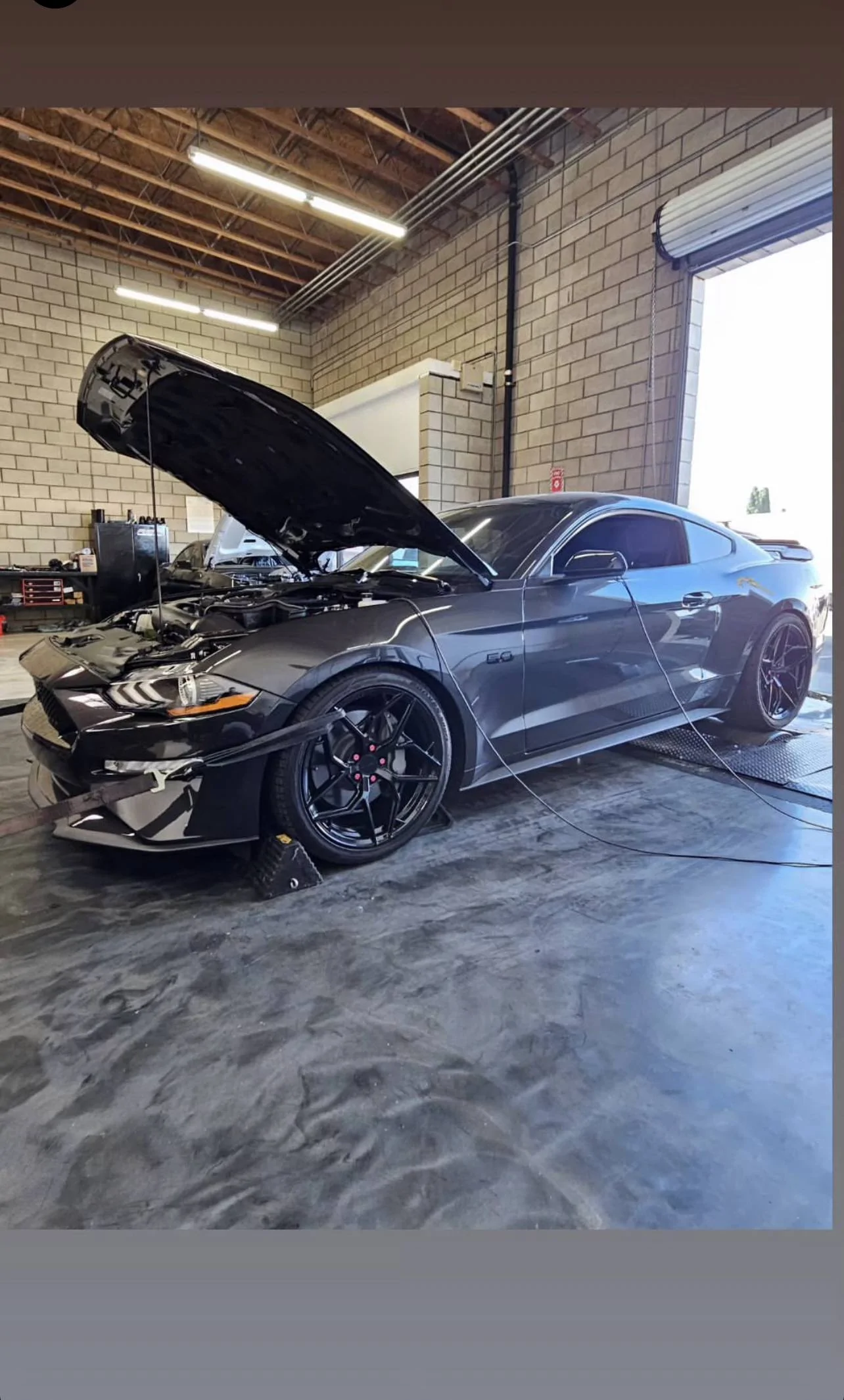

Dyno pull
