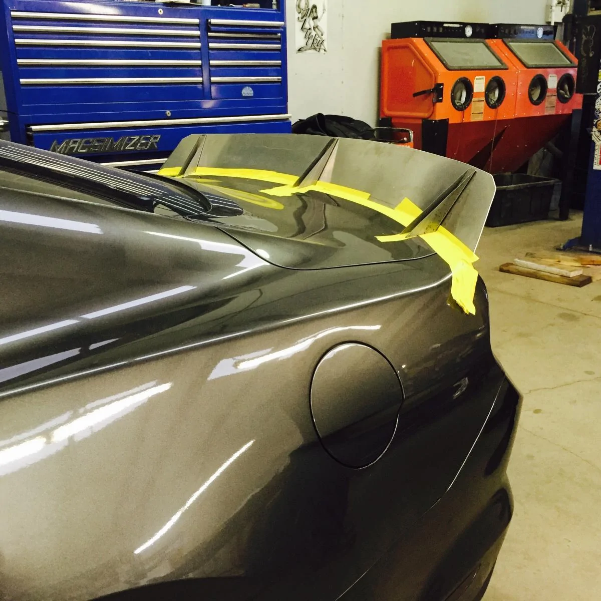

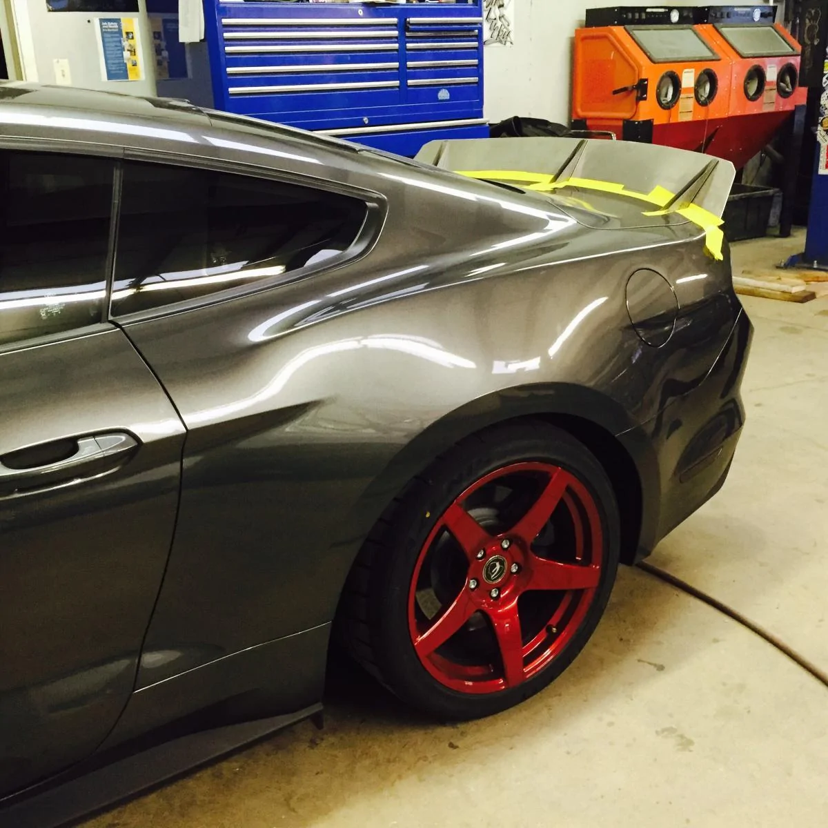

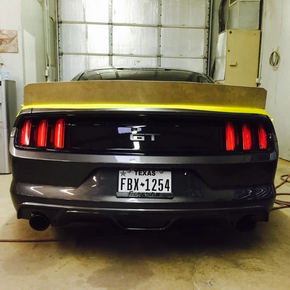

USCA legal spoiler!
I finally got a chance to build a USCA legal spoiler for Project 6G! Templates are made for the laser cutter and parts for production should be coming soon!

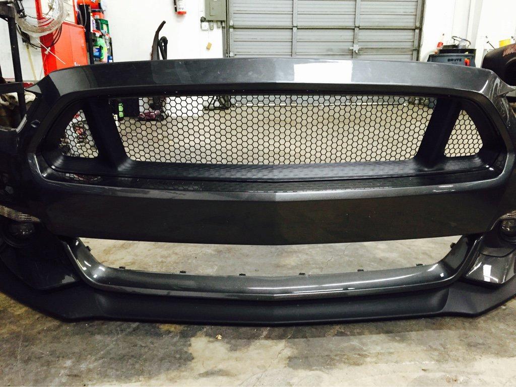

I hope a front spoiler and/or splitter are next as just adding a big rear spoiler seems likely to unbalance the aero.
What tracks have you run on? I would be afraid that the short gears + short tires = limited top speed before you have to shift to 6th, which with it's big rpm drop would kill acceleration.
Splitter is in the works. As far as gearing, I might switch to 3.55 or 3.31 when we do the Turbo setup. As for now Motorsport Ranch Cresson, Eagles Canyon, and TMS infield course, I have not had to get out of 4th on the straights, but am close to my tunes redline just before the breaking zone.
