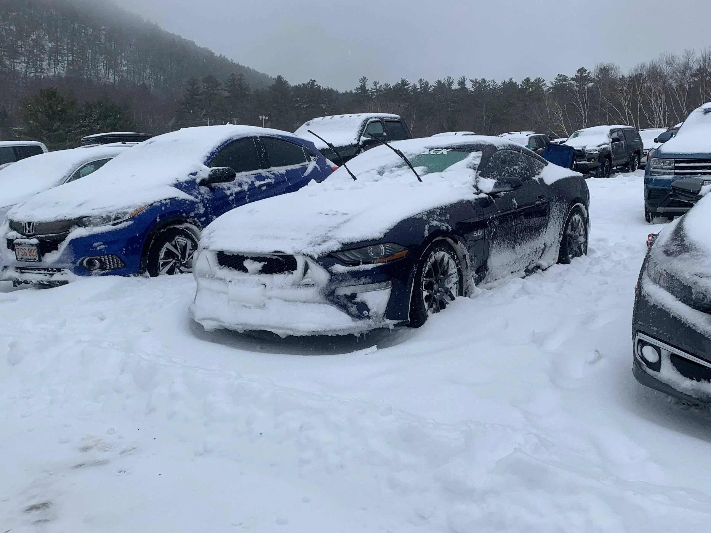

This would would imply you had too much throttle applied. The real way to do controlled slides is to have the wheels spin pretty slowly. Source: I take a Mustang skiing on powder days.
Edit: And a ~4000 rpm burnout seems about right to get unstuck. Good balance of digging to asphalt and causing the torsen to work while also being able to control the situation.
