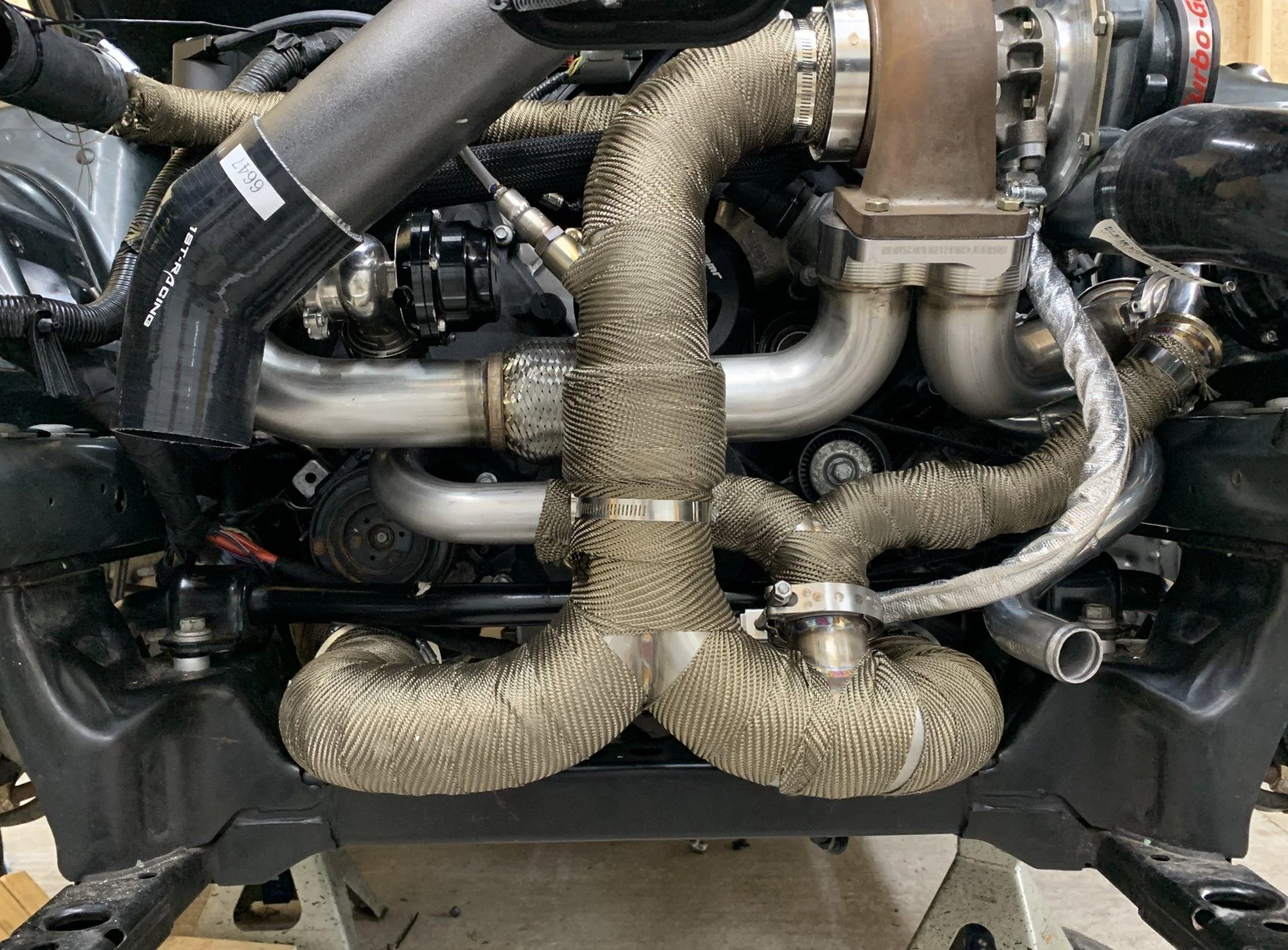

The reason there isn’t a single turbo setup is our cars are limited on exhaust options with a single. Most kits just go out the bumper. Or just limited where to put everything honestly. A tubular subframe would help tremendously.
I bought an s197 on3 kit last year and have since changed basically the entire thing.
The twin mount top or bottom kits perform really well too.
This has been my solution to what to do with the down pipe to get it to the rear of the car.
