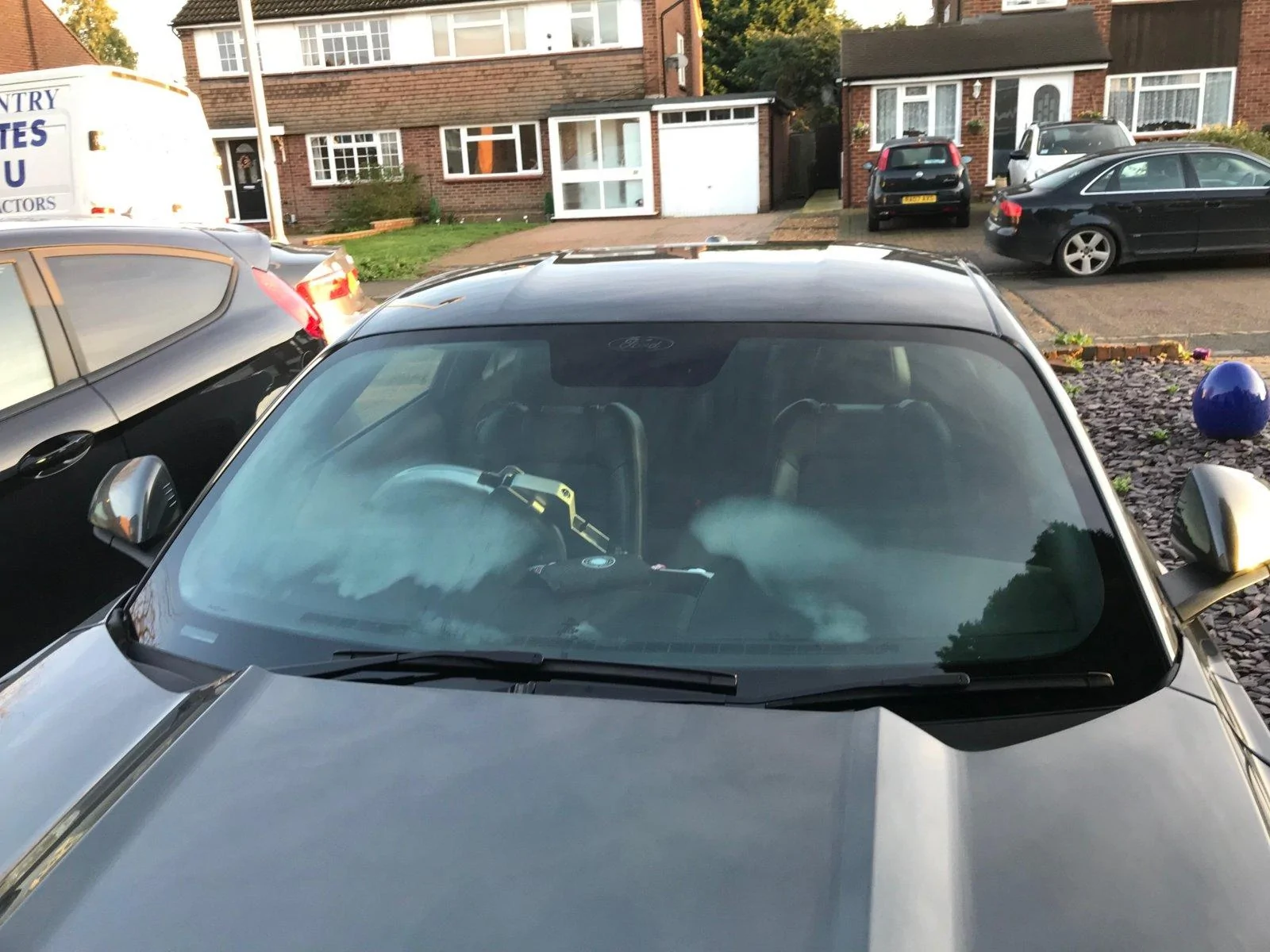

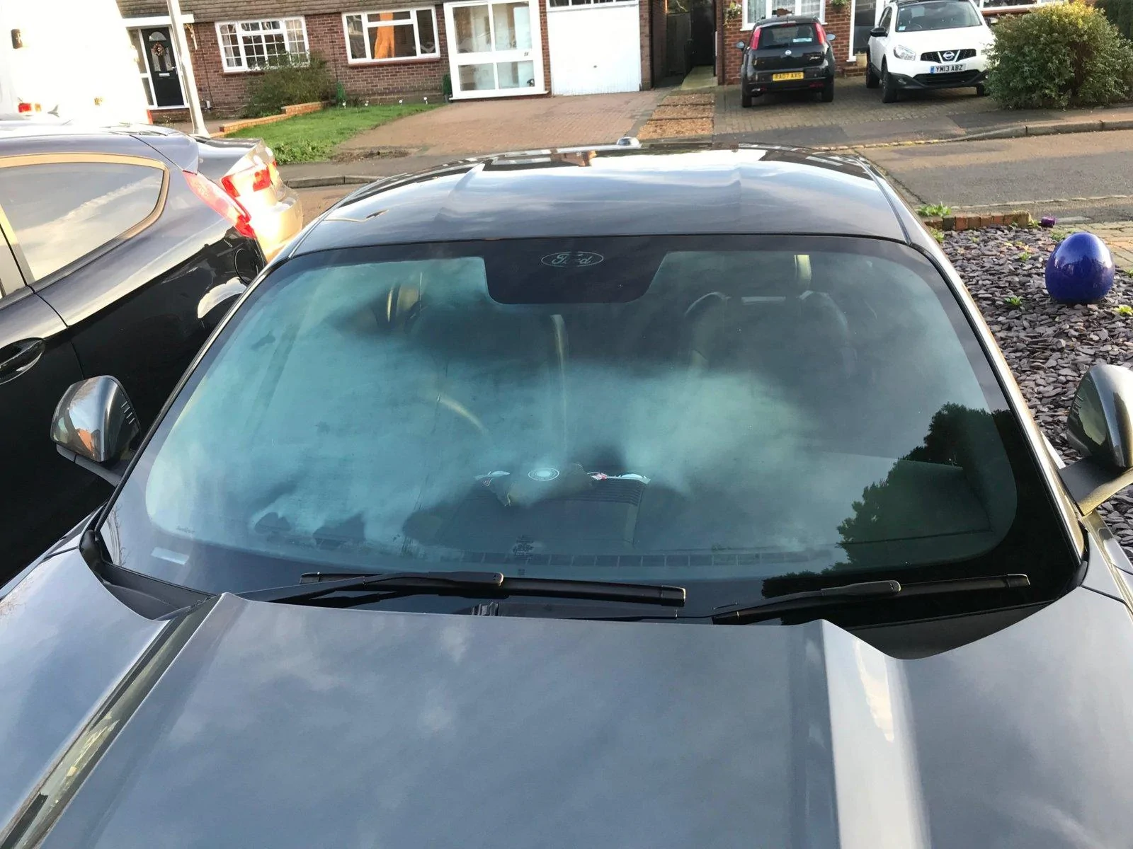

Haha - exactly what I just added to the car! Got mine from Amazon - same price I think (£8). Few pics attached - this is a good example of where I see issues, not used the car at all today so it's been sat in the sun for a few hours. I'll report back on how I find the dehumidifier pouch. Those droplets are from the outside in case anyone notices!
Running round with your aircon on and windows closed helps dehumidify the air in the cabin (if you can bear it this time of year). This is because water condenses in the aircon unit and is expelled so drying the air....
This is also why sometimes demisting is quicker with the aircon on than with the heater on as moisture simply condenses on the colder window

I wonder if the engine has anything to do with this? That v8 does generate a lot of heat. I went for a 10-15 min drive this afternoon, pleasant day - sunny, about 7/8 degrees. Whilst driving, I had the tempt set to 21 & the ac was on. I drove the last mile or so with the windows down by a couple of inches - not fully down, just to let some of that crisp cool air back in. An hour to 90 mins after driving I stepped back outside to take a look and the usual irritating view greets me. I was sure to put the dehumidifier pouch back on the dash when I got out - seems to have had little effect here.
I do note however, that as the sun sets here the whole left side of my car gets a decent amount of sunshine - the passenger door glass was actually warm to the touch. Again, that could contribute to that big change in temp.
I did wonder about the disklok too, but I added mine at the same time of year as the temp dropped significantly so it's hard to tell.
The only real world test I guess is for me to do a like for like comparison with another Mustang. May have to have a friendly chat with a dealership & see if they can give me a loan Mustang. It needs to go in for an oil change anyway I think (back at 5% life and just hit 10k). It really makes me nervous seeing where exactly this condensation crops up - it's all to similar to what I experienced a year ago, even though the carpets are not soggy right now, I seem to have similar symptoms.

Update - a further half an hour and you can see the condensation has started to go - perhaps as the temp is leveling out?

That looks normal to me. Drive with the climate on and don't open the windows. The outside air is pretty saturated today - dew point is + 3 or 4C hence the reason for the fog patches.
My Mondeo has had climate on auto since the day I bought it - never steams up and only need the heated front screen when very cold and frosty
Sadly the Mustang doesn't have the electric heated front screen common to all other Fords
Good point - I rarely use the climate actually. As you say, shame the stang doesn't have the proper heated windshield...got it on my Fiesta and they are brilliant.
I'd still like to see the same effect on other cars though - 4 in the driveway at the moment and yet mine is the only one looking like this. Dad drove his A5 today, although it was a few hours before me, and I don't see any condensation on his.
