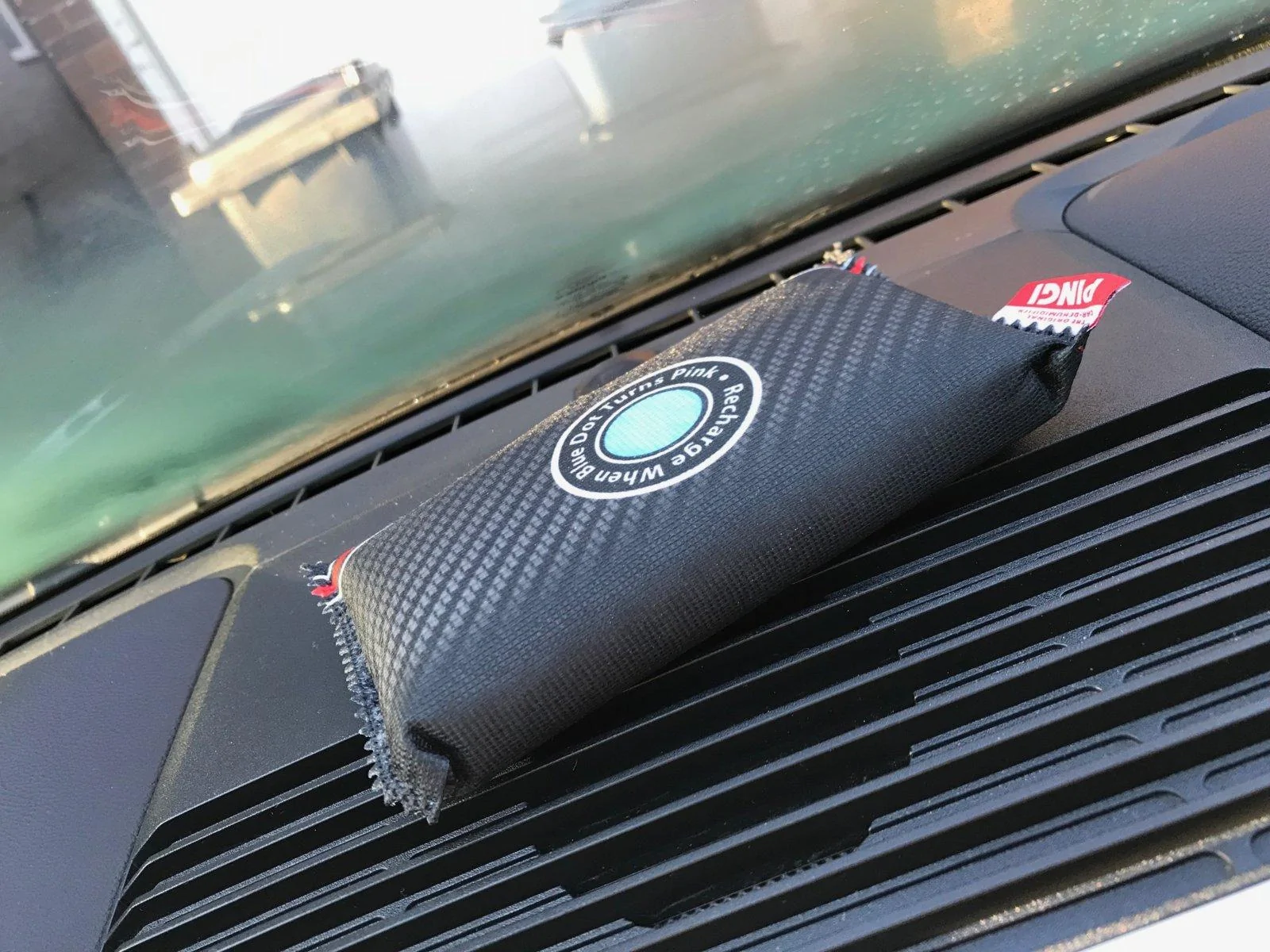

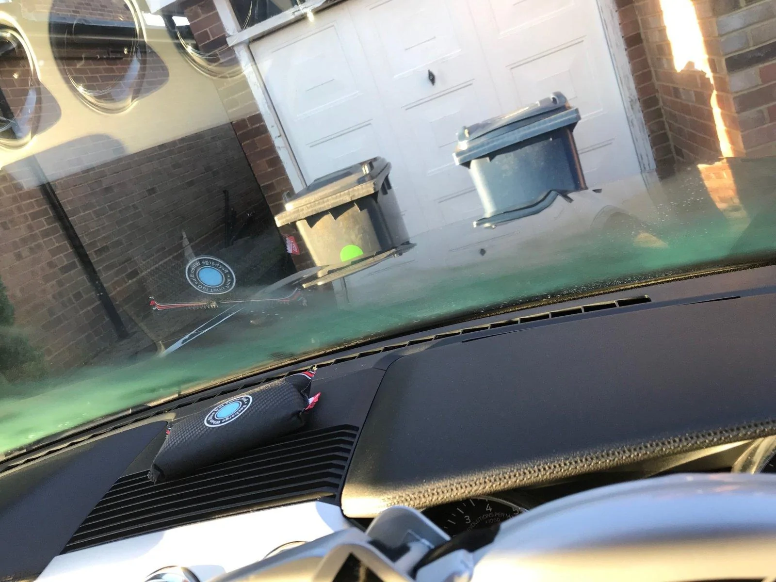

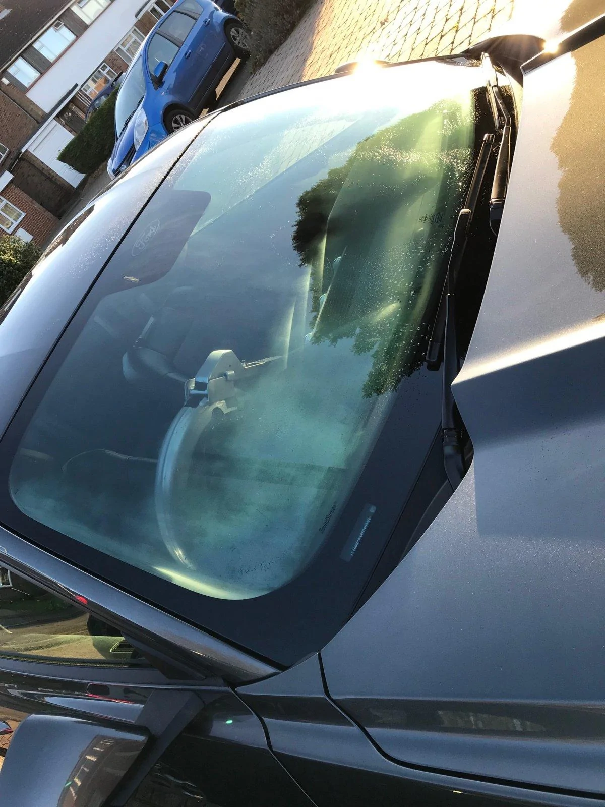

Asda do a car dehumidifier; this does seem to help. I use in the Stang when parked up and daily drive. All cars suffer a degree of fogging in cold extreme weather and this can be get worse when the weather warms up - https://groceries.asda.com/product/car-maintenance/pingi-cardehumidifier/910001475718
Haha - exactly what I just added to the car! Got mine from Amazon - same price I think (£8). Few pics attached - this is a good example of where I see issues, not used the car at all today so it's been sat in the sun for a few hours. I'll report back on how I find the dehumidifier pouch. Those droplets are from the outside in case anyone notices!
