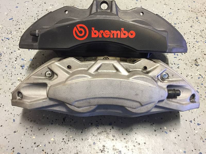

I recently switched from the 4 piston calipers to the 6 piston Brembos. To be honest, in my application, mostly HPDE, 3 - 5 days a year, the 4 pistons were remarkably adequate in most situations. I experienced brake fade only once, and never again after updating pads and fluid.
That said, the 6 pistons are monsters on my car. I have yet to be able to fully exploit them on the street and honestly have room to improve on the track. The main reason I switched was because after a season, the 4 piston calipers were wasted. I only have 2020 on the 6 piston calipers and I only squeezed in 3 track days this year, but they seem barely used and certainly not abused like the 4 piston would at this point.
When I installed the Brembos I went with PowerStop's Track Day Pads and rotors. The rotors are cheap. About $100 less than the DBA rotors I was buying for the 4 piston calipers, and they are showing significantly less wear than the 4 piston DBA rotors.
I was extremely reluctant to switch to the 6 piston calipers because I run an 18" winter wheel & tire here in Ohio and was afraid I couldn't find or afford rims that would fit over the 6 piston. Now that I've made the switch, I sorta wished I'd have listened to all the people that told me to make the switch sooner. Of all the expensive mods I've made to my car to make it fast and last, this has been one of the most effective and cost effective.

I do not understand how the 18in does not fit brembos when the continental 4 piston is bigger. I just bought the m2300v kit and will be installing soon ;-)
The 6 piston looks taller because of the pin holder at the top and uses a larger rotor than the 4 piston. Barrel clearance would be the issue.
I still have my 18in wheels after getting MRR M350 19x10... I will test fit the 18's after install and report back... Yes 1 inch larger rotor but that is half an inch to barrel and to me it all looks like it would clear...

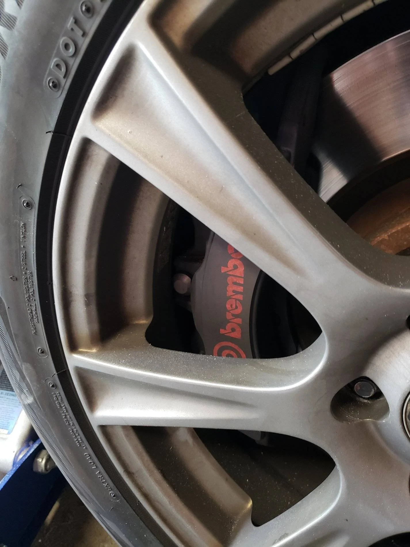

This is my 18" wheel with a 1" spacer installed.
It still looks extremely tight, but extremely tight is not touching so I'm going with it.
These were the cheapest rims that Tire Rack sold as a winter wheel and tire package. At the time of purchase I didn't see any problem going forward. Then the track bug hit...and well...
Yeah that is super tight! Will try the same with OEM 18x8... I just need to get all the stuff for install... Mostly the high pressure bleeder ;-)
