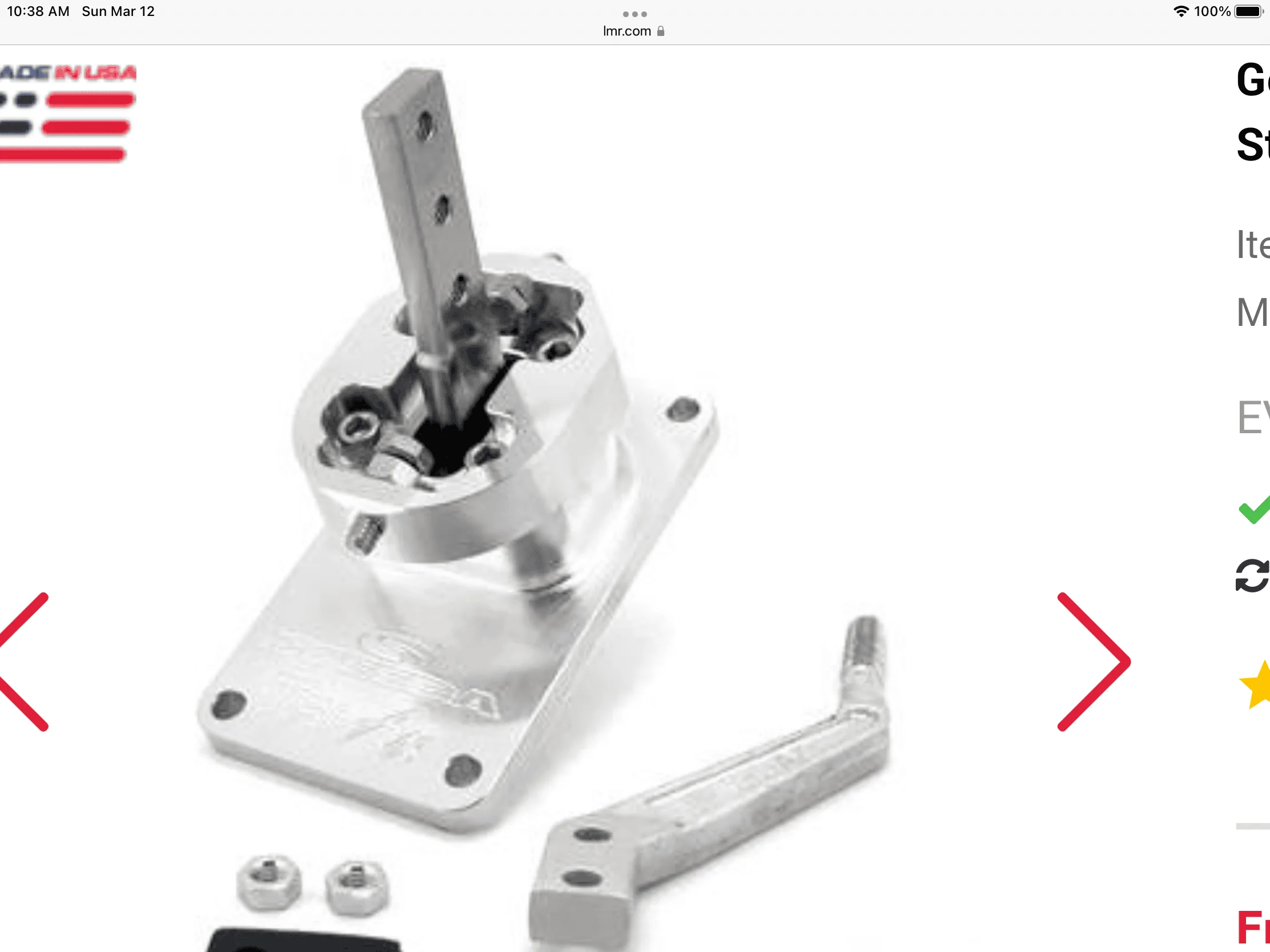

Would a shifter like the MGW offer shift fork protection given that it doesn't have any play and is bolted to the transmission?
No. You could still overextend the shift lever and damage the forks. That was the first thing I noticed when I installed a Barton in my 2013 GT. The shifter would need to have bolts in front and back of the shift lever as seen here in this pic. You would put the car in 3rd gear and 4th gear, adjust the two stop bolts accordingly, lock down the jam nuts and youā€˜d be all set to bang gears.
Ah, I see. Thanks for explaining that.:like:
