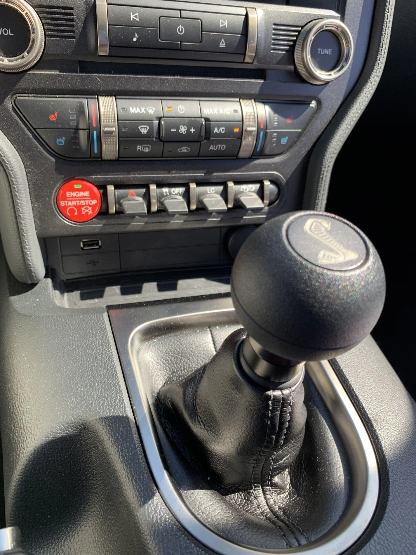

What shift ball did you get? Mine is below. I also installed the non-SYNC surround.

I bought the stock shift knob adapter as I wanted to maintain the stock look and I actually like the stock knob.
