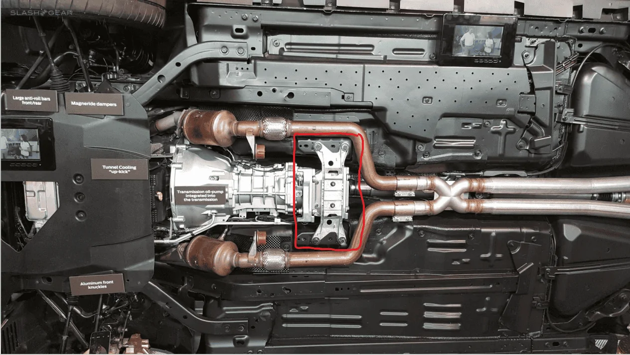

I had a buzzing when I first installed mine, so I looked at the gap around the shifter where it comes up through the top of the tunnel. It was super close on one side, so I got under the car and moved the crossmember over about 1/8". Buzzing's gone.
Is the crossmember you’re mentioning that main support bracket on the bottom of the transmission?

2018 SHELBY GT350 LEAD FOOT GREY
It's this bracket

It's this bracket
Well that makes the second person to mention that bracket as a point of concern. I’ll pull the boot off and see which side my shifter is closer to (I do remember it being very close to one side as well) and try to position the bracket further the other direction.
