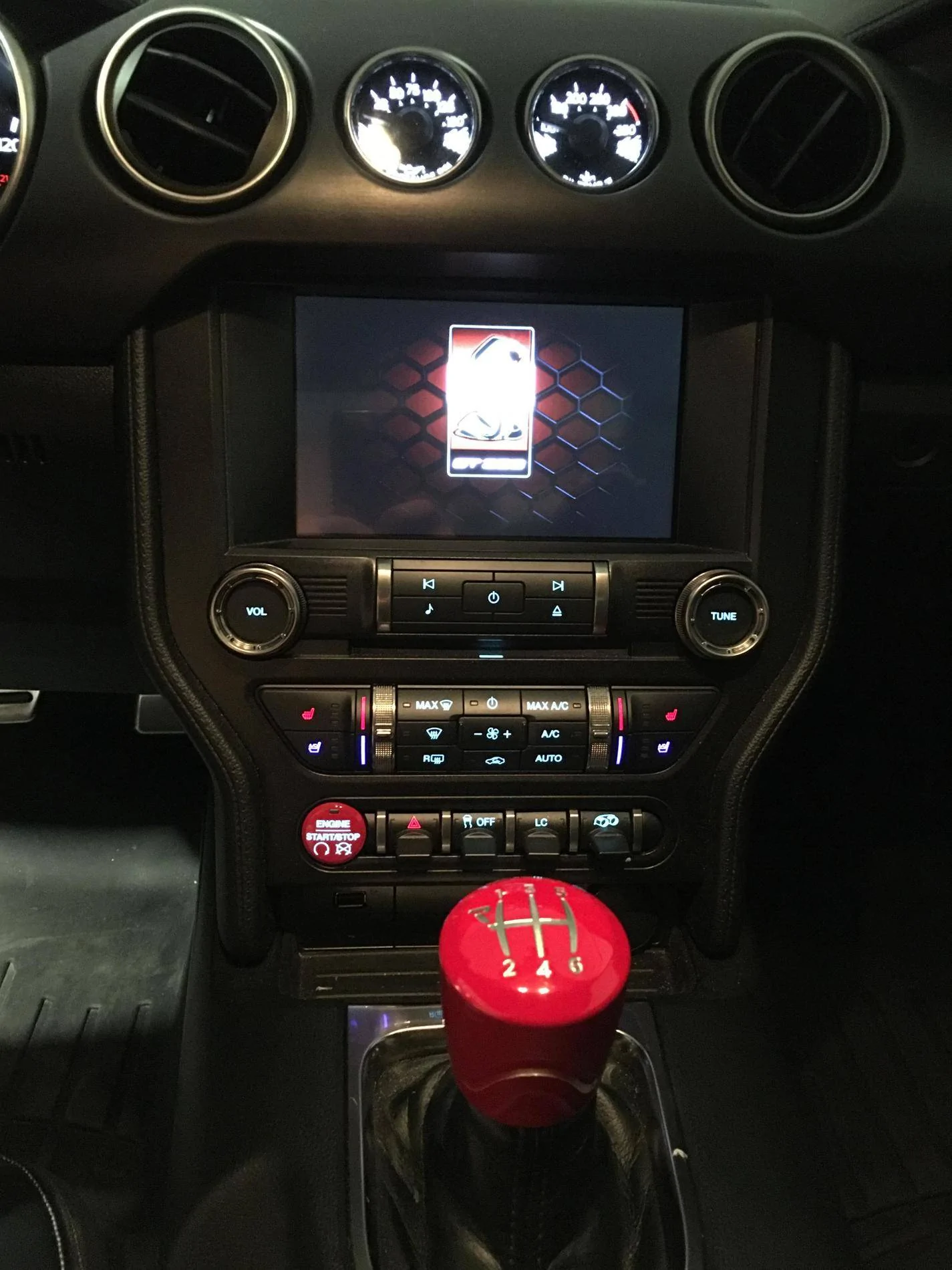

I got to admit... I'm extremely pleased with the 675gram shift knob from Raceseng which the model I went with was the Ashiko. First of all, they actually make you feel like it's a $200 shift knob from the beginning of the unboxing to the end. Everything just feels right.
I was impressed with the MGW Shifter from the beginning but I always had issues with 3 to 2. MGW actually has a solution that won't cost you anything to do BUT to be honest I just had to try this shift knob out for myself to see if it actually made a difference and I'll tell you this much, it definitely compliments the shifter. Did it solve my problem? Absolutely, it also made every other gate which was previously smooth even more like butter.

Thanks for the info and the link. Got any pics of your setup ??
by the way, I’ve heard people complain about the 3-2 shift with the MGW. I wasn’t aware MGW had a fix for it. Care to share what that is?

I added a photo per request.
The video below demonstrates how to remove the spring.

Ahhh. Now I remember seeing that video of the spring removal fix. Thank you for the link.
you got the exact same setup with the shifter that I am thinking about.
looks killer.

Hello NoXiDe, your Ashiko shift knob looks Awsome ! A few quick questions if you would be so kind to answer.
First, did you purchase and install the Raceng "Saggy Shift Boot" retainer ?
Second, how big are your "Paws" as that shift knob looks pretty big compared to the stock knob ?
Lastly, any idea on how much lower to the console your new MGW Shifter and Ashiko shift knob is ?
Thanks for your response, Ray

@SL8888 With the GT350, If I remember right you are required to order the Shift Knob Adapter. Especially because the Big Bore is literally what it means. It's bored out pretty wide and so the Adapter allows it to become compatible with the car's shift adapter. In my install, you should technically see the OEM Silver piece underneath but my shift boot doesn't have the o-ring that keeps the boot upright, hopefully that makes sense, so the shift knob eventually tucks that part away. Aesthetically, at this point it's just preference and it doesn't bother me enough to replace my shift boot. Kind of grew on me. haha.
Second question, I got small thin hands. It is bigger than the stock knob so you will notice it when you press against it and your palm may feel it too but it will strength overtime as with anything.
Third, I measured this for you but I got 4 inches and 3 quarters tall.
