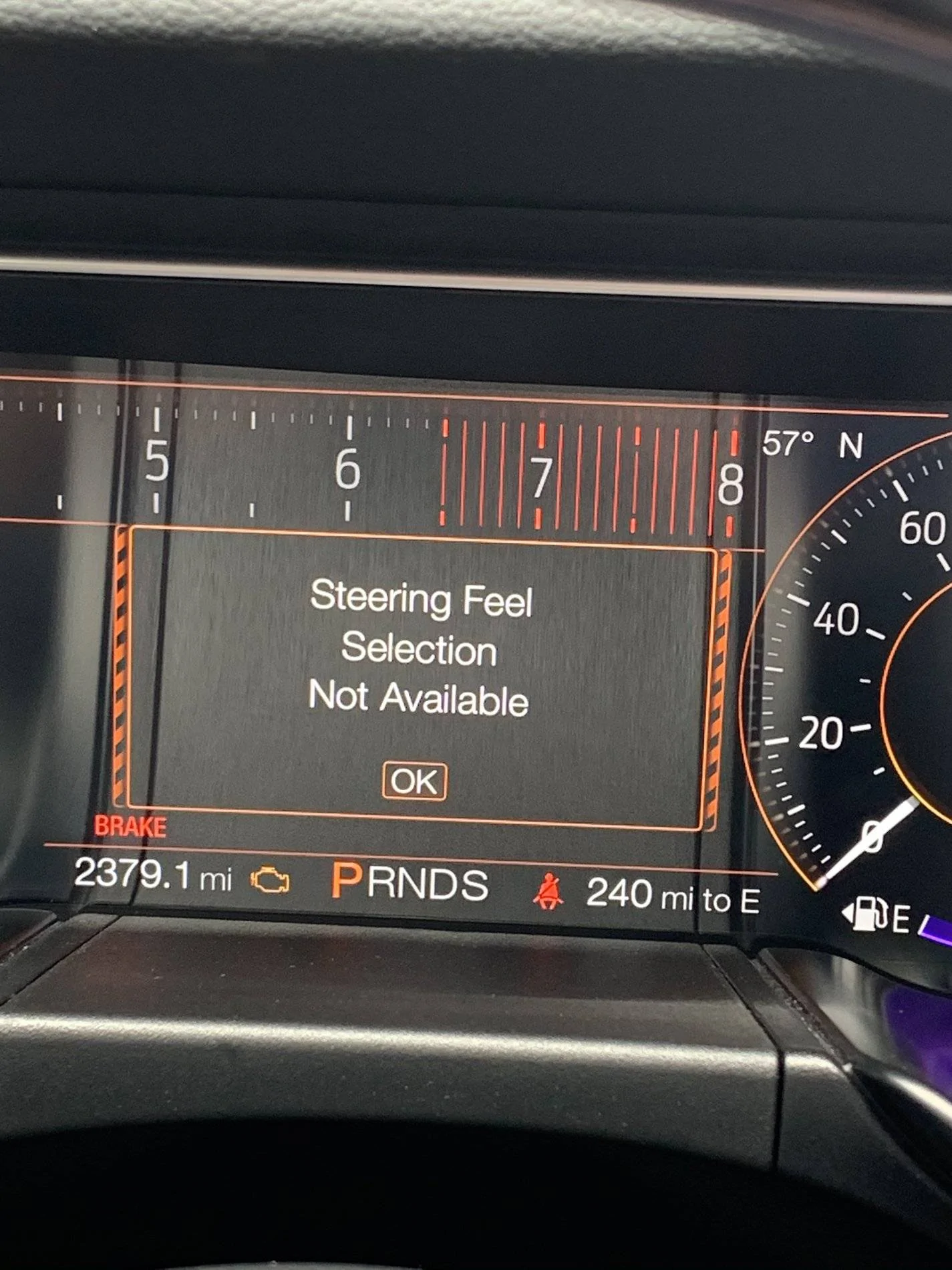

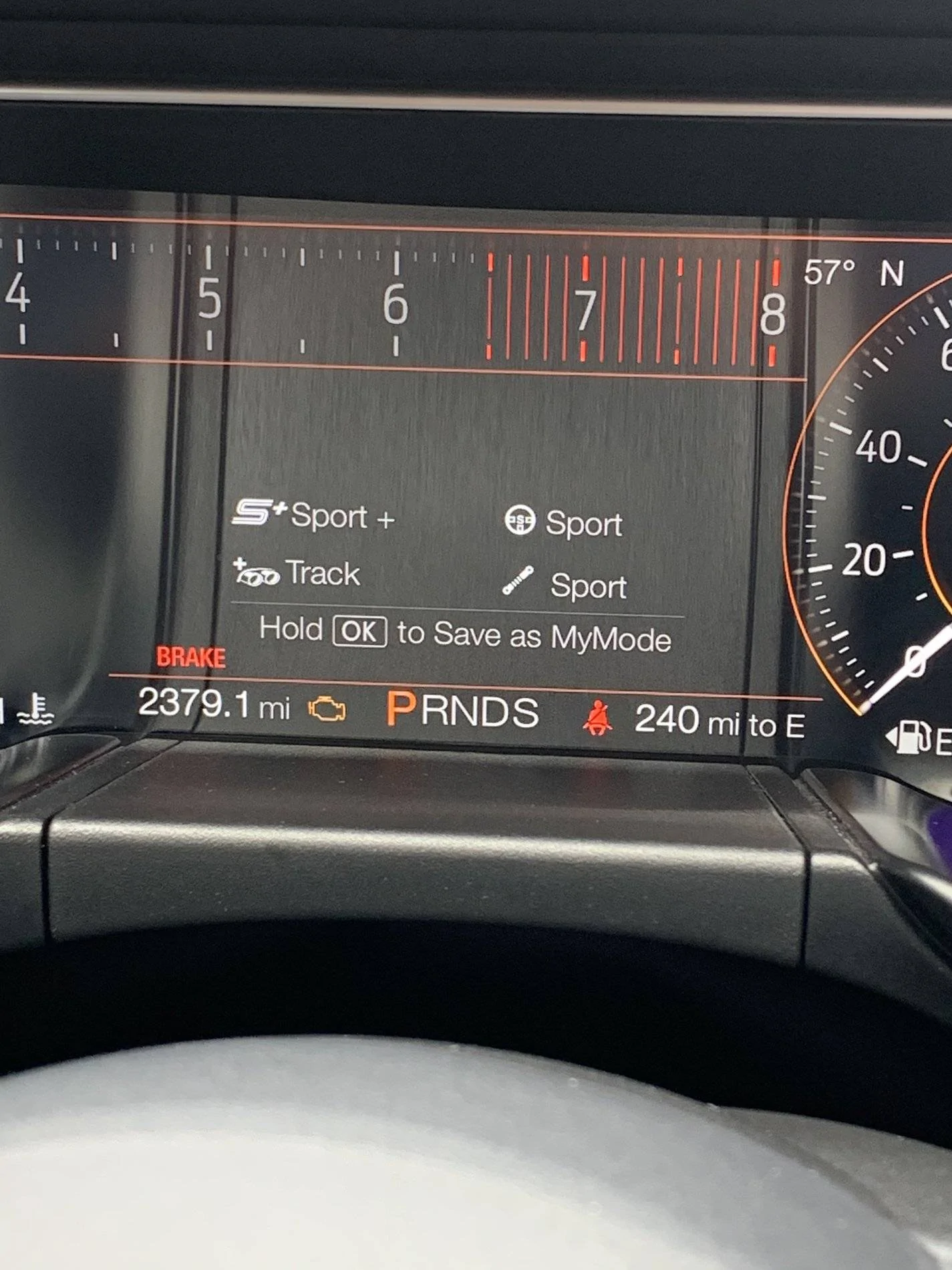

You are correct about exhaust mode. However for car with magneride, you cannot change steering mode independently in any driving mode except normal. As pics below, im in sport+, i can change exhaust to track but when i toggle steering switch, i get the message.

can not individually adjust them. and trying under my mode still defaults to the mode its in. ie track mode wont let you change suspension or steering but will let you change exhaust. at least how it is on my vehicle.

You need to specify what you're talking about. Talking about drive modes, sport mode puts you in sport suspension mode, and you cannot change that. And apparently you cannot change the steering mode either. I don't know if my car shows sport or sport+, but I've never noticed the '+'. As far as exhaust mode, I think you can choose anything you want in any mode, and save it on 'MyMode'.
That's really strange. My car (2018, A10 without magneride) lets me change the steering feel even when I'm in Sport+ or Track driving modes. I do it all the time because I'm not a big fan of the heavy steering setting.
