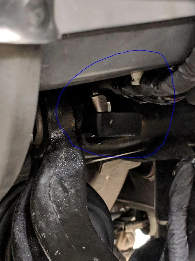

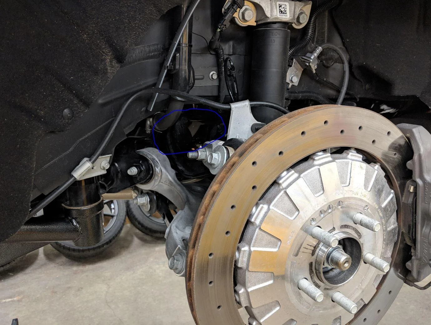

Found a problem on mine this weekend while installing the Steeda rear camber adjustment brackets. Driver rear ABS sensor wiring was pretty tight against a metal tab that keeps the bolt from rotating while being tightened. I had to bend the tab a little. I could see the metal sawing through the wiring over time. Just a thought. Can grab pictures later. Just my $0.02
Yea would love some pics. Not sure where all of the sensors are. I’ll get it clean today and up on stands for inspection.

It's right where the camber arm connects to the rear cradle/subframe. I don't have any before pictures, but I finangled the wiring around a bit and bent the tab slightly so they no longer make contact. Hope this helps.
Thanks brother. Checked that. I can confirm that’s not the issue.

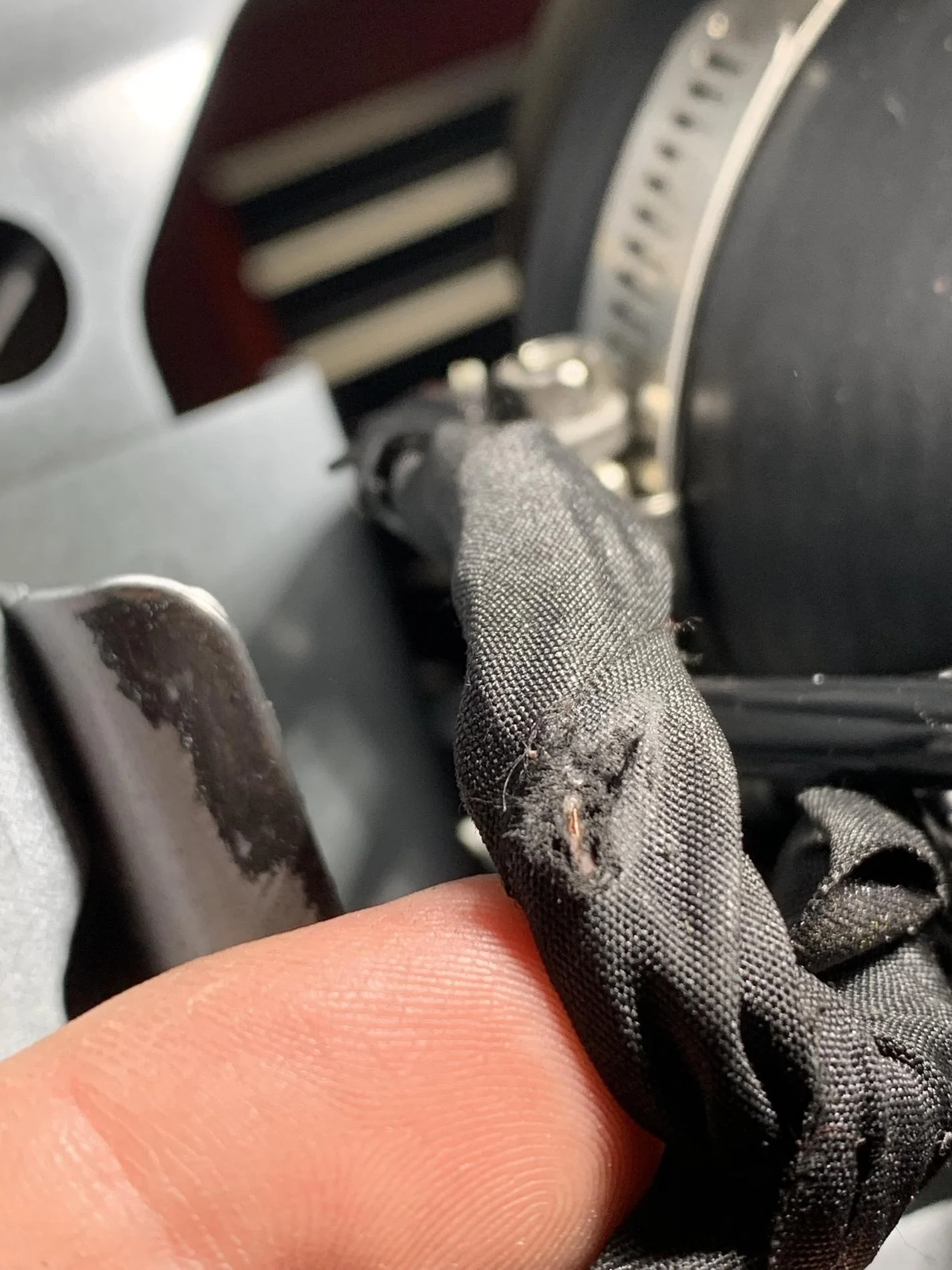

ALSO, the steering assist system is now erroring. Throwing two codes:
U0121 - lost communication with ABS module
U0212 - lost communication with steering control module. I can clear them and they come right back. I got the car in the air and pulled the driver front liner:
I started poking around the harness up front where the steering and ABS module run towards the front next to drivers side headlight. Sure enough, the problem cleared and went back to normal. So, looks def like a wiring problem vs hardware. I’ll have to pull the front facia and see what’s up.

ok here's the update: found the issue. chaffed wire grounding out in driver side corner behind headlight. This harness runs to ABS among other things and was likely causing the chaos. since isolating this I can now start the car, clear the codes and everything operate normally. edge of this harness raised up and was just touch the wire meshed air filter. Live and learn.
