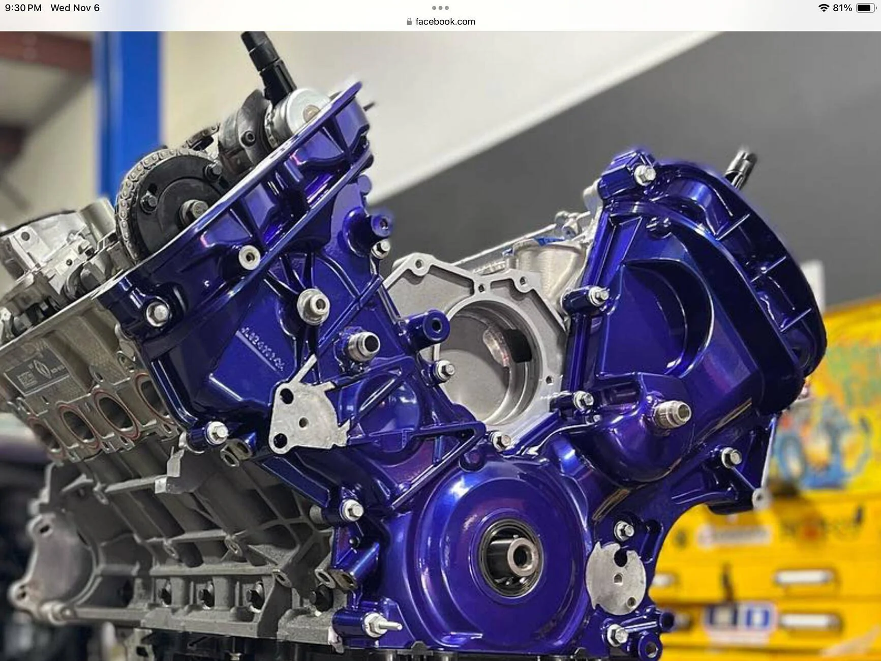

I found this example of what appears to be an F-150 Coyote timing cover with two -10AN drain fittings for a twin turbo setup.
