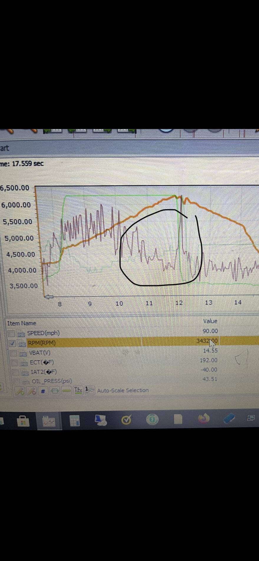

Just added a sai li fuel kit to my car did initial logs and logs show during the pull fuel pressure would drop from 60-35 mid pull. We checked both pumps for voltage. Verified both pumps were working. Put a manual gauge on the fuel line and it showed during the pull it never dropped below 59psi. Any thoughts on what’s going on?

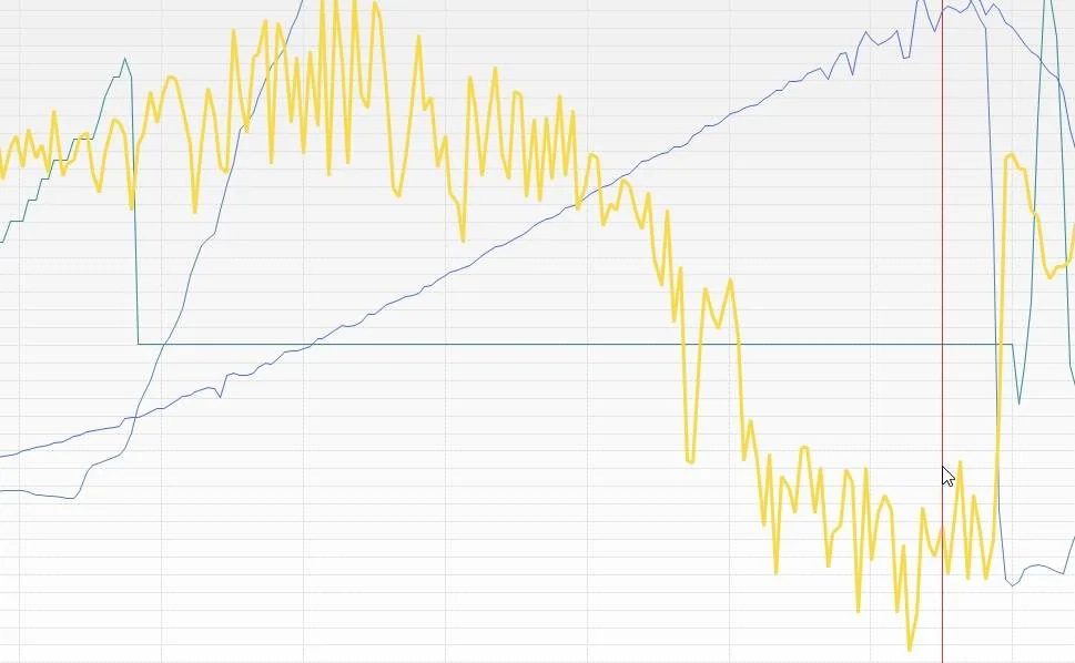

So it’s tune side issue? Added fuel pressure to show what I see on my log.

If it has full pressure and the gauge is showing a drop then there’s a tune problem. But verify 100% that you have full fuel pressure at the time that it is saying you don’t. Then tell your tuner
