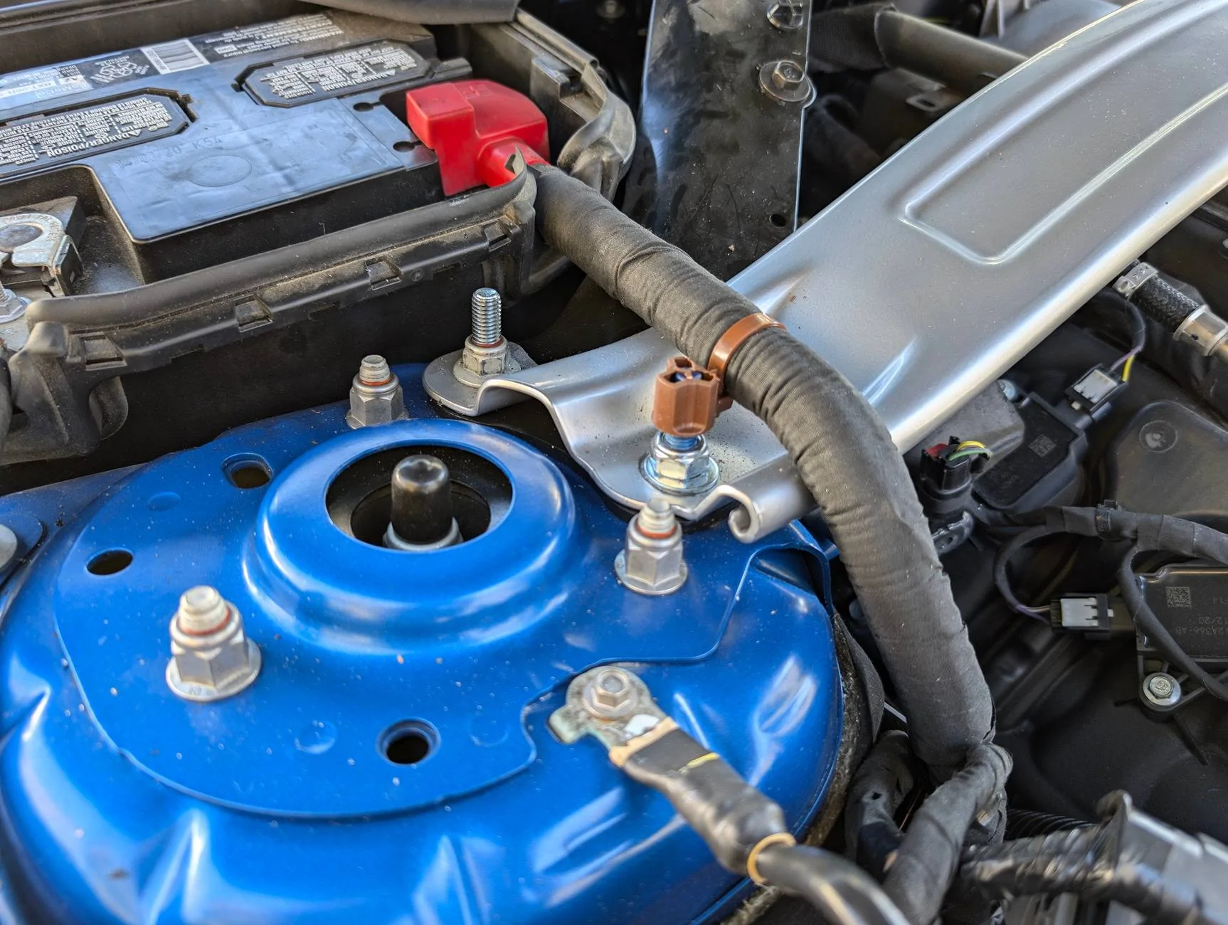

I've had my 2020 GT convertible for almost 2 months and realized i'd never actually seen the engine because of the stupid engine cover. THis evening I unbolted the brace bar, ripped out the cover, and then busted a stud re-attaching the brace bar. Probably read all the threads and posts about that- not sure if i should be happy that I'm not the first (or 1000th) person to do this, or pissed at Ford- but repair is likely beyond my expertise and/or desire.
What's the risk of sheering off the remaining stud on that side if I keep driving the car? I know the brace isn't critical to vehicle safety, but I don't want to cause more damage. Ideally I'd drive it for a few more months until I need an oil change to take it to a dealer (I get a few oil changes for free) and have them look at it. If they want to replace that entire top/cap piece (to which the stud is welded) then I'll look for an indy shop willing to do actual work.
I don't drive every day and can take a different vehicle if needed. Just want to know what to expect.
Also, is there a way to take the brace off without removing the positive battery cable? I'm hoping to get another 4 or 6 weeks with the car before the weather turns, and figure I could drive without the brace for a bit.

Yes.
The brace is just an added brace you’re good to go.
Are you a victim of the suspiciously high torque spec on those nuts? I just hit it with hand tight and a little shove with a 1/2 ratchet and call it lol.

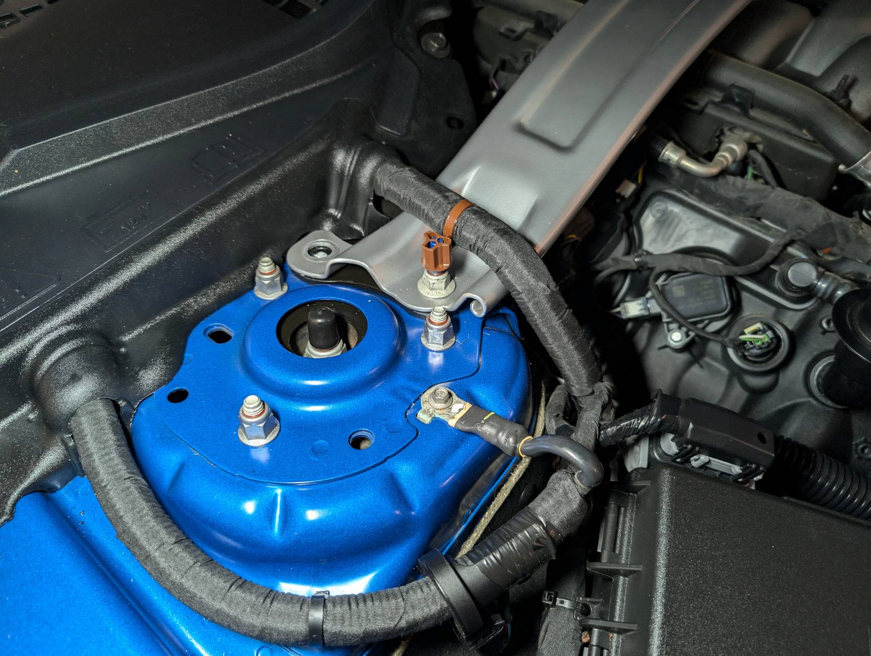

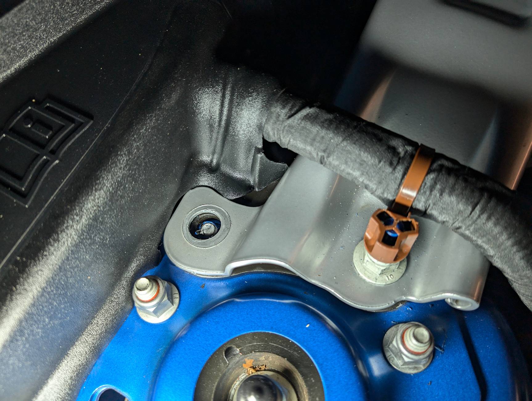

All good. Drilled out the stud, then threaded the hole so the replacement bolt won't fall out. Will no longer be torquing the nuts down and will be re-using the same lock nuts. hand tight is good enough. I don't understand why we care about that. The studs provide mostly lateral support anyway. and with how often the brace needs to be removed for general maintenance tasks- even once a year or 2- I won't be worried about them loosening up.

Totally Safe. The two studs are only for the Strut Tower brace. When You have time, replace the two studs with a Press in Studs, stronger ones.

Then use a Dremel cutoff disc or Gride it out from underneath and it wont take much to punch out. I wouldn't hammer hard with a 2lbs hammer that's for sure, to thin of metal in the strut tower rim.
