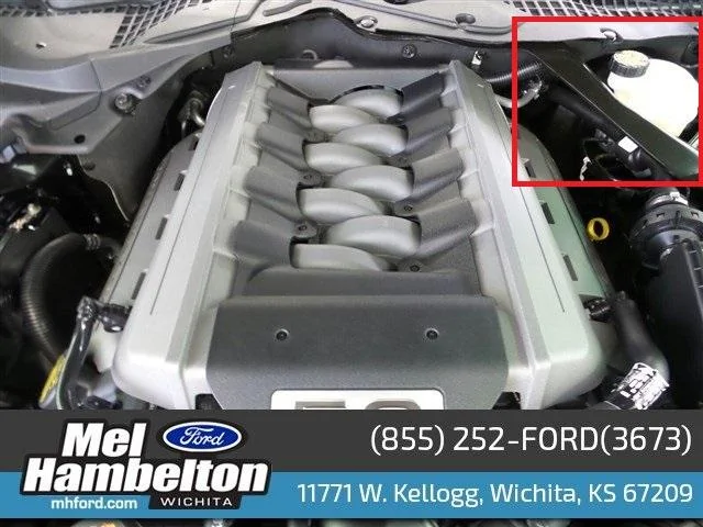

Has any one posted pictures of the "K" Brace?

The strut tower brace is only on Performance Pack models or convertibles. The firewall brace there was discussed a couple of weeks ago but I don't recall the answer.

The full black brace may be on your convertible, but I don't think the strut tower brace.
http://www.tascaparts.com/oe-ford/fr3z16a200a
That is the stock STB that comes on the PP GTs and the LE.

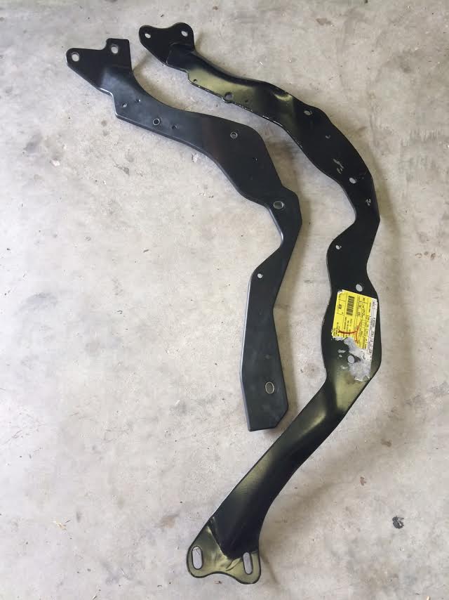

Performance Pack (GT and EcoBoost) cars get the black brace going back to the firewall.
Non-Performance Pack cars with 20" rims get that black brace.
Any other car gets the "half brace" which is plastic.
I just bought the stock Strut Tower Brace and the full black brace. Here is a comparison of the full black brace, and the "half brace".
The full black brace is shipped exactly like you see it... no packaging, so I'll have to paint it, since it got nicked up a bit.
By the way, the "half brace" is really just a support for the battery cover and the cowl (which is why I keep putting it in quotes, since it really isn't a brace at all). :)

Thanks for the info Super Trooper. Could you post the part number for the black brace that you show in picture. I'm getting the regular strut tower brace, but didn't know about the other one. I'm trying to get these parts before my car arrives. The build date is 12-22-14. Looking forward to a pix perhaps of both installed. Thanks again.

No problem! I will post pics in my journal, and start a thread on how to swap over the braces when I'm done.
Here is everything you need to order:
Strut Tower Brace - http://www.tascaparts.com/oe-ford/fr3z16a200a
Full Black Brace - http://www.tascaparts.com/oe-ford/fr3z16k038a
Two nuts - http://www.tascaparts.com/ford/f-150/w712334s442
