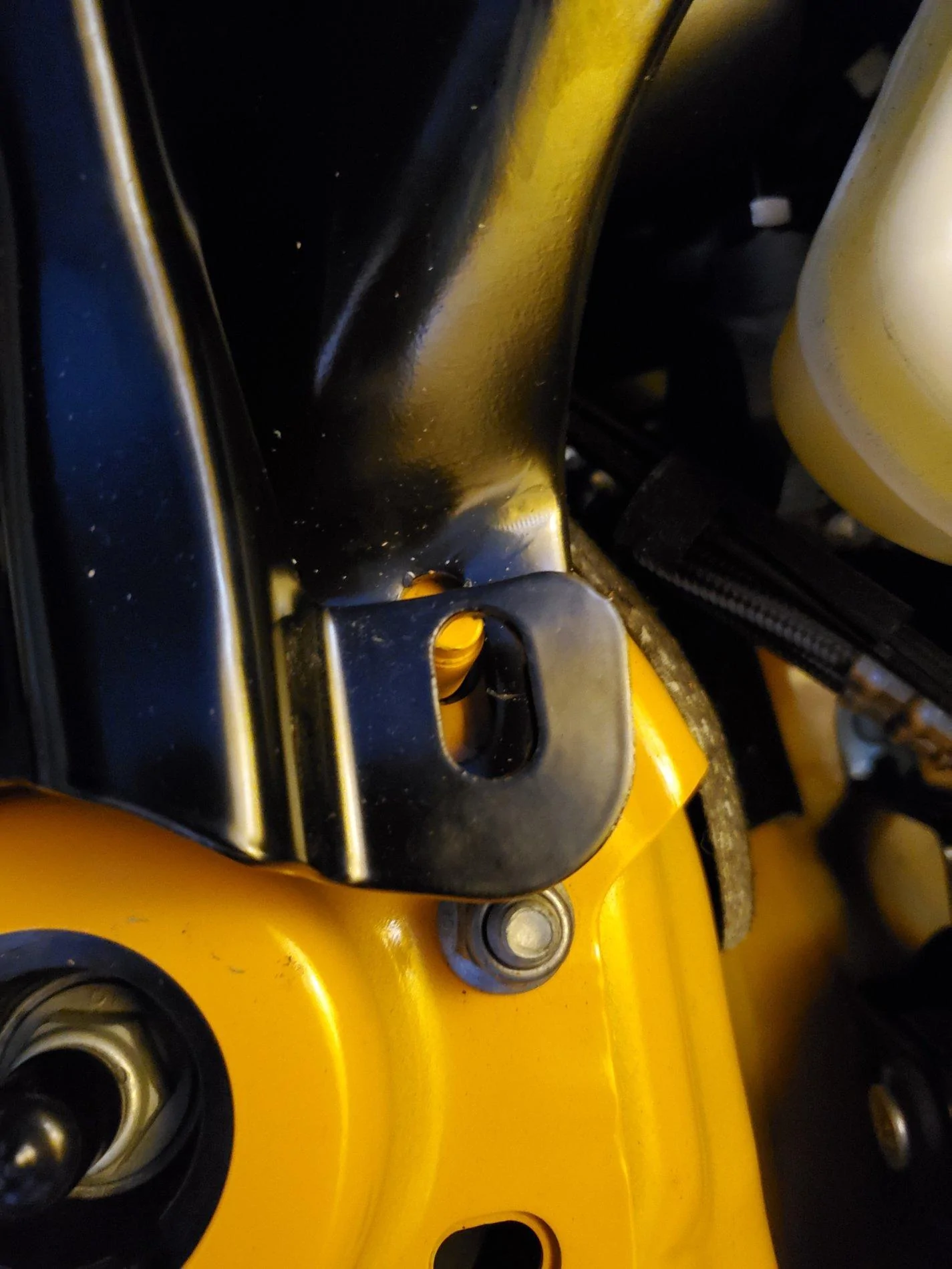

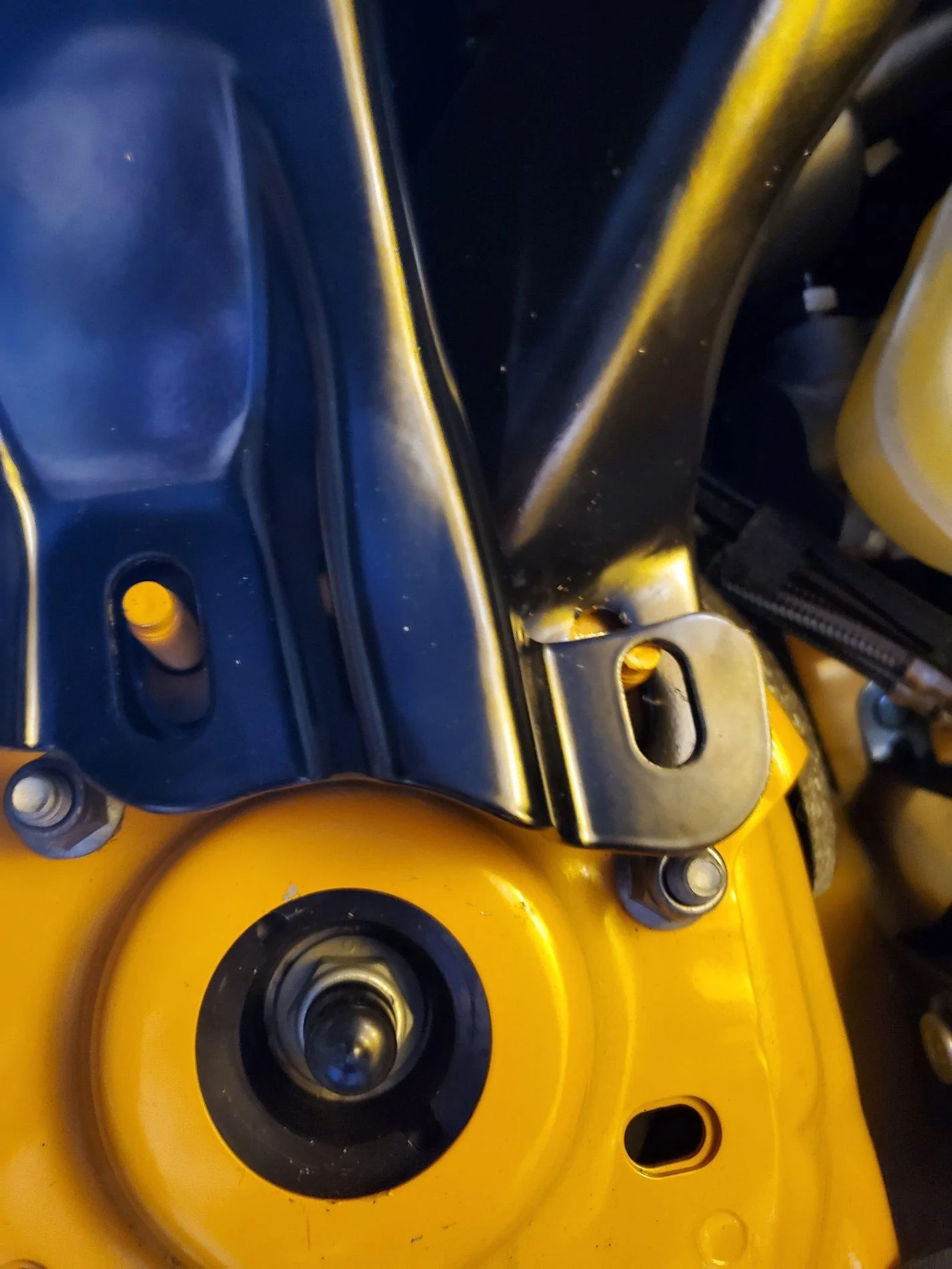

I bought a ford performance strut tower brace from LMR that included the cowl extension for my 2018 Mustang GT non-performance. I tried installing it and the cowl extension fits perfectly but doesn't matter what I try the tower brace won't align properly with the threads. Could it be a defective item or some issue with my vehicle?

Visually from the left side of the brace to the right side, is it flat?

Did you tighten down the opposite side first? Possibly.....if you did, just loosen the bolts and the other side should fit right into place. The holes are elongated, so you should have plently of play in it for fitment.

I had to maneuver mine around a bit for it to align. Like JohnboyNC said, don't tighten anything down until the end.

So I contacted LMR (amazing customer service) and they confirmed I had a defective unit that might had gotten bent in shipping or something. I will update you once I get the new strut bar and see!
