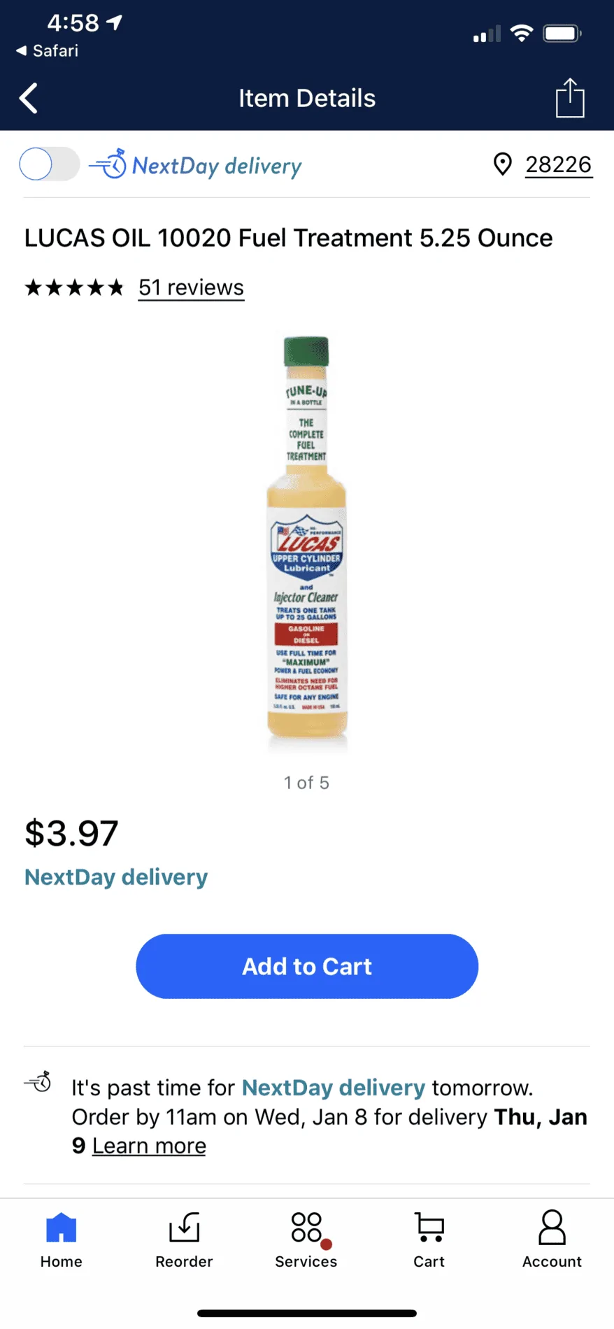

depending on miles, we usually recommend a tank every 6 weeks or so on a true dd to help clean the system up.
we normally run the lucas conditioner on a regular basis as well

it’s only a sunny day fun car.. I don’t know if should add the cleaner or whatever if it’s not a DD

I use Lucas as well as I'm gone for a month or two at a time.
