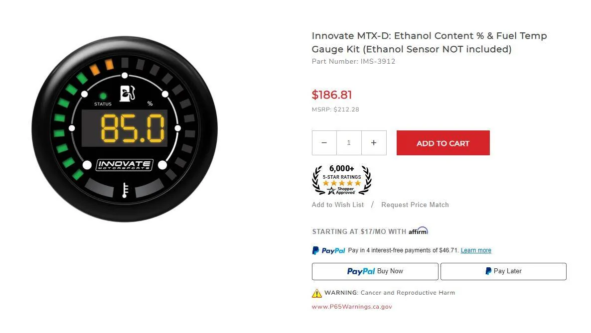

The most cookie cutter tuners such as Lung should be able to send you a request to create a data log to correct your lean issue. But; they need to know at what percentage range your ethanol actually is. I've never run a Flex Tune but that might alleviate rich/lean issues.
I wouldn't think a ethanol content analyser with sensor would be necessary for NA cars but they do give you the exact ethanol content at any given moment.
Good Luck
