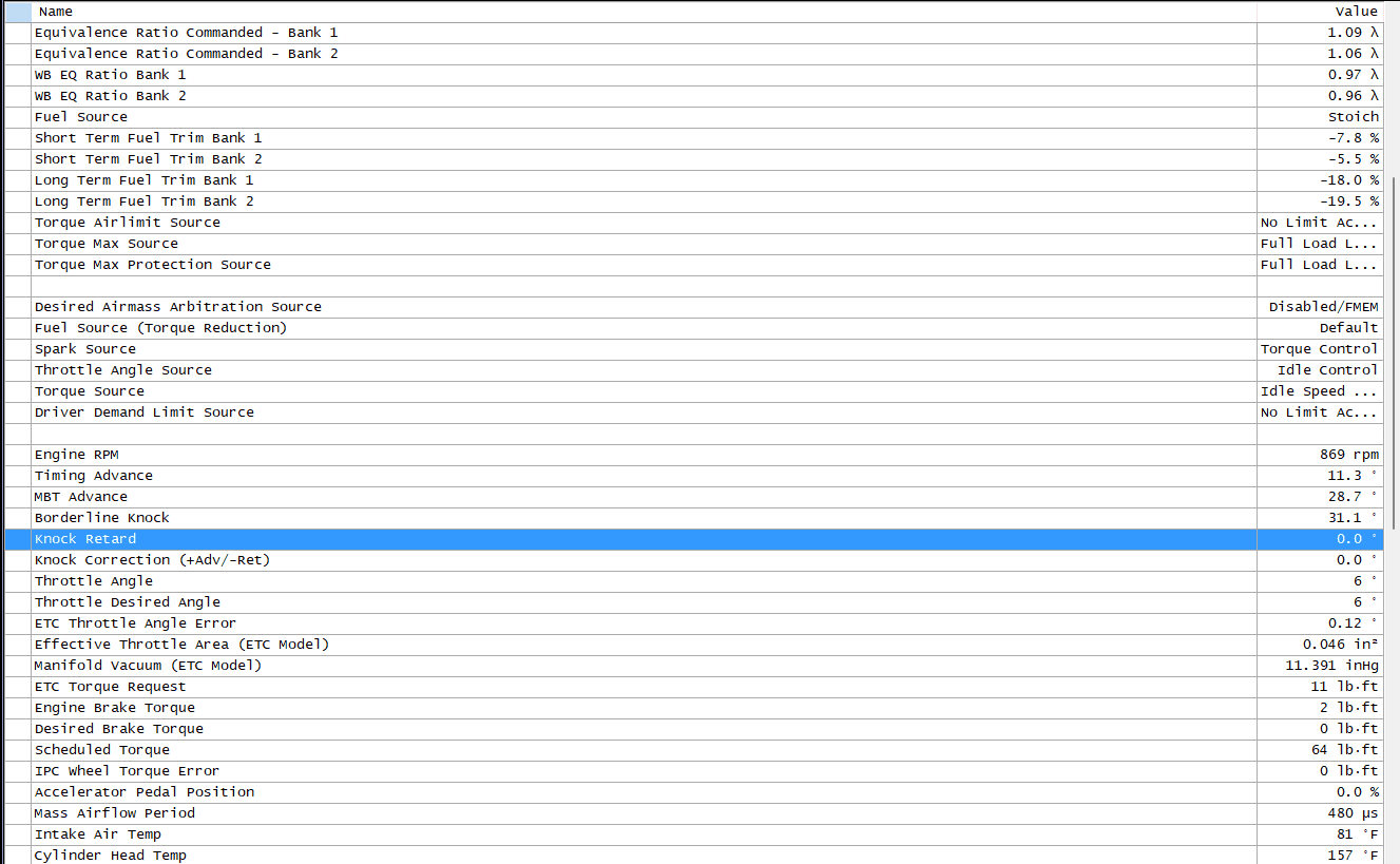

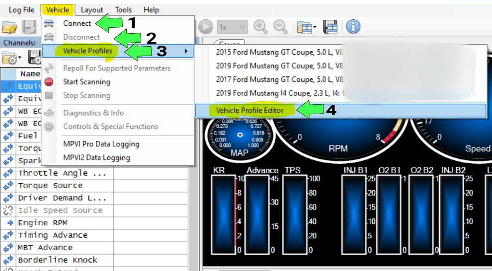

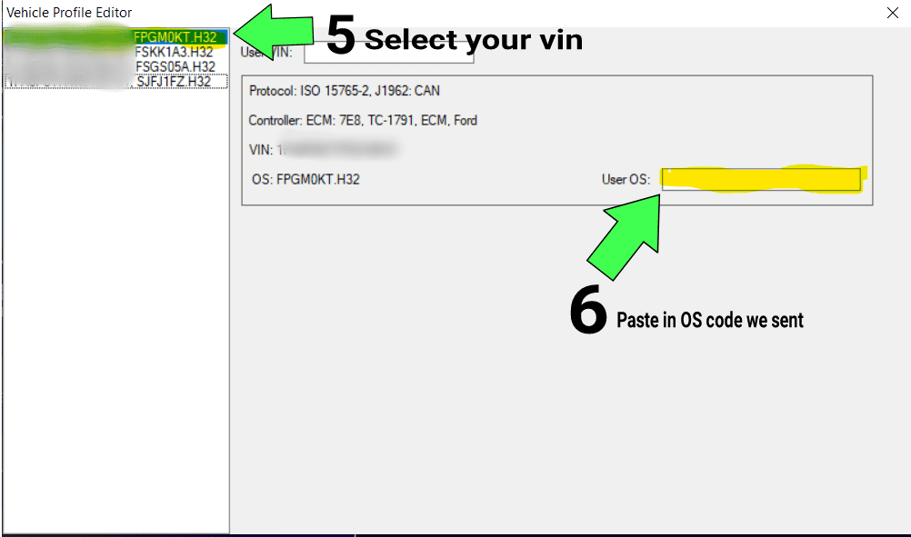

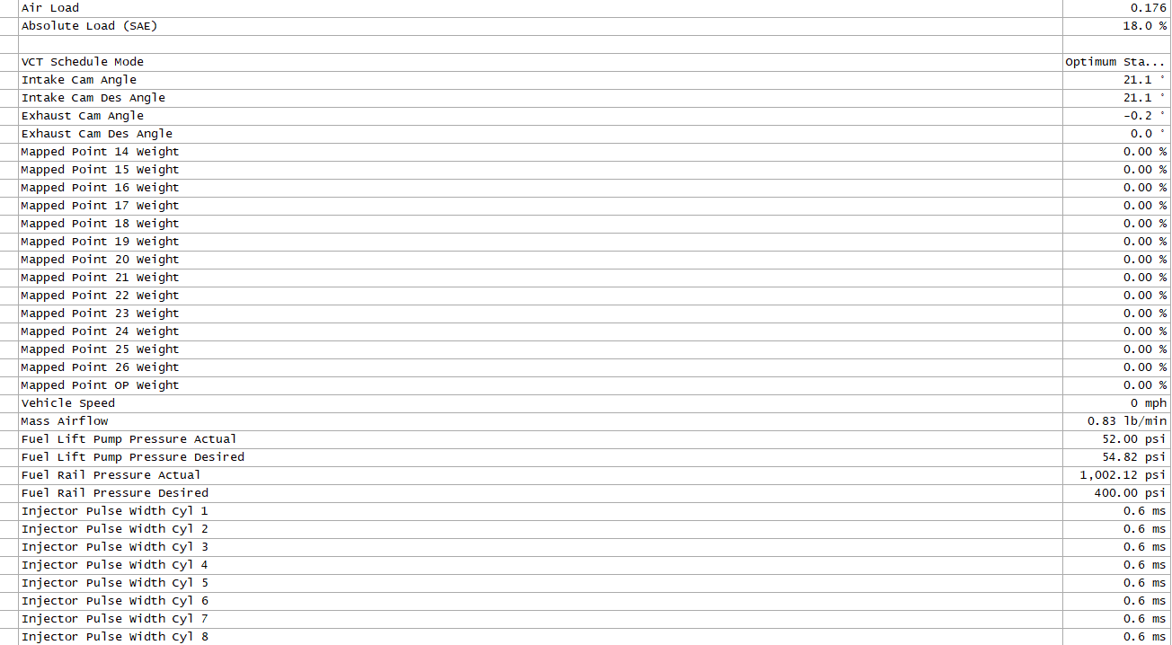

If you guys aren't using Wengerd, you're doing it wrong.
I had the same issue and wanted to be able to log myself as well as be able view and log all the parameters you would want to see. He sent me clear instructions on how to load his os file, and then his standard channel file (you have to use the beta version of VCM Scanner) Your tuner should have no problem setting this up for you. We cant upload .hpl files to this forum, but below is a snippet of a slow rev log so that you can see all the pids you would really ever need, are visible and logable (not sure if that is a word)
