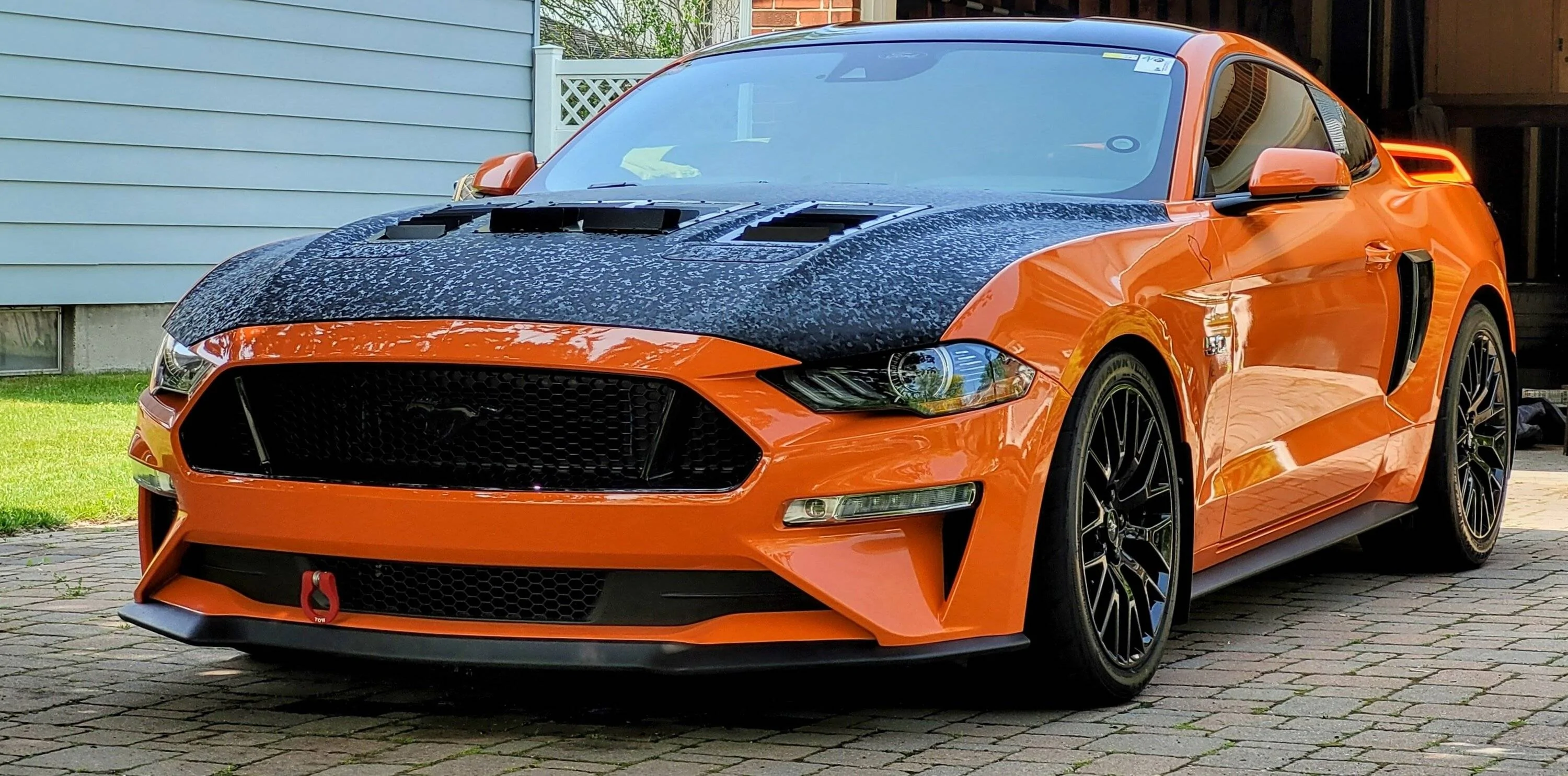

So if you go to extended studs for 305s, you're stuck with those studs sticking out in the front which will look weird when you go back to your street wheel and tire set.
TBH, that is not true. Here are the stock PP1 front 255 wheels over 25mm spacer with extended ARP studs and stock size Gorilla lug nuts with -2.7 camber. In my opinion, they fit much better than barebone stock in this setup. Even better, now I can also fit rear PP1 275 wheels up front also sitting flush, so technically I can do a square street setup by getting couple rear PP1 wheels for very cheap. I never remove spacers.

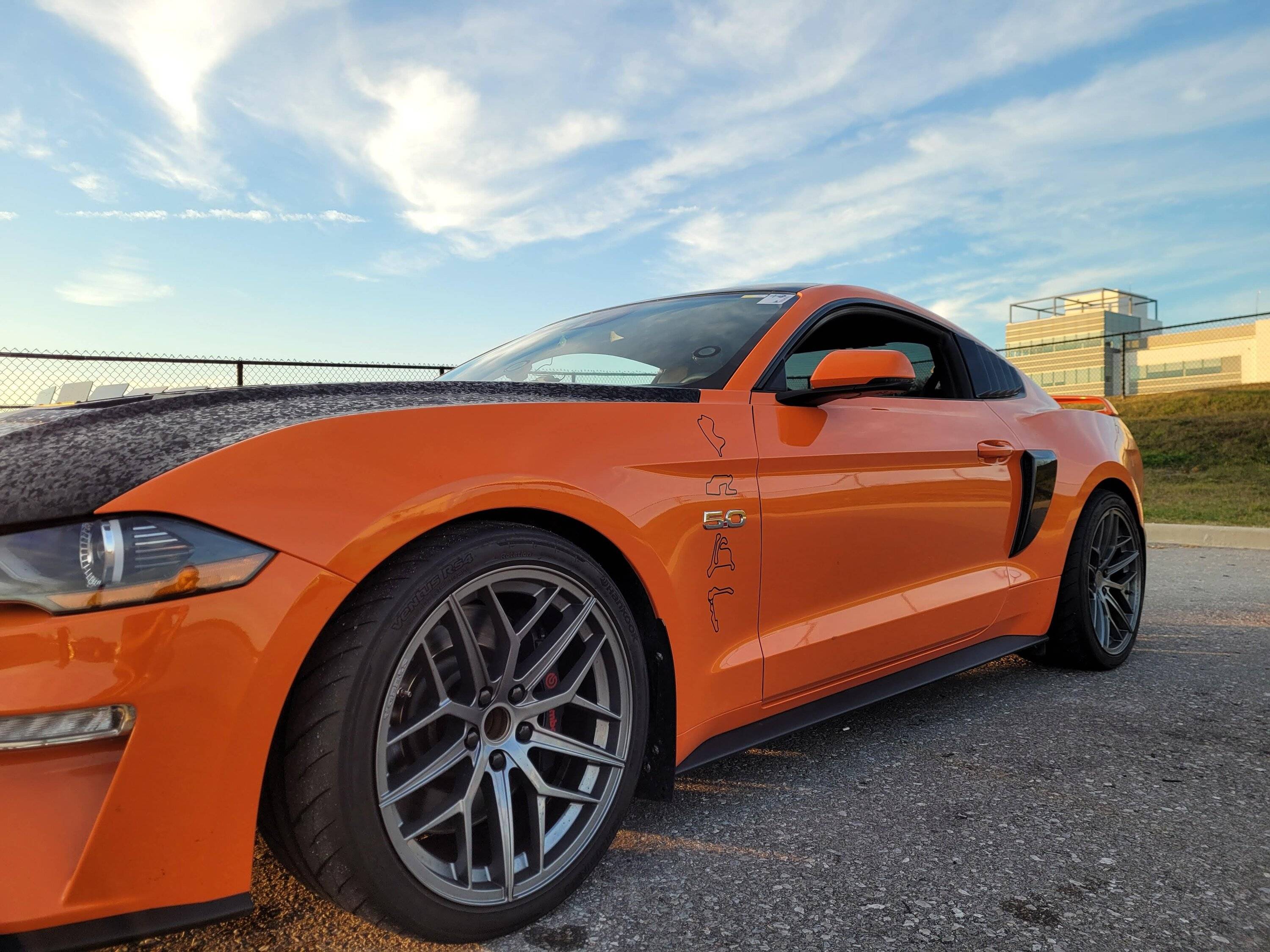

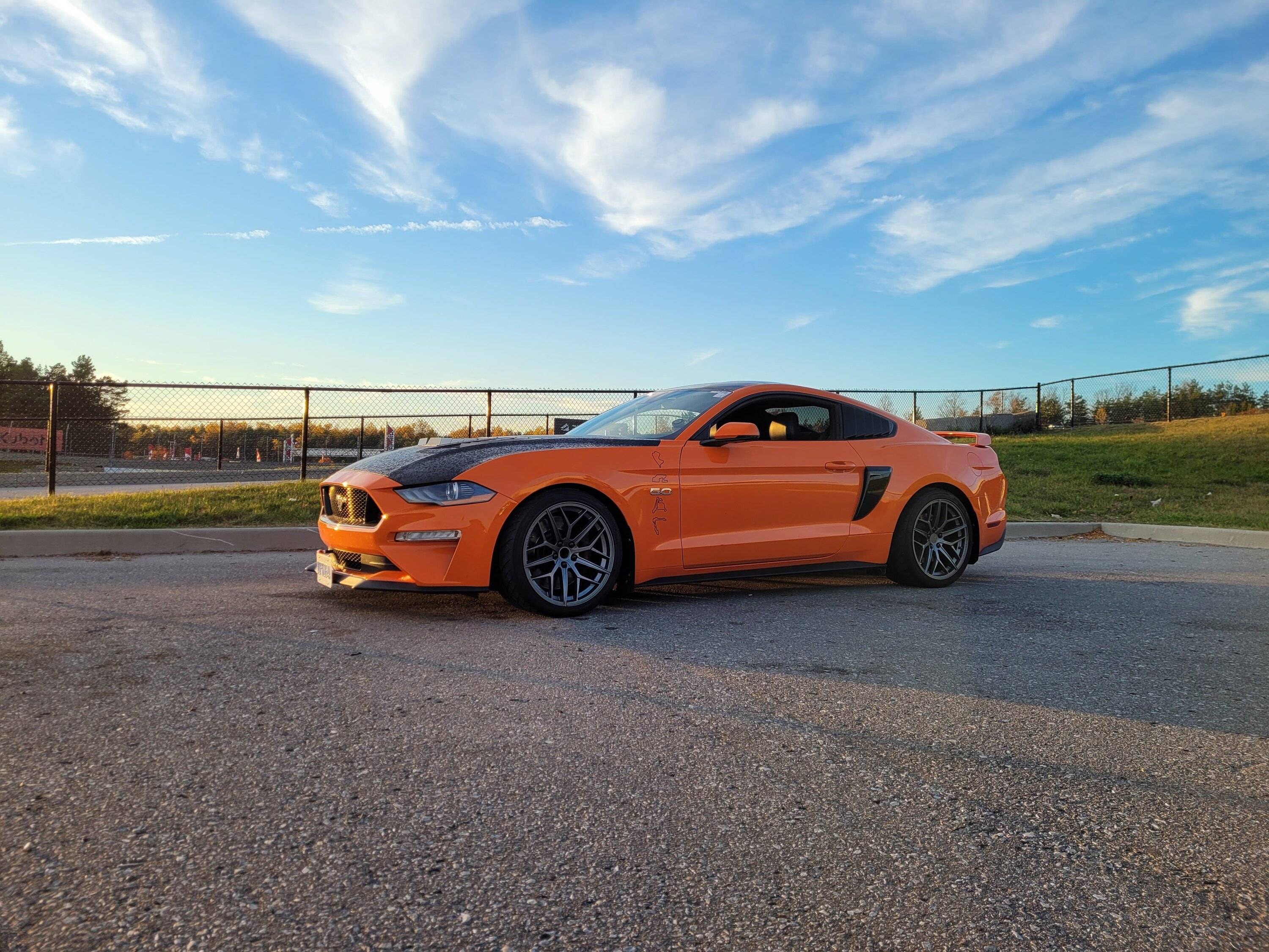

Any fitment issues you think I'll run into?
And here are Steeda 11 wheels with 52 or 53 offset, 305/30/19 tires and 25mm spacers up front. Hope it will give you a good idea.

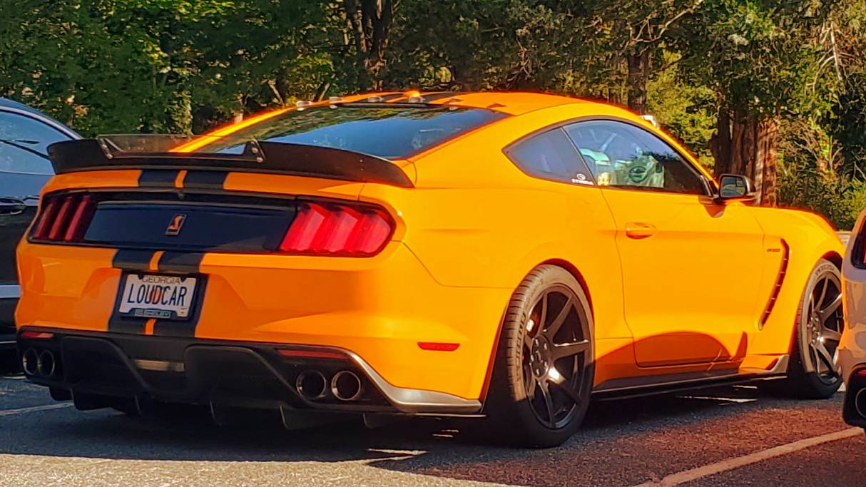

Yeah true. After track days I do switch back to just my street wheels and tires (Forgestar CF10 20s & Nitto tires), so was thinking the fronts may look odd if I move to extended studs much like you're talking about. I mayyy just go with 275 all around for this year then reassess...
extended studs on most front wheels look fine depending on the wheel. My Project6GR Sevens have super deep lug holes up front anyway.
Not the best photo, but you can just barely see the studs on the front more than the rears on my street wheels.
On the race wheels (19x11 square rotatable setup with 305's) you can't see them at all.
