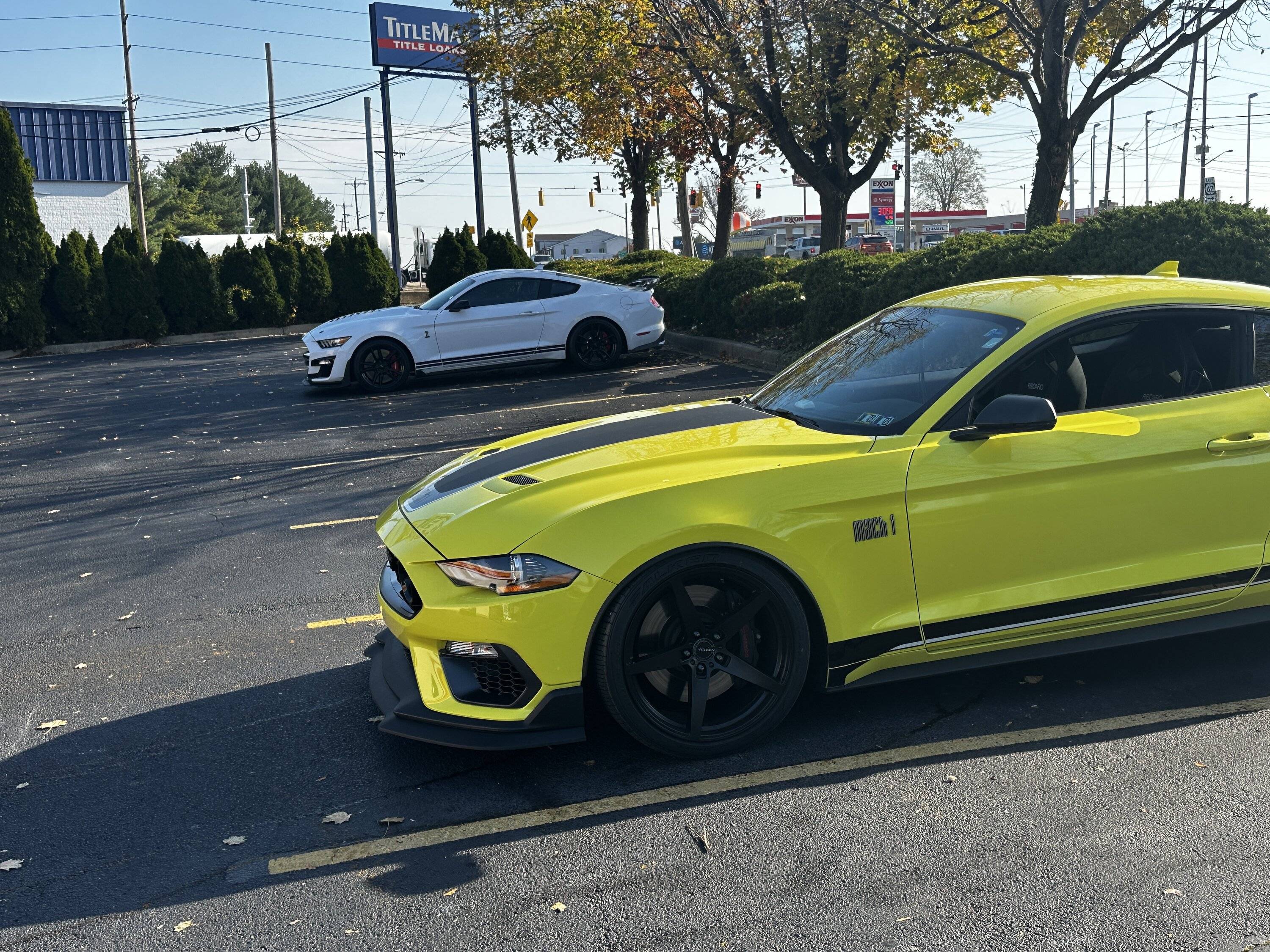

I personally don’t think the studs look weird. Also this is 305/30/20. I’d say get the studs/spacer and go that route. I started with 285 square on 20 x 10 and now I’m on 20 x 11 with 305 square and the 20 x 10’s will be listed here shortly lol

For further information, you will rub a little bit with 305/30/20 on dual rate magneride springs, even with -2.9 camber up front. I’m installing Steeda’s front ride height adjustment kit to give me the .5” back in the front to alleviate it. Which also means I’d be able to use 305/35/19 tires instead of 305/30/19 tires for the summer. Just wanted to put this out there just incase anyone wanted to have a good spring like the dual rates but wanted the height the same upfront due to tire clearance or splitter clearance!
