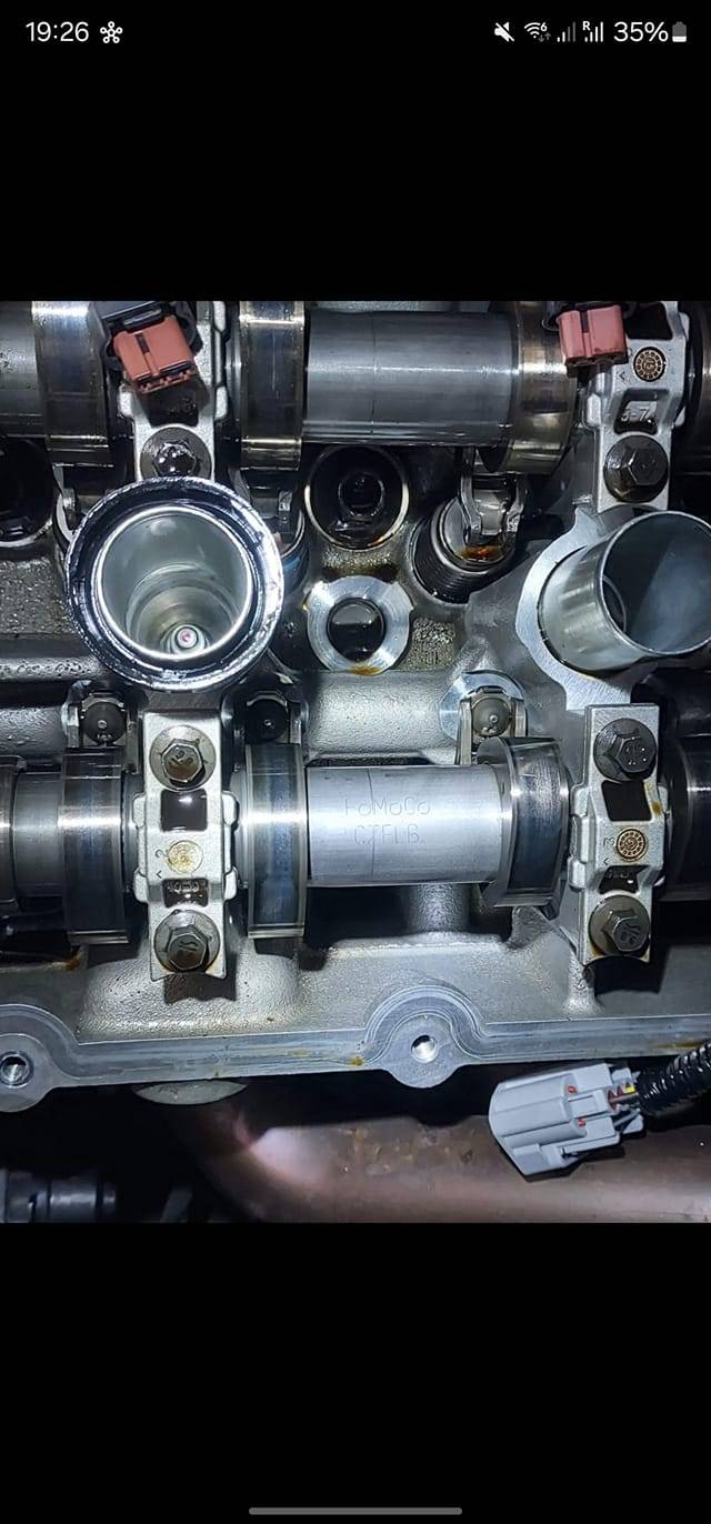

When the SC was installed approx 2 yrs 15k miles ago, the shop warned me my cams were showing signs of wear. A pic is attached.
This was flagged as a to-do item for 'future attention'.

I'd be more focused on resolving why the lobes are wearing.
As others pointed out, aftermarket cams may not really net anything and may make whatever problems you're seeing worse.
I get your idea, if youre going to have to replace them anyway, why not spend money on better stuff. I'd try to source OEM replacements if you're not upgrading the rest of the rotating components (springs, retainers, etc).
Did you get debris in the heads or something? Have you been looking at your oil to check for debris or metal components? Sometimes the little keepers come off.
