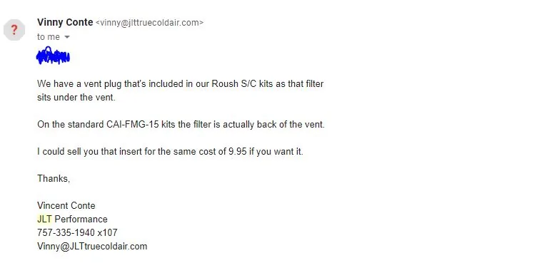

That is interesting, I thought the foam insert came when you buy the JLT intake? Is there a different one? I almost threw mine away thinking it was some sort of packing material.
This one right? click me

No, special order. See attached. Just a piece of foam.

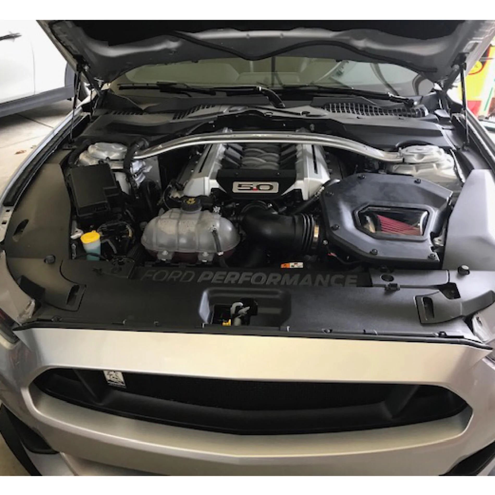

Received the cover lid earlier this week but wanted to run the car without it to see what the IAT’s were. Without the lid the IAT was 4-6 above ambient while I was moving. After a hard run and at a complete stop it was as high as 129 with and ambient of 59. I installed the lid which fits perfectly but haven’t driven it yet. I did start it and any difference regarding intake noise is negligible. I could barely hear it when the air box was open and the hood closed. With the lid on, even less. The air/fuel ratio is the same which is a good thing. Wasn’t sure if there would be any difference after sealing it. I’ve already started the St Patrick’s Day celebrating so I’ll drive it again and see what the IAT is but I suspect, as noted above, it will be similar to the OEM air box.
