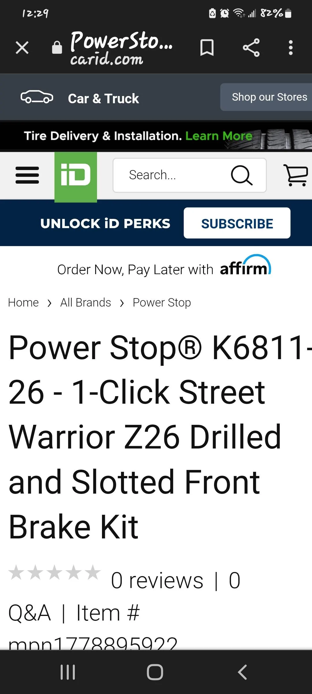

I'm going to replace the front rotors on my 2017 PP. Lot of choices out there. Any suggestions would be appreciated. I'm having the calipers powder coated and will rebuild them so figured why not some slotted rotors.

Here's some I found that have good reviews.
kz
Oct 26, 2014
4,607
2,932
West Chester, OH
Mustangs & F150
There was a discussion about it elsewhere recently. Drilled rotors crack but if you're buying for looks it doesn't really matter what you buy.
For "performance", if you're not tracking your car, stock rotors are just as good as everything else, except there are few slightly lighter options.
Would never buy Powerstop, especially something that's names "Street Warrior"

I guess we'll find out.

Thanks for the reply. My car is strictly street. I show the car locally and am having my Brembos powder coated. I have a friend who has a Mustang he occasionally tracks and he's been running these rotors for a a while with no problems. He changes pads for track days. I won't have this completed for a couple of months but I'll let everyone know how it goes.
