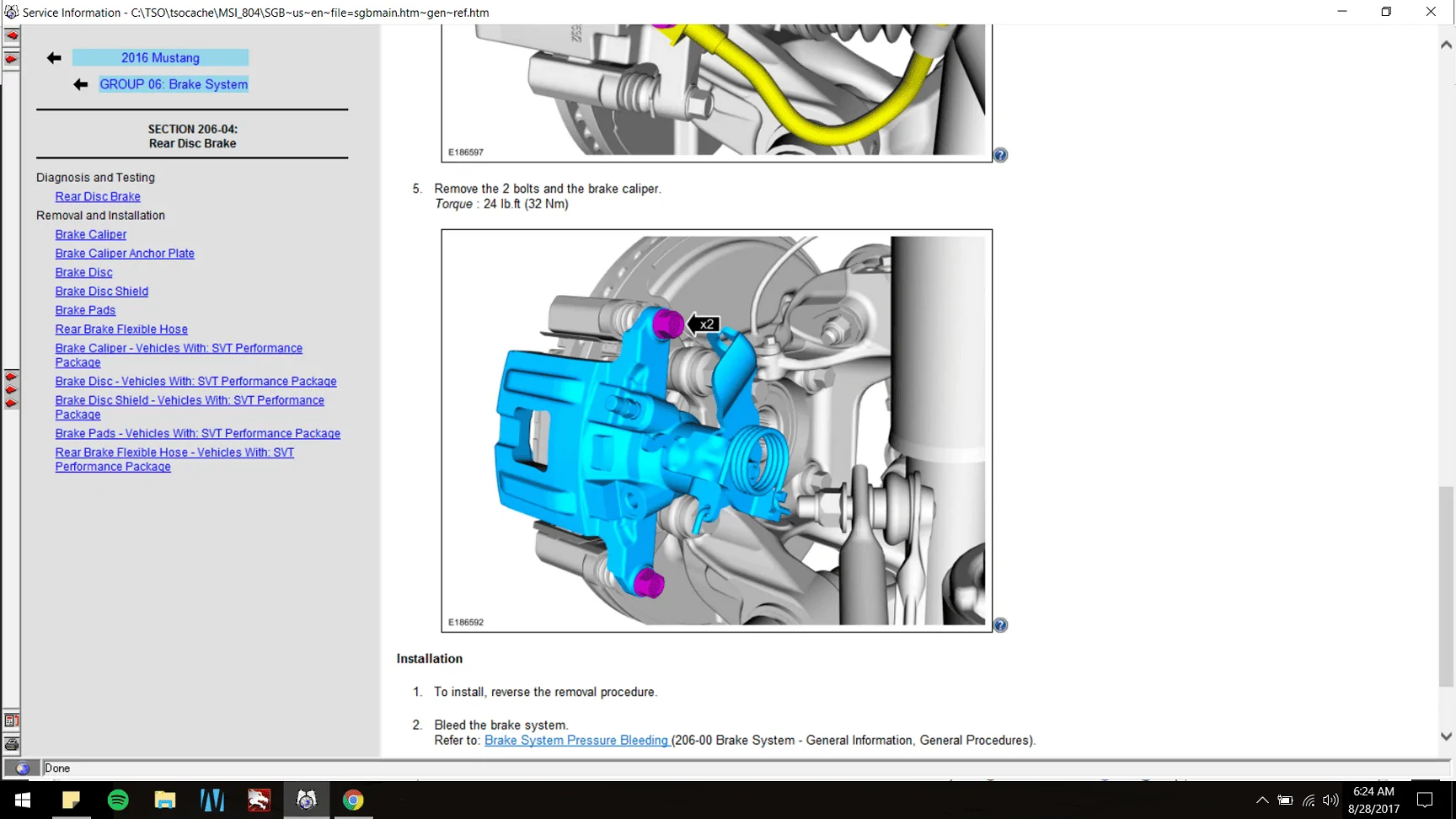

What I meant was that it doesn't make sense that the PP and non PP caliper torque is different. The caliper is the same other than the finish.
Yeah, it looks like maybe there's some mix up in the caliper vs. bracket vs. non-PP vs. PP.
I totally blew off starting this today - drank lots of beer, wrote some code, finished up Ray Donovan S4, played XBox with the little G :D
... so maybe we can get the right values confirmed in the next few days.

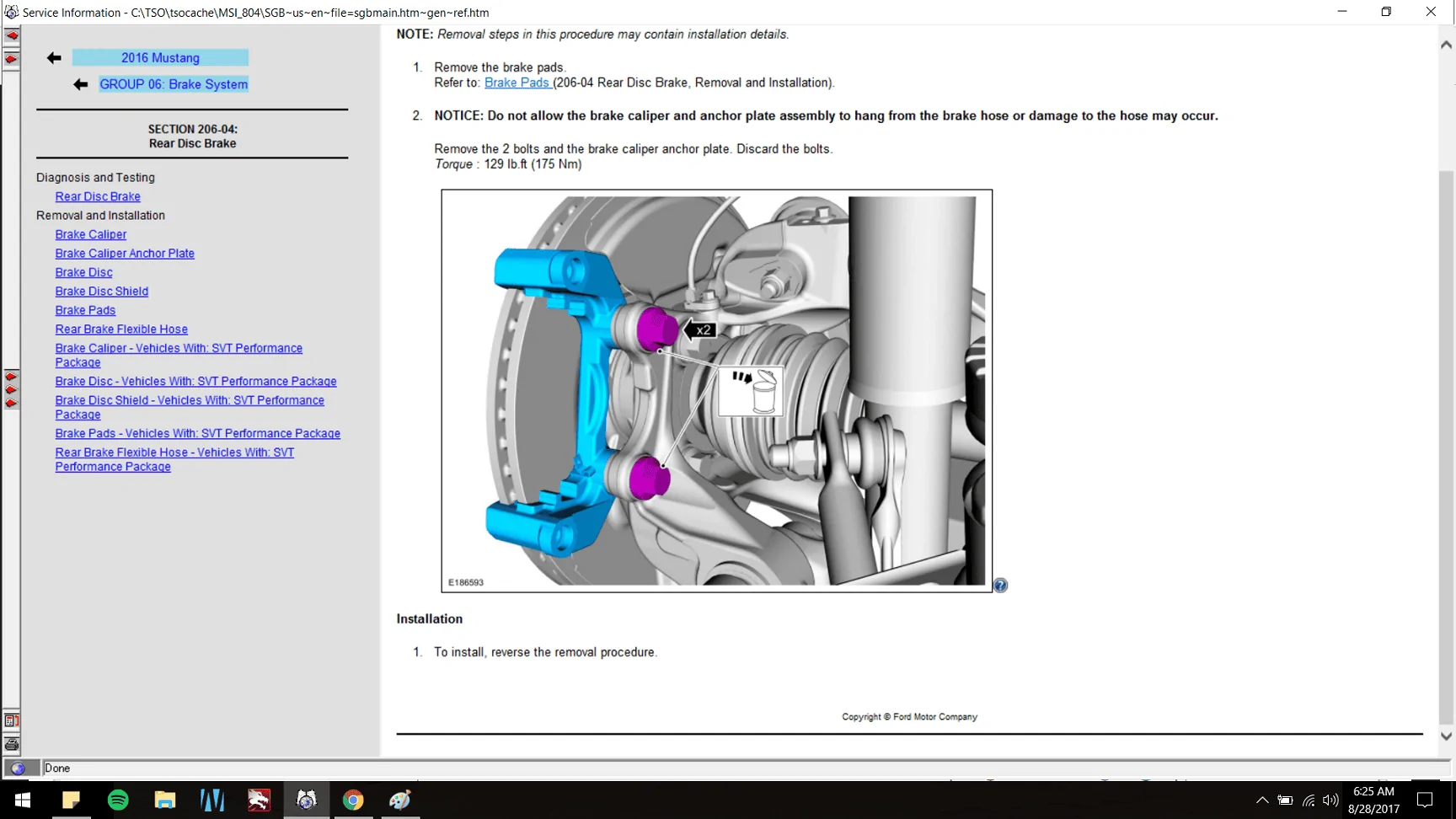

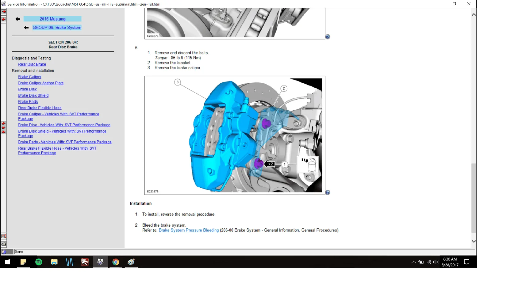

It lists them differently as with performance pack and standard. It might be for the GT350 and R. Either way, here's the screen shots from the manual
That last shot is of the GT350/R rear calipers. First two are for everything else. All GTs have the same rears.
Got it. I only zoned in on the Performance Pack of the index lol

OK, so to clarify, on the rear:
- Caliper [to bracket] bolts are 24lb/ft
- Bracket bolts are 129 lb/ft
I'm about to jack up one of the rear corners, can you reach the bracket bolts without having to remove the caliper (from the bracket)?
I guess I'll have my own answer in about 5 minutes :D
You can physically poke them with your finger but I don't think you can remove the whole thing at one lol. And yes, after reviewing everything, those are the right specs lol
