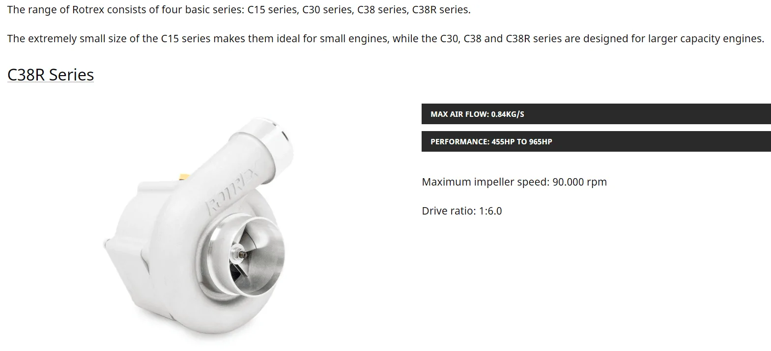

Could it be that even the largest :
Is 'borderline' for the numbers that most people seem to be chasing with forced induction ?
820 ish at the wheel and that's with it maxed out and no room for future.
I know 820 in the real world is a lot, but is it enough to interest the after market tuners for them to push its use and develop it ?
I know nothing of boosting cars, just trying to think of it from a tuners 'publicity' perspective - YouTube hits wont be great at 'only' 820 ...

If this manufacturer had a unit that would make big power, it may never come to light for many reasons. Availability of materials, R&D, profitability of the project and many other reasons posted above. The popular centri blowers are similar for many reasons. It's an uphill battle to topple what is proven from many aspects. Performance, manufacturing, reliability etc.
Pushing this type of blower to the front is like trying to bring your own gym shoe to market. It's possible but it will be a hard road to hoe.
