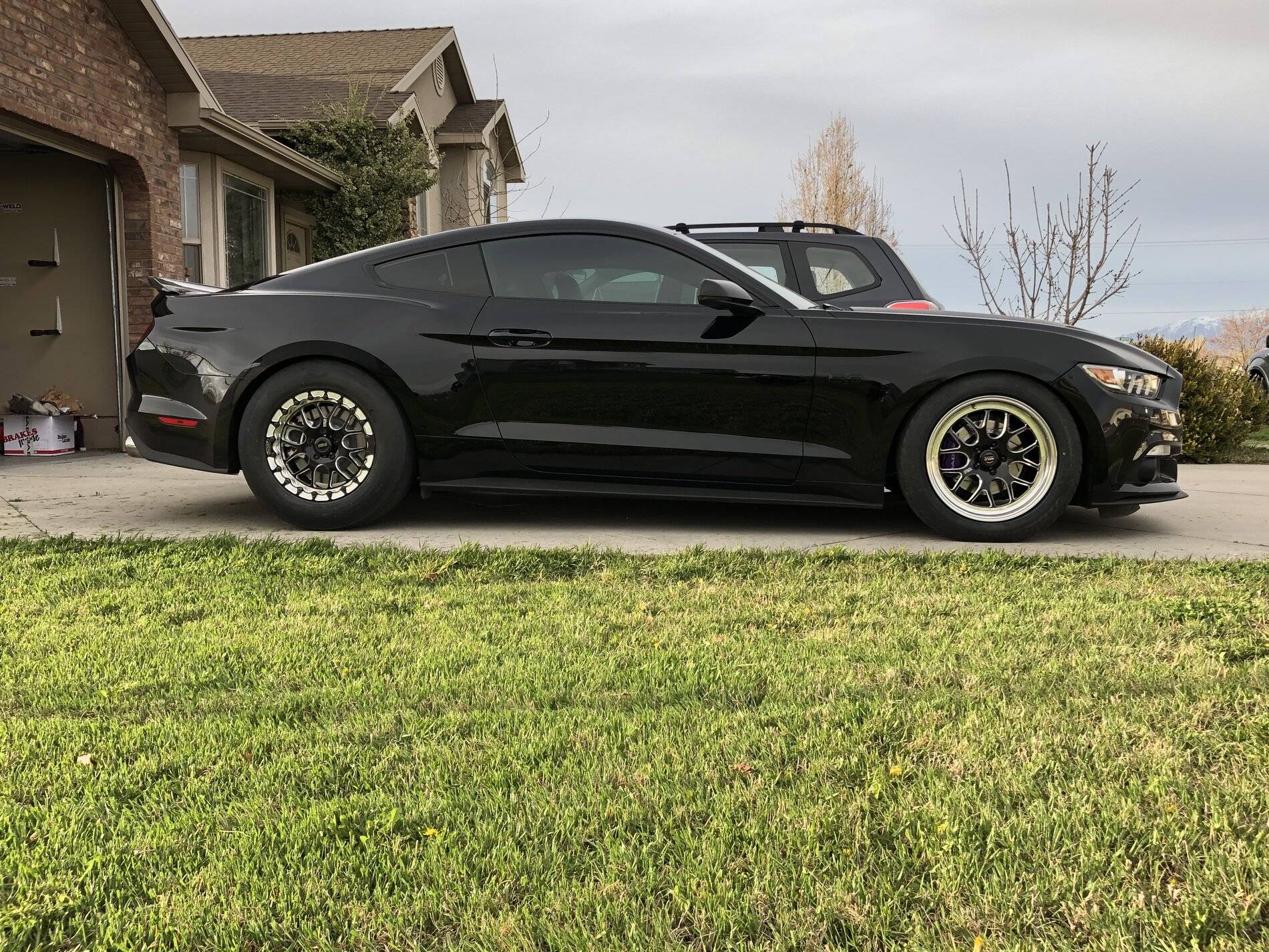

When going boosted, especially at that power, you’ll want to upgrade some things.
axles - due to the sloppy IRS the stock axles are prone to breaking as they take a lot of shock when on a manual car
IRS - You’ll want to upgrade the components in there such as a cradle lockout, differential bushings, vertical links, toe links
Clutch - This depends on how you drive in my opinion. My stock clutch was fine after a year of 700+ hp abuse but i waned to set myself up for success. Do with an RXT or our LPX (grip like an RXT but easier on the trans)
Fuel - Depending on the fuel you plan on running will really determine the components you need. If planning on running e85 you’ll need a full fuel system and bigger injectors such as ID1050x, bigger fuel pumps like Walbro 465s. If you’re on pump gas you can get away with a BAP but be weary of it at higher boost.
Tires - Depending on if you’re going to go to the track you’ll want a drag pack with bias ply tires to help absorb the shock. On the street i would go with a pilot sport for a regular tire and a Mickey Thompson SS for a drag radial. Also wider wheels will help you out. I ran 19x11 on my 17 with 325 MT tires and i hooked ont he street with over 800hp.
