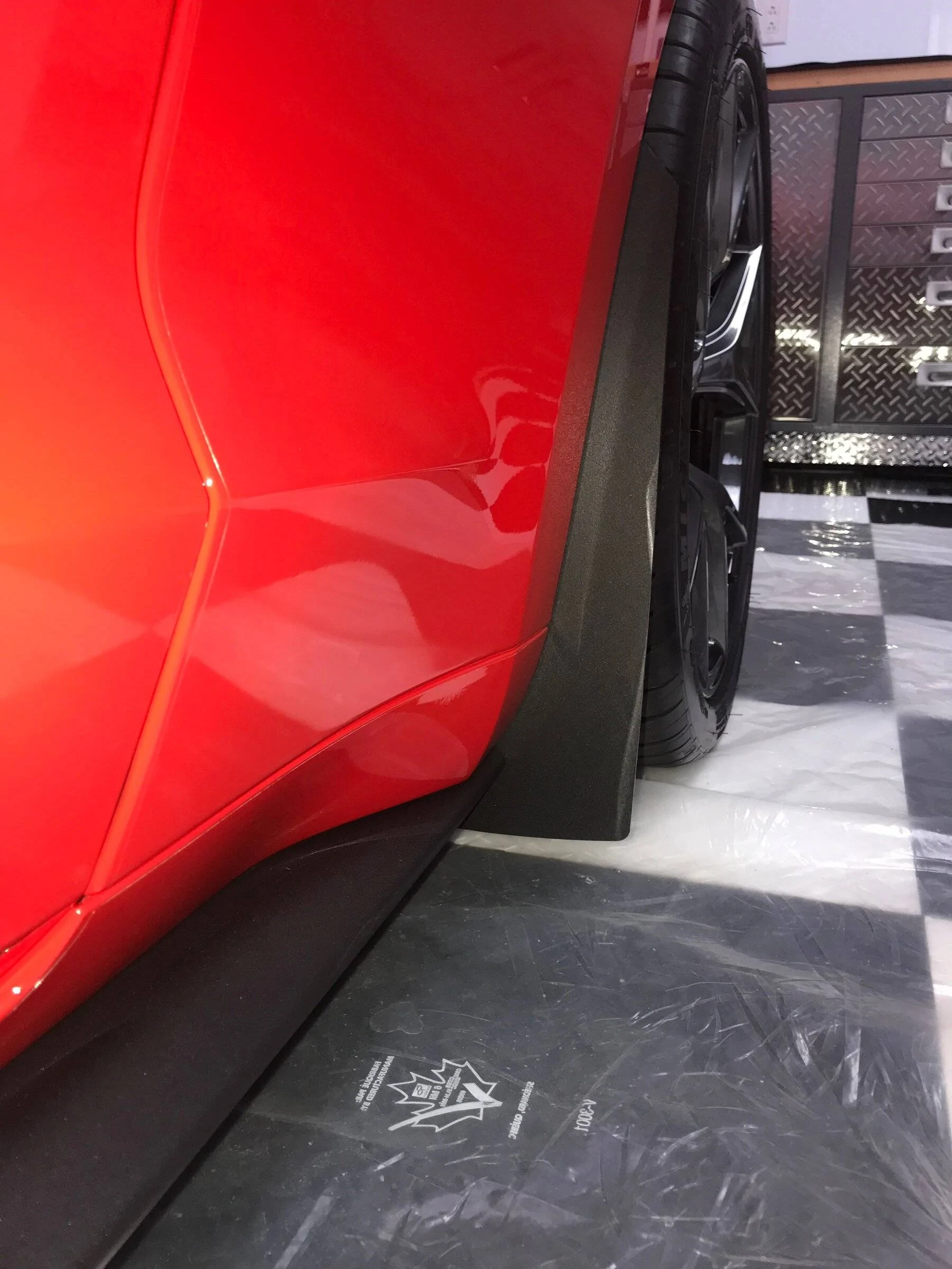

StangTime
Apr 16, 2019
3,514
3,937
Ontario 🇨🇦
19' GT PP1 Manual
Just an FYI. 9400km (5800miles) and not a single rock chip that I can tell anywhere down the sides or rear. Installed Rokblokz shortly after taking ownership. Money well spent. If you run spacers or run wider tires than stock, results may vary.

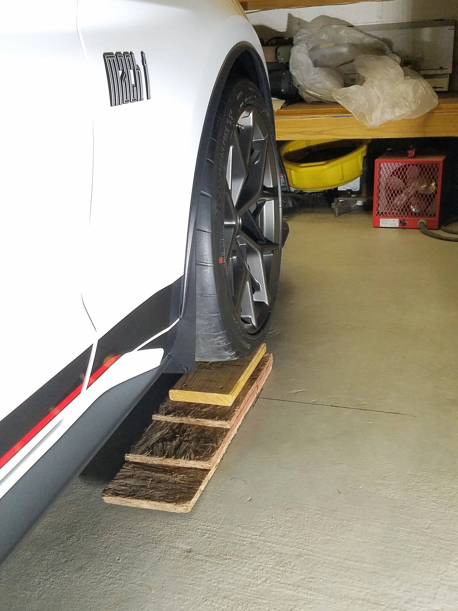

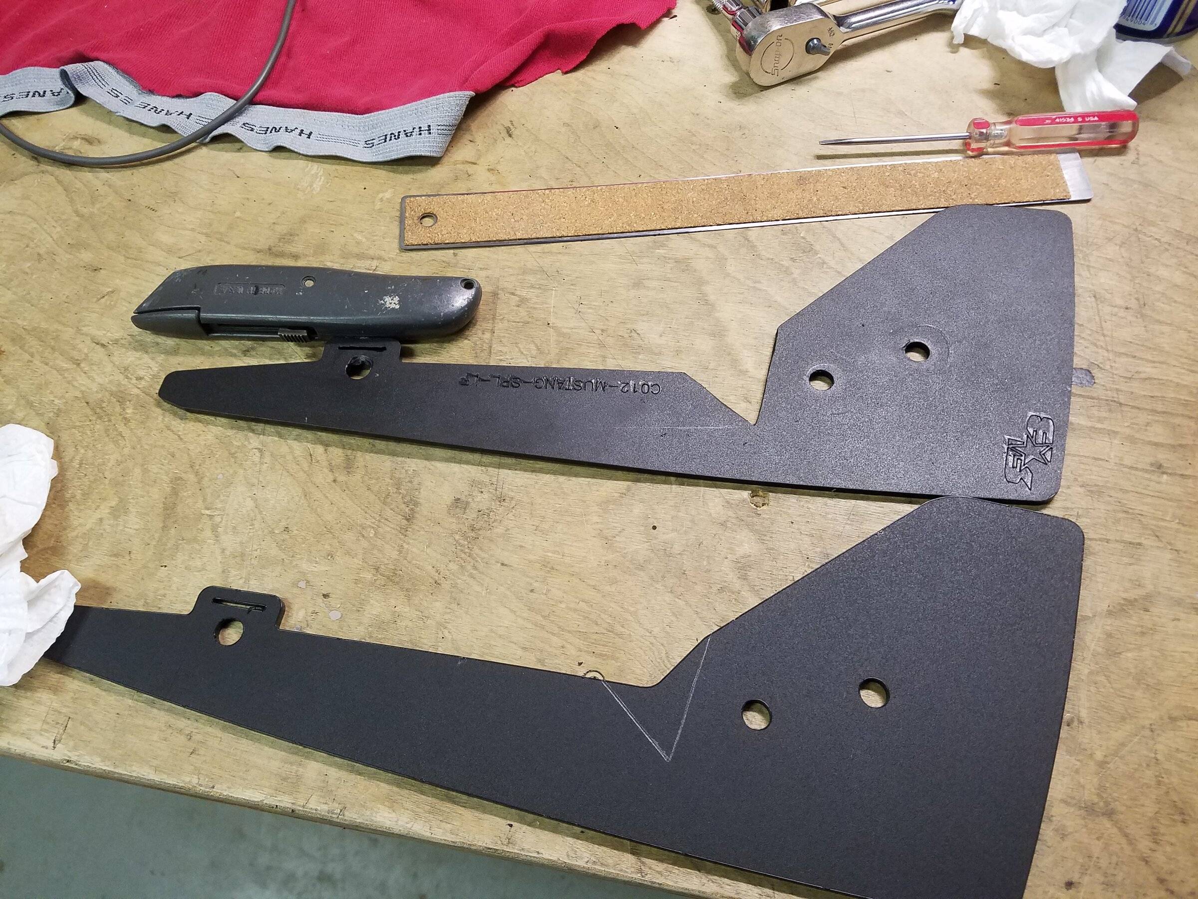

I have "regular GT" flaps and a mach 1 HP car. I had similar opinions as the guy that recommended drilling holes to mount. I slept on it to make sure that was what I wanted to do to a brand new handling pack car....
I ended up treating the fronts as if I were trying to fit up some sheet metal vs mounting a mud flap. With that said, I simply mocked them up, marked the interference location, and sectioned the area where the factory wheel well lip liner was, to allow the rock block flap to flex and follow the contour of the fender well, without drilling, without modifying the factory lip/guard in any way. I also pre-bent and twisted the flap at and above the sectioned area before install - just like you'd do with a brand new baseball cap before you put it on your head. Anyway, after 4 hours of fiddling around with different install options for such a silly accessory, this ended up working out great. Very happy with the results. No more blasting my rockers with every pebble in the road.
