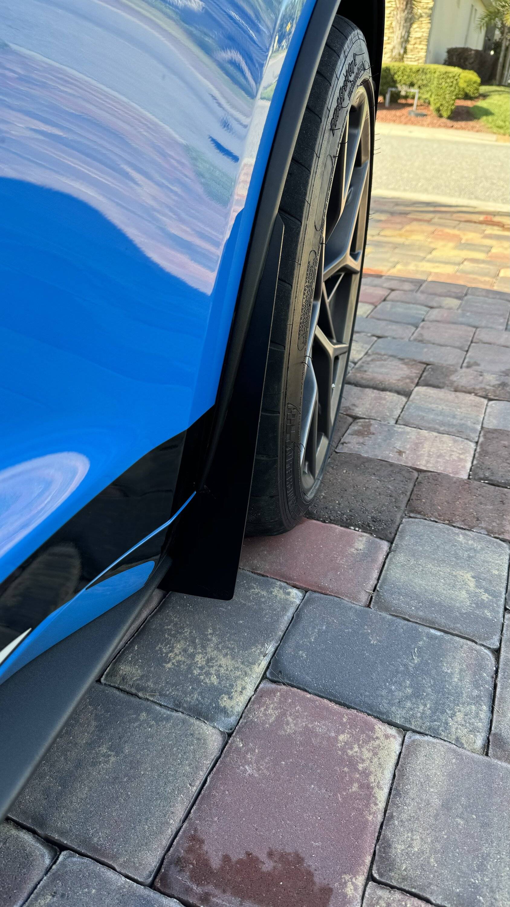

I needed to do something with all the darn rocks the front tires pick up.

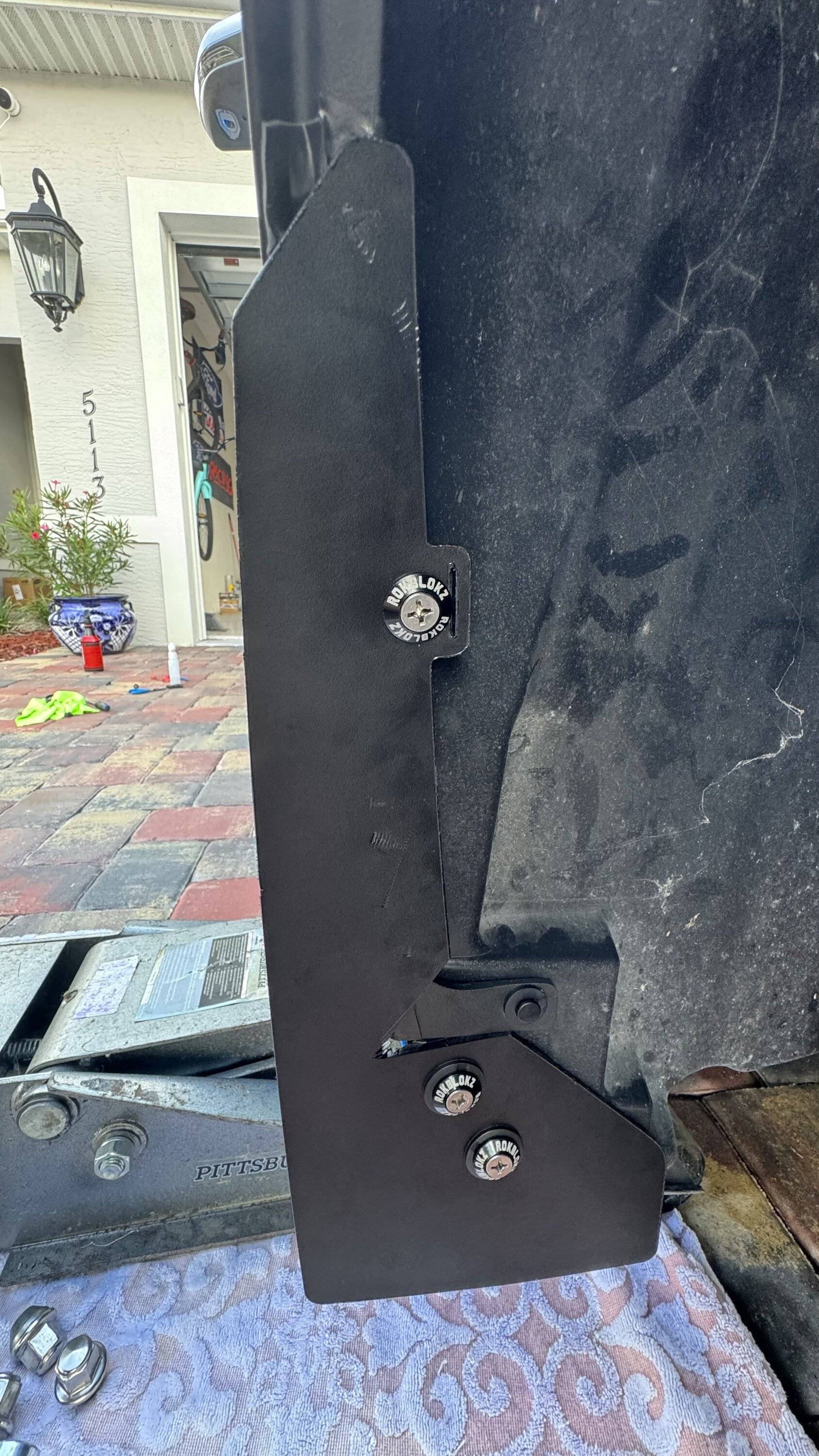

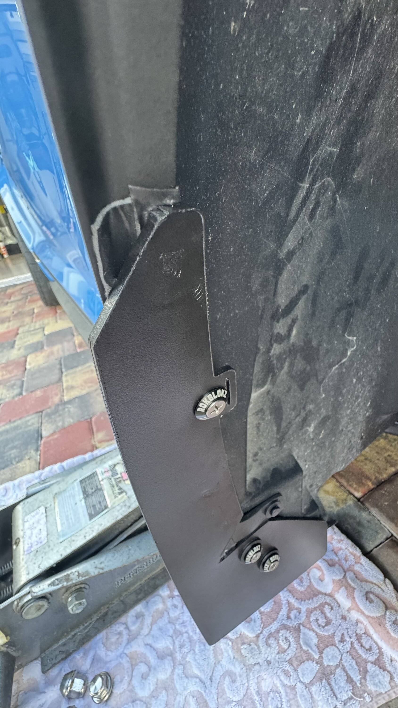

went with a set of Rokbloks PP2 flap for a GT. They won’t fit with the Mach 1 HP front flare without some fitting.
need to cut a triangle piece out of the flap to clear the lower attachment of the HP flare.
the top hardware of the rocbloks
Is a friction fit. I didn’t feel the confident as again the HP wheel flare cause some fitting issue.
I used some QUALITY 3M trim tape with 3M adhesion promoter. It’s on very tight now.
I may revisit the lower side of the the flap as the hardware seems to be in tight but I need to check after some driving.
