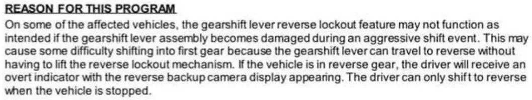

I am confused as to the severity of the issue. My interpretation of the service message is that IF the shifter gets damaged, then reverse lockout may stop functioning. Is it implying that there is some kind of deficiency in the shifter that increases the chances of damage? Or just that if it gets damaged (somehow) that reverse lockout stops working?
From what I understand there was a faulty part installed in the effected shifter mechanisms. It will eventually fail and cause the shifter to go into reverse without pulling up on the lock out collar. It also makes the shifter feel weird and wonky!
Ford very carefully selected the words they chose.
The use of the word "may" creates some level of uncertainty or ambiguity. And to say "if the assembly becomes damaged during an aggressive shift event" are they talking about permanent damage or something that can intermittently cause a problem? They aren't saying what they know to be true, as it would take up a few pages for a clear and concise explanation as to why this has and can happen.

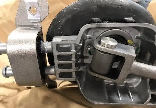

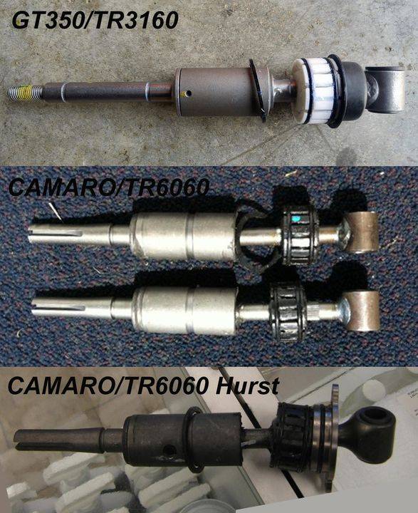

In my experience, Ford hasn't changed the assembly throughout. I tore down a brand new unit direct from Ford and could see deficiencies not just in the hardware itself but the overall design. I've gone into lengthy detail in threads here at 6G in the past so this program from Ford comes as no surprise. The squeaky wheel gets the grease here so the range is fairly small and that is obviously what Ford would prefer. If and when they have to, the MY's affected could grow based on complaints. See the link I posted above.
In nutshell, Ford mimicked the design GM was using on their TR6060 equipped Camaro's. It's a single arm, pendulum actuated, plastic ball and race, economy shifter. It degrades with use and Ford felt that it would normally be out of warranty by the time things got too sloppy. Hence the verbage in the recall, where they are signaling that they recognize that shifts that "may be higher in force than normal" can cause an issue.

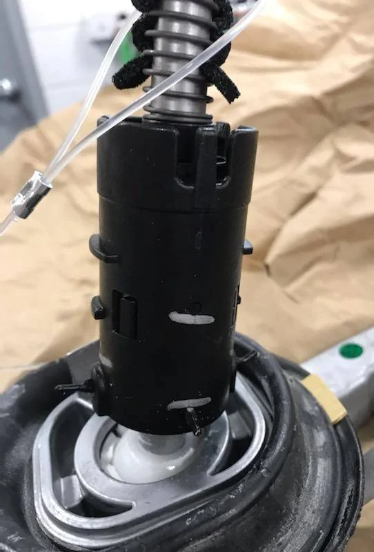

The issue in this case is the poor reverse lockout collar design. The design is rooted in cost (as low as possible), the fact that it is lightweight, and easy to manufacture/assemble. The collar is molded and is used to prevent the user from accidentally shifting into reverse. The problem is the collar tab deflects, and the body of the collar binds on the shaft it rides on. When you add that along with the rest of the deflection in the system (the linkage rod) you may find that gear selection can become difficult or at times, impossible. Here's George from MGW showing how fairly modest pressure on the shifter can result in an issue.
You can also have an issue with the lockout collar sticking/binding such that it gets stuck when raised, allowing you to move the arm over to the reverse gate when that wasn't what you wanted to do. This video shows a brand new shifter (service part for a 2016 on a brand new TR3160 on a stand).

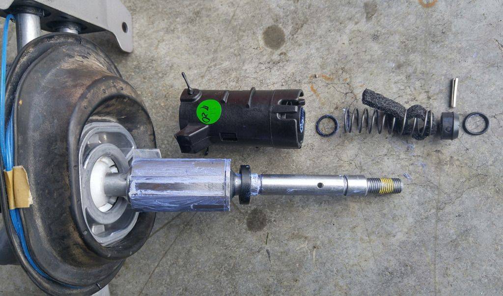

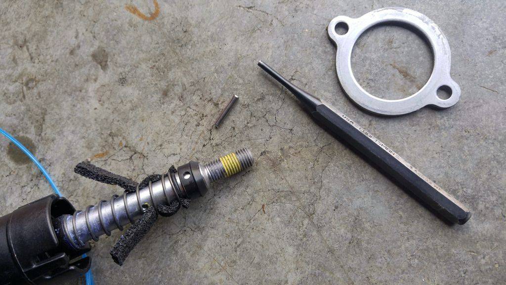

Some here have also complained about vibrating or noise from the shifter under use. Ford chose to jam a small piece of foam between the collar spring and the vertical rod it slides on. Here's a new unit I disassembled that depicts what I'm talking about.
Look closely and you'll see some grease to lubricate the shaft and collar. As the thin film gets scraped away with use the collar becomes more likely to stick when pulled up as the spring can't overcome the friction that keeps it there. Ford could have used a higher tension spring to partially mitigate this but apparently some in their focus groups keep their pinky high in the air when they drink their latte and wouldn't stand for it. The foam can make things worse, at least before it tears off and is no longer in place.

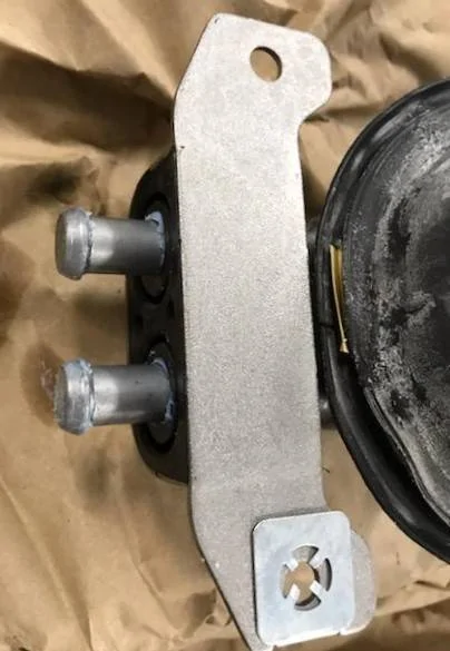

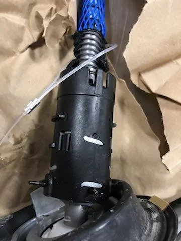

I've seen the shifter Ford is sending to dealers for the recall but not had the opportunity to break it down, measure it, and compare it to earlier units. This is it.
"Majority" of the content made in the USA. QC stickers show handwriting not in English, so my guess is assembly is taking place elsewhere at this point as well as the manufacture of some of the components. I'd assume that Ford had the supplier make slight changes to the plastic lockout collar, the spring, and that's it. My assessment hasn't changed. The GT350 has a great engine and suspension. The TR3160 is a great transmission. But the shifter is low budget trash and no match for the rest of the car. Ford could have used an improved design (still pendulum) at a reasonable cost increase that would prove to be more robust both under aggressive use as well as with long term durability. I had hoped for a single axis (bolt-action style) design when the car was announced but it's clear where they felt they could save money and this is the result.
