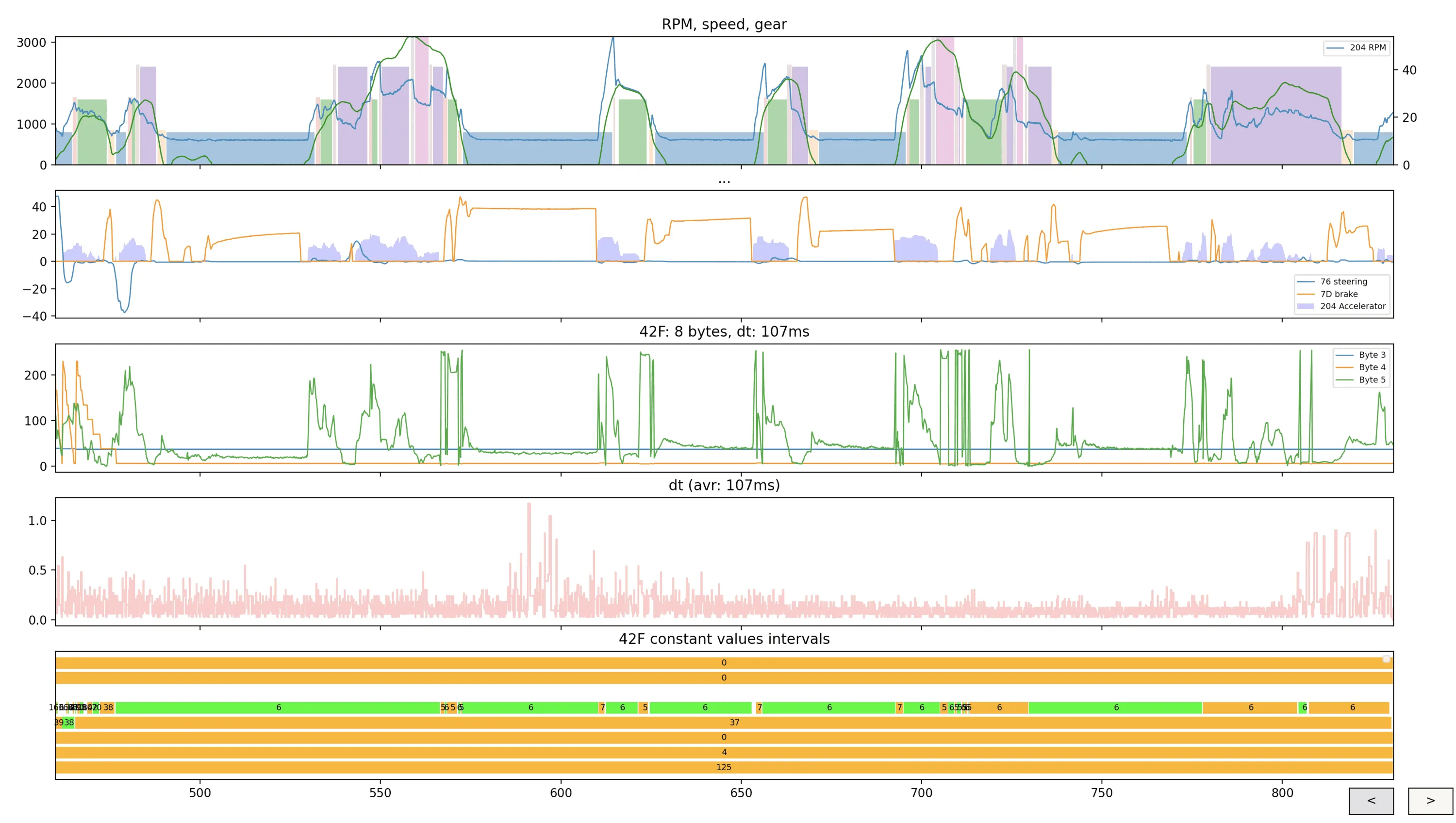

I'm digging into HS1 and HS3 CAN bus traffic in my Mustang, and was able to decode a good portion of drive-train data. Here is the summary, hope it will help some enthusiasts: https://github.com/v-ivanyshyn/parse_can_logs/blob/master/Ford CAN IDs Summary.md

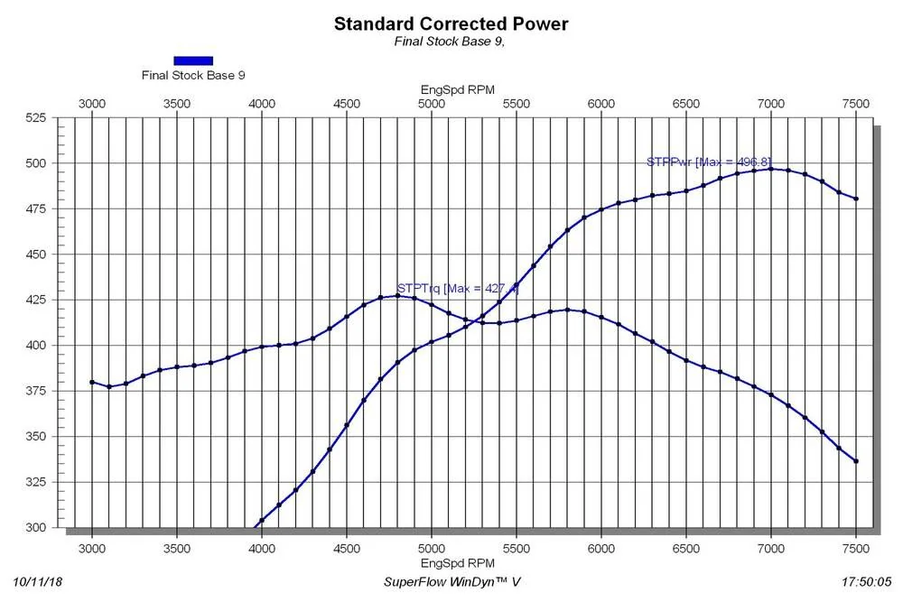

What I'm still trying to uncover - how to get current engine torque or HP. I was able to find engine load data (it looks reliable based on comparison with the corresponding ForScan graphs). But it looks like there is no raw data for torque in CAN bus which matches the graphs of variety ofOBDII apps. But on the other hand there is some data that correlates with those graphs. Also I couldn't find throttle position data, but it is present in ForScan (maybe because ForScan requests it explicitly).

Torque or power would have be calculated ? It's not like they're being measured in any way.
Some of us are interested in this since we might be using telemetry devices for motorsports - if you look at RaceCapture forum (Autosport labs), they have some of the channels (steering angle, brake pressure and few more - I think including TPS) figured out. I am reading steering angle and brake pressure using Race Capture and it does work.
