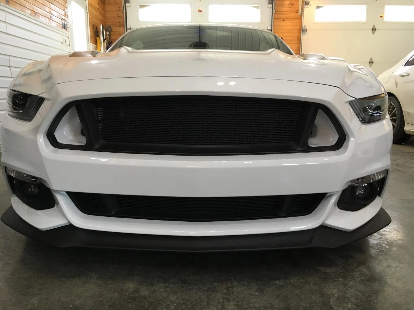

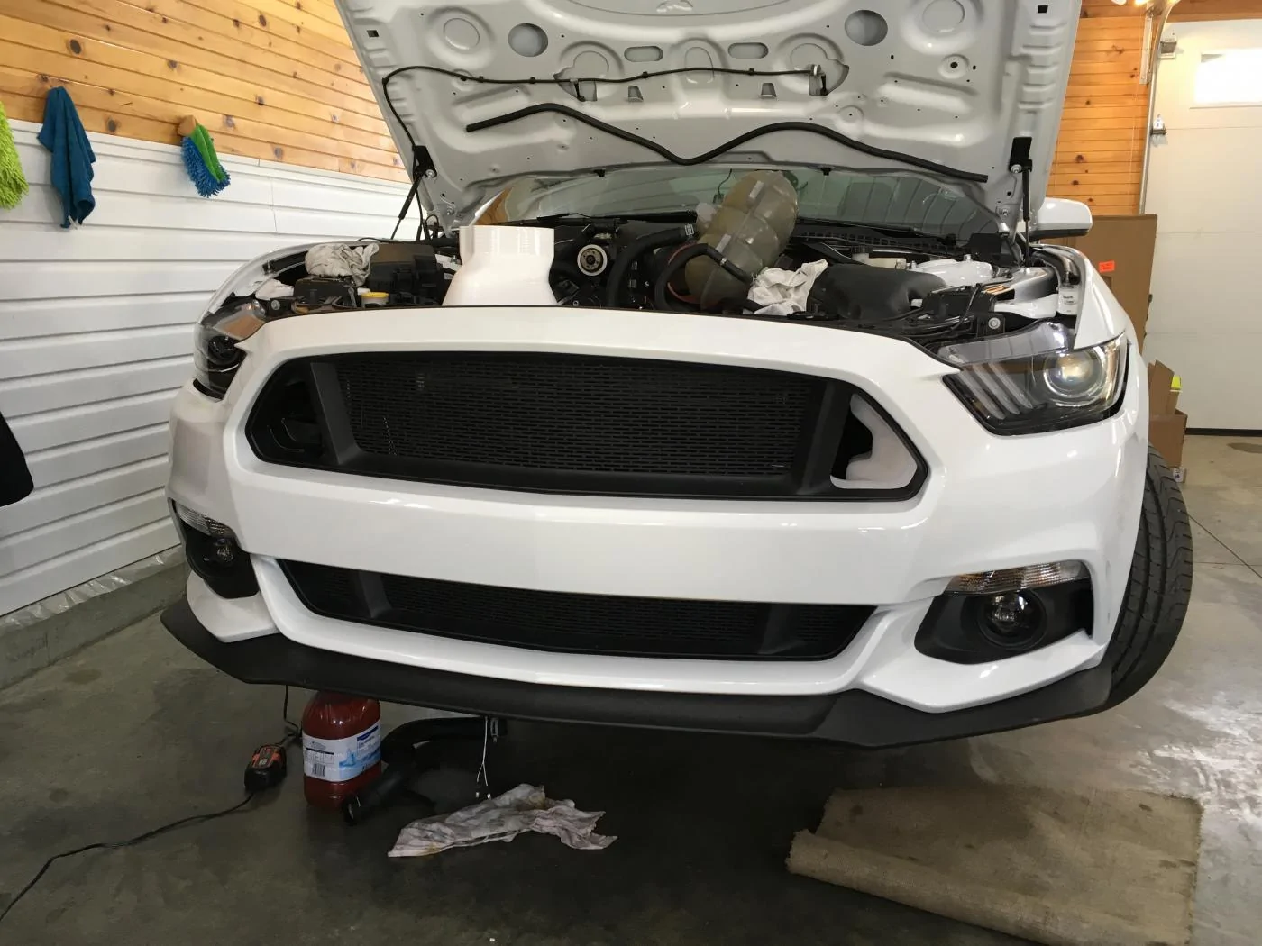

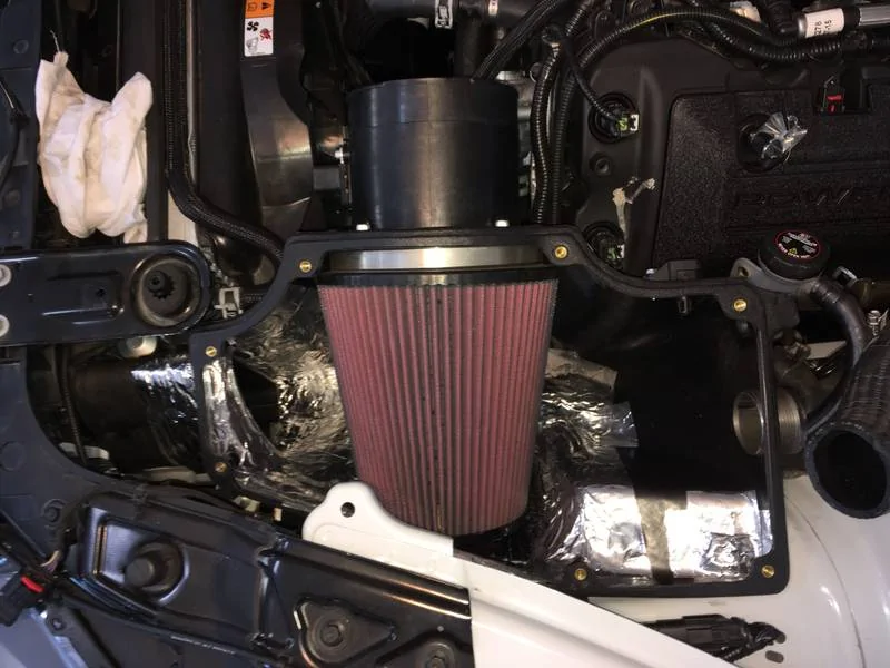

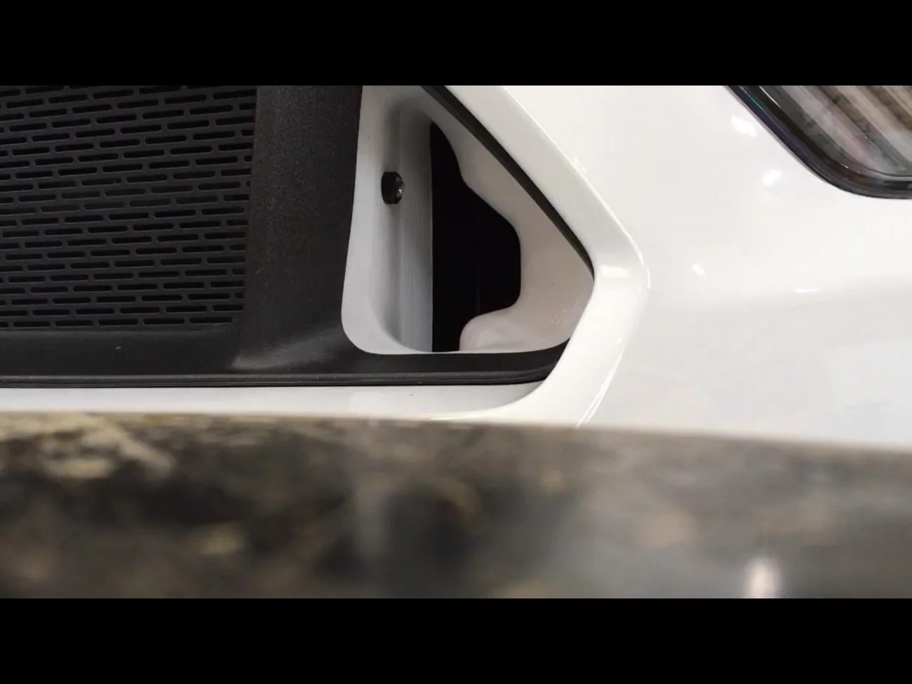

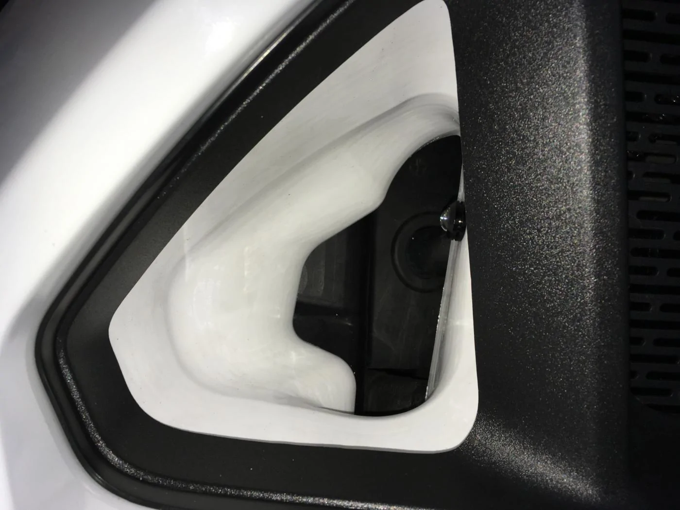

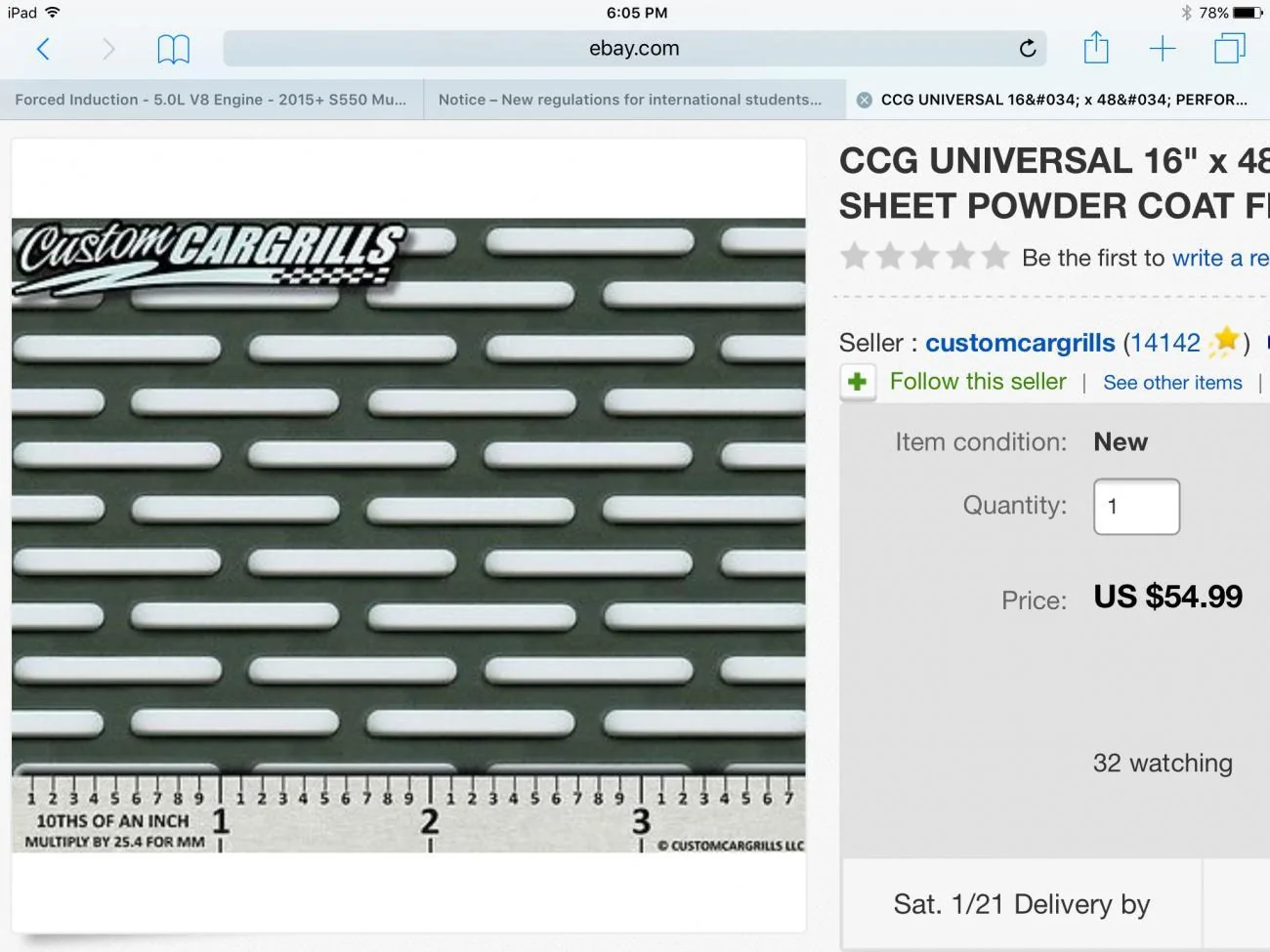

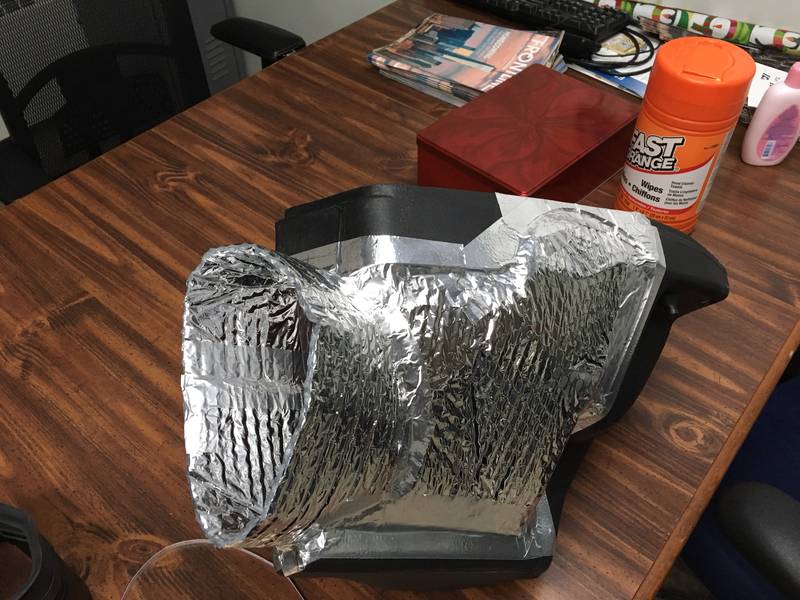

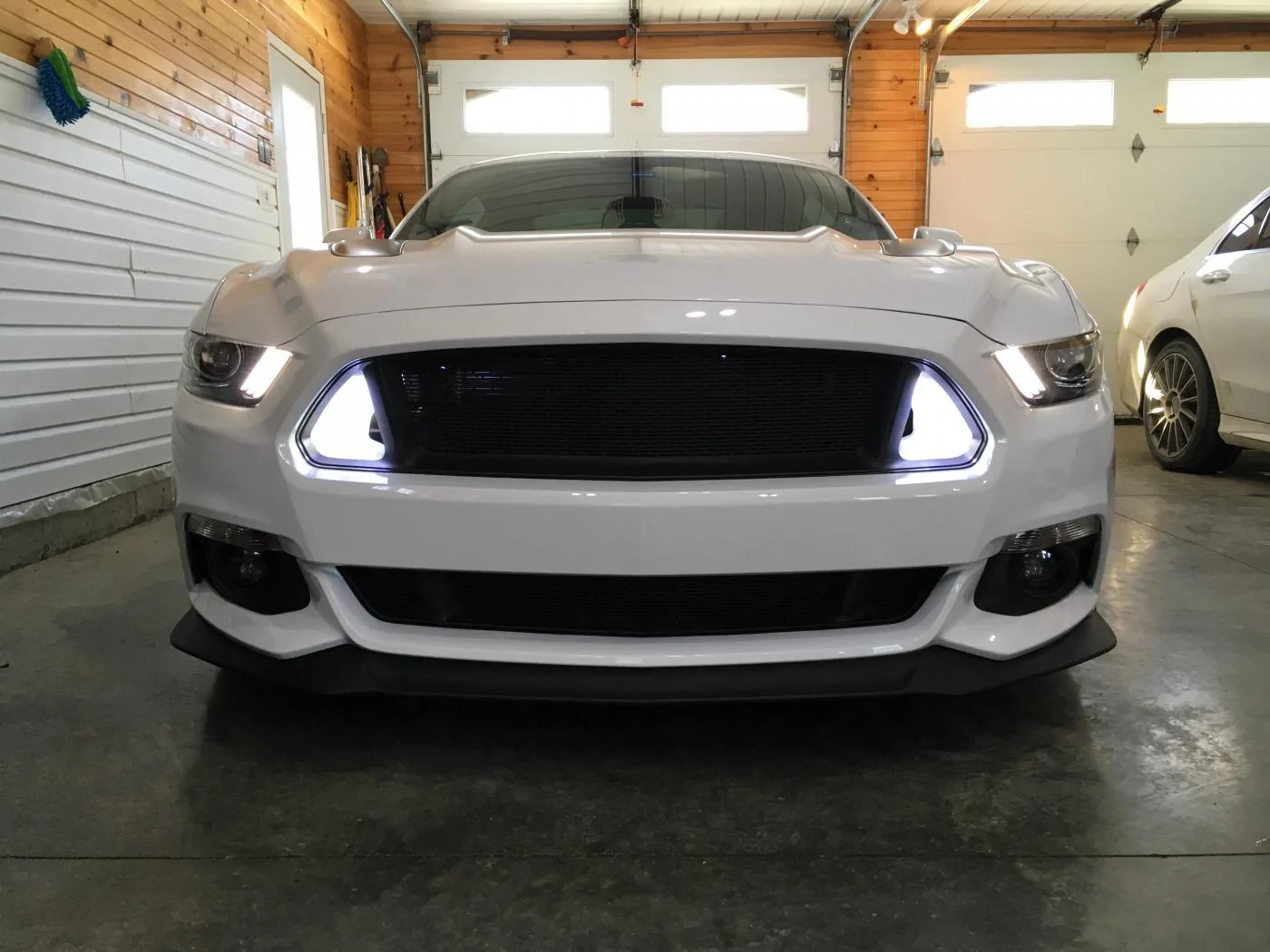

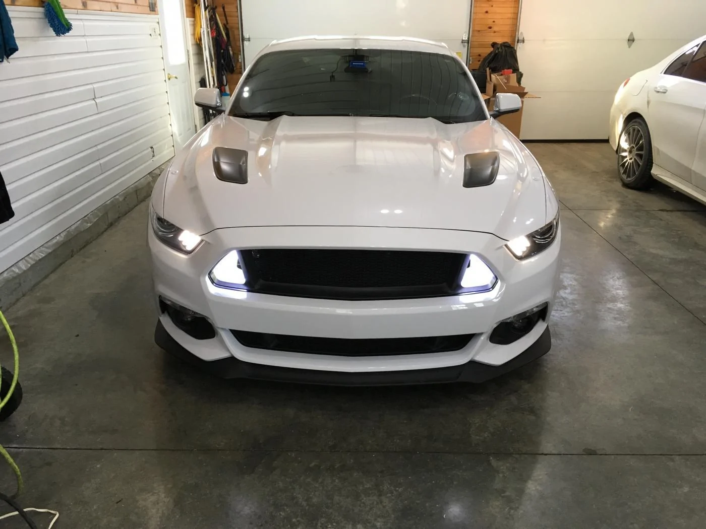

This project was three fold, as I wanted first to design a closed airbox design for my Whipple setup and have a ram air true cold air coming from the front grill. While the bumper was off I also desided to change my grill screen. The grill mesh is from custom car grills 16x48" sheet and I purchase and cut to size. My air box was closed off using using double bubble and the stock snorkel was cut from the OE air box so it would connect into the grill and then connect to the Big mouth ram air. This system is complety closed off from the engine heat and takes air from the front drivers side rectangular grill opening. While I was at this project I decided I wanted color matched big mouth ram air and I wanted one on both sides to match and I also added an LED light to each for a night affect.
No only are my IAT 1 temps reduced significantly, but the look is something unique and functional.

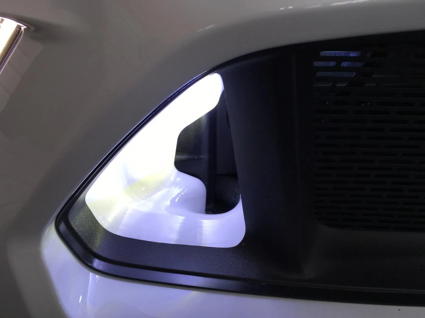

Wirring the LED lights is simple Both lights are wired to one headlight light grey wire with purple strip. Tap in right at to the headlight plug and connect the red LED wire to it. The black LED wire is grounded to frame.
