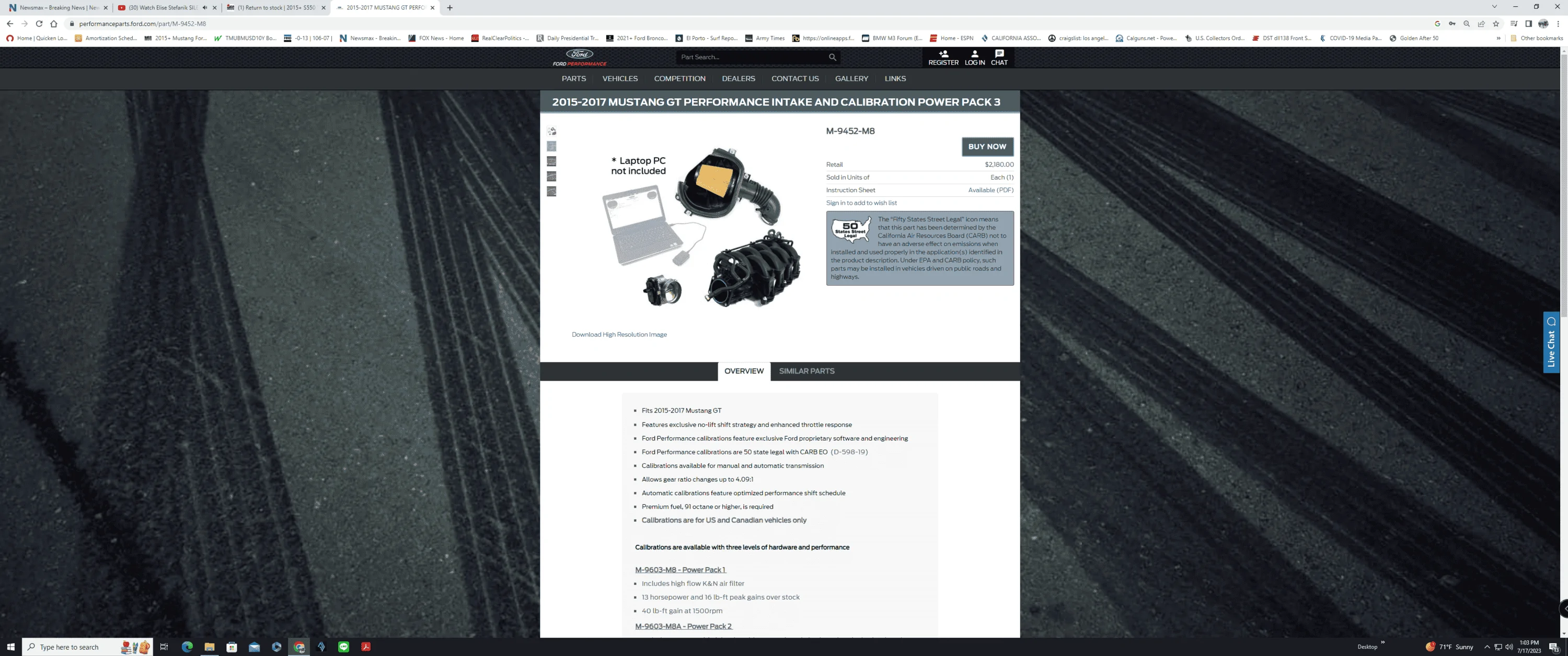

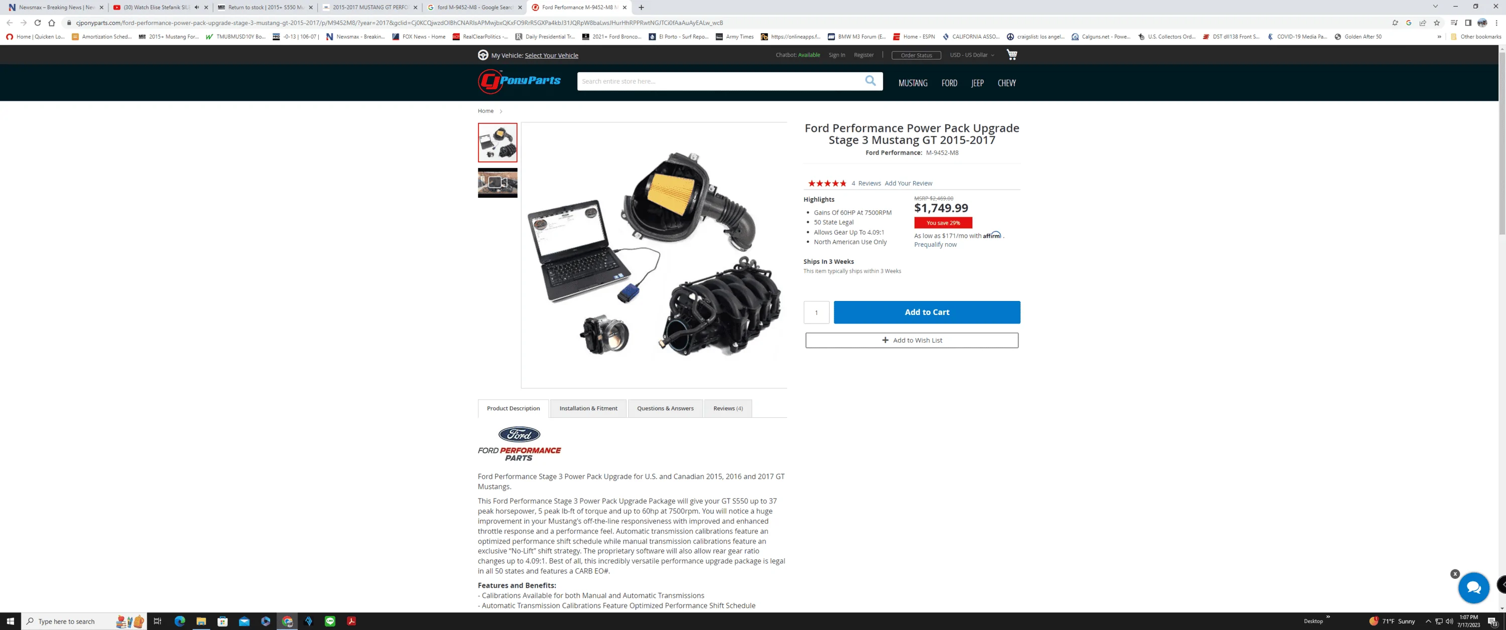

KeithS pretty much nailed it. The seller was responsible for smogging the car for you. However, if it wasn't, then yes you would have to return it to stock to smog. Keep in mind that Ford Performance offered a kit that was smog legal in Cali as a Power Pack 3. Are you sure this is not what you have? Other than the 47lb injectors its pretty much this kit. If its not, it would be cheaper to probably just buy this kit keep the GT350IM on along with the TB and CAI and just install the software which is smog legal. The 47lb injectors sounds like the previous owner was running E85. You can sell the GT350IM and the throttle body separately and recoup some of the costs. I live in Cali, you are more than welcome to contact me for advice via PM and you can even call me.
This kit can be had for quite a bit less.

WH, in Cali as long as there is a tune on it that doesn't have a CARB # it won't pass even with the readiness codes all green, they have software that can tell if its the original or OEM software. Thats why the CARB EO# is so important. Thats why I went with the Ford Performance Power kit for my 2020 Mustang.
To the OP, if the original owner doesn't have the tuning device with the stored OEM tune you will have to take it to a dealer and have the original tune installed. You will have to put on the OEM headers and cats. I would then consider the Ford Performance STG 3 Powerkit I showed, as it will tie in the GT350IM, the TB and the CAI to run with a CARB legal tune from Ford. I know you already have this installed, but you could probably sell the new GT350IM and TB separately and recoup some of your cost. The car won't run right with the OEM software and that TB and will kick off codes. Any codes you can't get a pass other than for EVAP canister to get a go on smog. After that is all done you have to start the drive cycle to get all the readiness codes to go green, this can take a few days. I knocked it out in 2-3 days of driving within the cycle.
A good read...BTW Livernois may have a smog legal tune for this setup. I would call and ask. They offer CARB EO# tunes.
