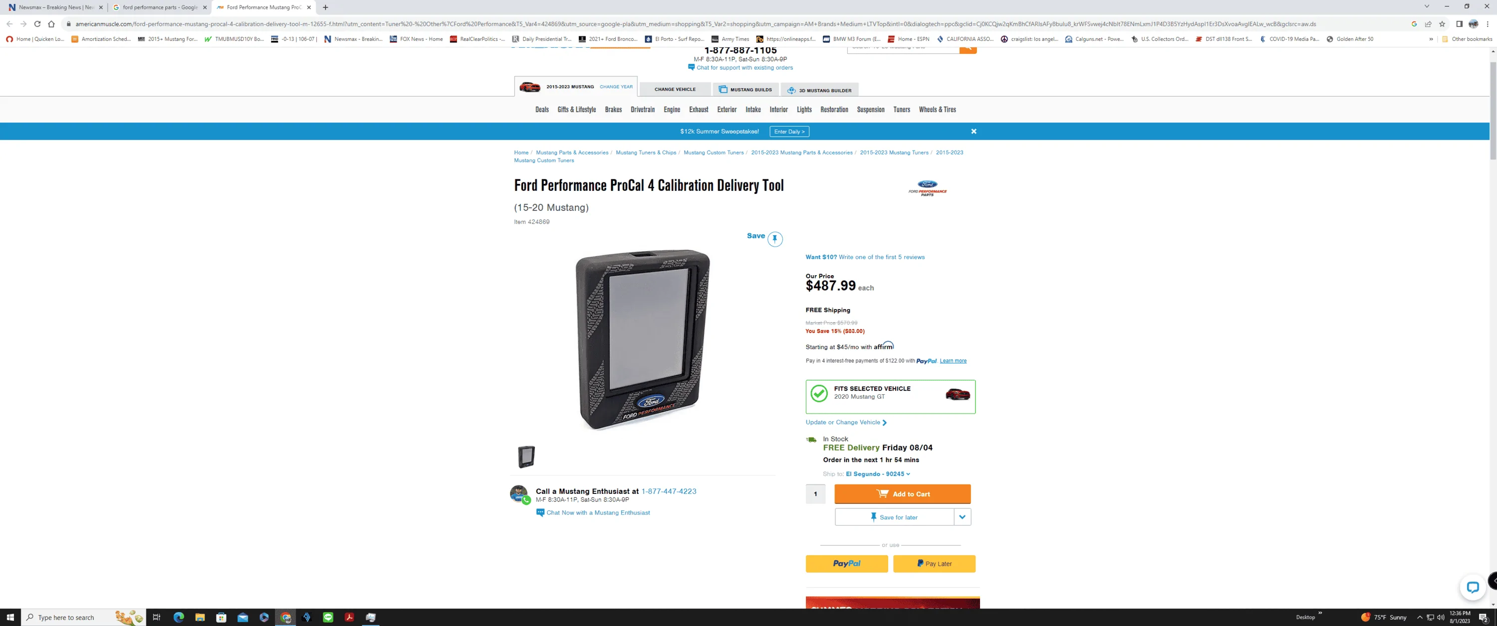

You're not guessing anymore. You are trying to get out of buying the PP3 kit which I understand. Here is an idea...here is the ProCal tool sold seperately,
Give Ford Performance a call, talk to Tom. I found him very helpful. Explain the position you are in and that you bought the car with the PP3 kit installed but the old owner didn't provide the ProCal unit with the car and installed a non CARB legal tune on the car. Buy the ProCal tool and maybe Tom can get you a voucher to download the tune for the PP3 kit onto the ProCal tool, he can also provide the CARB EO sticker.
To be frank I already know what the referee is going to say, and that is you fail because the mods done on the car are not CARB legal. He/she is going to tell you to put it back to complete stock configuration or get a kit that is CARB legal.
Just an FYI, I believe the car is still registered under the old owners name. Until your car can be registered it probably can't transfer title properly, I could be wrong on this.
