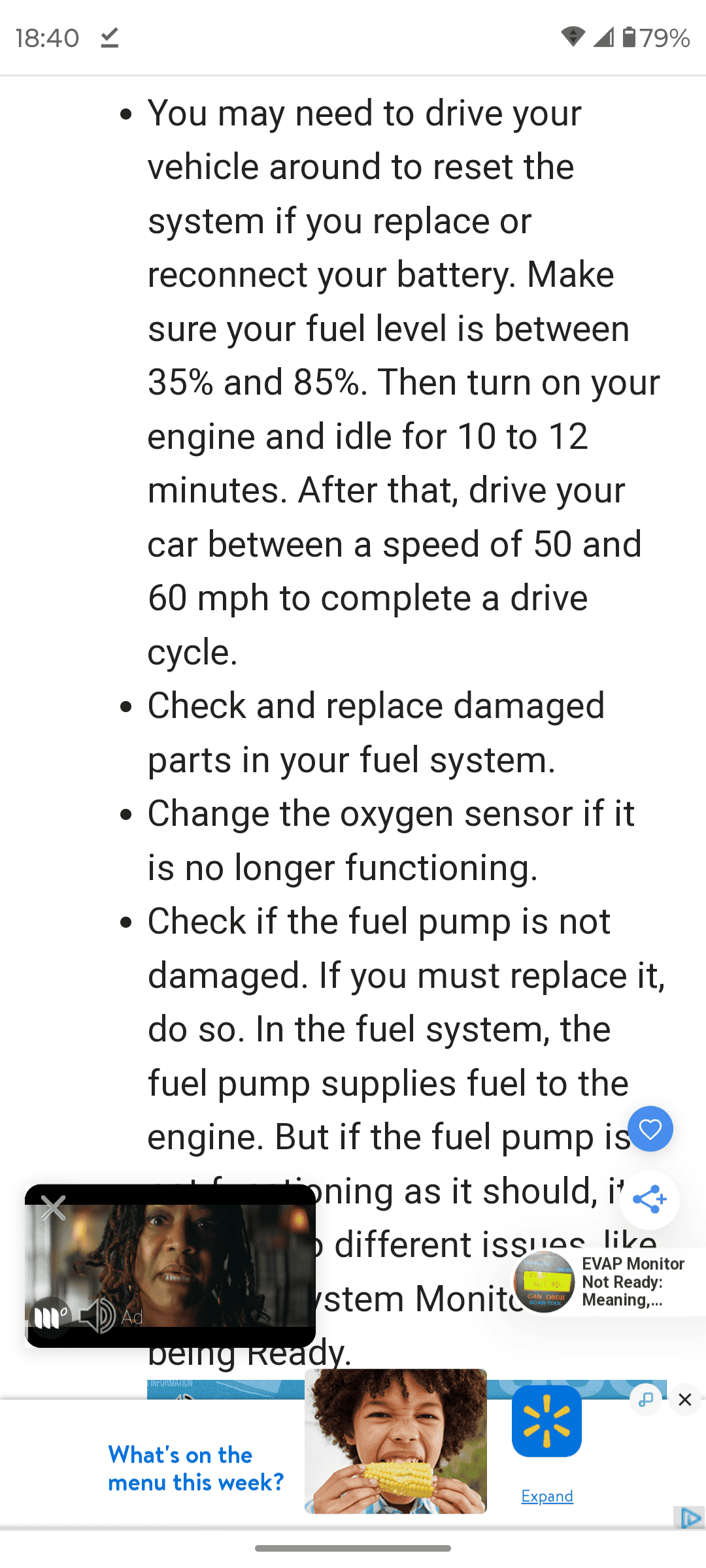

Ok so sct was able to send me a recovery file & i was able to flash my car back to stock. I was then able to give the tuner my strategy code & got a couple of my tunes! But now im having some new issues. First off one of the tunes is an e85 tune & my afr gauge on the dash is showing 11.2ish at idle & cruising which is way lean compared to what it was so im afraid to even try to got wot to see what it would read. I contacted the tuner but they have not got back to me yet. Also my fuel system monitor will not switch to ready & im wondering if that might be from the e85 tune or my mods? One more thing i have seen a couple mentions of emissions tunes while reading some other posts? Is that a thing & where would be the best place to find one? Thanks in advance for any help anyone can offer!
Fuel system monitor is a little tricky. Keep the speed between 50-60mph, with a steady throttle and very little throttle input. I did this by driving Kate at night on the freeway. Here is a brief read.

Thank u dave2013m3 i was actually able to get the monitors all set to ready so i should be good! But the flex fuel tune i got which i actually didnt know it was a flex tune but the air/fuel gauge on the dash is showing alot more lean then it was with my old tune? What is too lean on these cars when running full e85? Mine used to run at 9.8 idle&cruising & 8.5ish at wot & now its at 11.2 idle & cruising & i have been afraid to go wot since its a bit more lean? Does the gauge on the dash automatically adjust for the fuel im using?

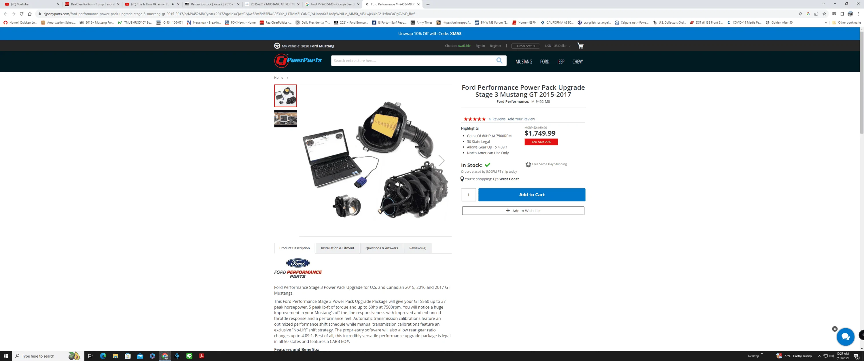

So my smog issues have gotten much worse! I took the car to my smog guy & as soon as he hooked it up the computer it said must see referee! So im guessing it must have had a "hot" smog in the past or smthen? But anyways i have the gt350 im, gt350 tb, & i just ordered the gt350 airbox, so i will have a ford performance pack 3 which is smog legal. My only question is does anyone know if i will need the procal tune or whatever it is or is ther anyway for me to get that tune without purchasing a performance pack setup? The tune i have now i would think should work all my monitors are "ready" & i dont have any cel's but obviously the smog referee is gonna check everything im sure & im hoping that since the ford performance pack is California smog legal i should be good? I also had some stickers made with the ford performance pack c.a.r.b. & eo numbers on them to put on the car. If anyone on here lives in California & has the ford performance pack 3 has anyone had any issues passing smog? Thanks in advance for any help!

You basically are going to have to do what I said a few weeks ago. I would return the car to stock as far as the stock tune. Purchase the Ford Performance Pack 3 kit with the ProCal. Just install the software from the ProCal tune. Sell the unused items from the new PP3 kit to recoup some of the cost. You are going to need that ProCal tune with the CARB EO#. My E92 M3 had all its readiness codes all green and I still couldn't pass with the tune on the car. I had to put the stock tune back in, I already put the cats back on (it had test pipes). The AFE CAI already had a CARB EO#. You already have the other E85 tune, once you pass switch out the tune. You can then return the car back to the PP3 tune when you have to smog.
You can get the kit for around $1750.

It will pass with the Ford Performance ProCal tune. As the whole package has a CARB EO#.
You can reach out to Ford Performance but without the ProCal I don't know what they can do.
