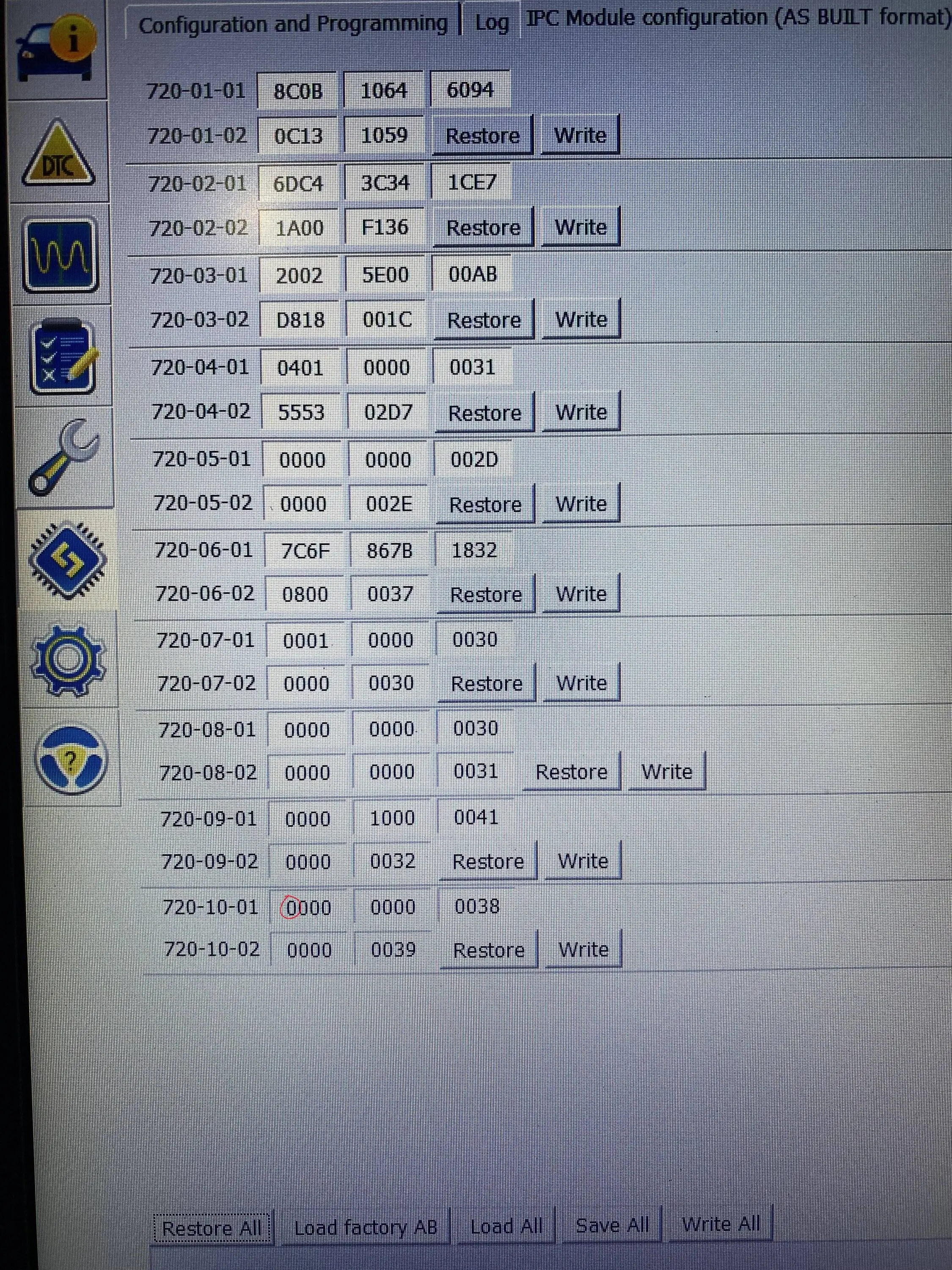

I was able to find some used AE mufflers with actuators and ordered them. I wanted to test the enabling of the AE in Forscan while I wait for them to arrive. I know from lots of reading that I change 720-10-01 in the IPC module (this is for a 2018 with standard display cluster (not digital).
I think I understand what I need to do...can anyone verify the "0" circled in red in the picture below is the ONLY number I change (and I change it to "2"). I pulled this up this morning but wasn't quite ready to save any changes until I got some more info and/or confirmation (I haven't done any "As built" changes with Forscan :-) If I change that "0" to a "2", do I then just hit the Write All button?. Sorry for the newbie question...just want to be sure I do it right and don't muck something up. Appreciate any help!
