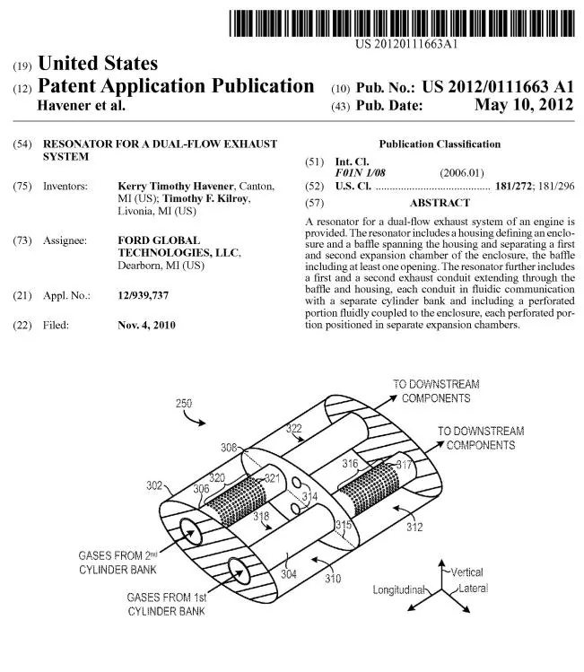

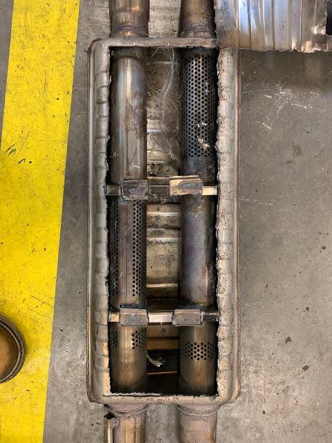

Just adding a picture of a cut open Mustang GT resonator for future reference here. Picture is from username ACES550. I assume the wall between the compartment has holes corresponding to item 314 in patent diagram on Synyster’s pic

Just adding a picture of a cut open Mustang GT resonator for future reference here. I assume the wall between the compartment has holes corresponding to item 314 in patent diagram on OP’s pic
was gonna harass you about posting on a 5 year old thread, but this is cool 😆
