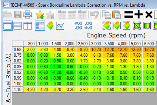

Just FYI, this is a stock boss lambda vs blk spark table:
This table adds almost 13 deg timing as the engine goes rich. Conversely, if it goes lean, it removes almost 13 deg timing. Most aftermarket tunes zero this table out because it's less math for them to worry with.

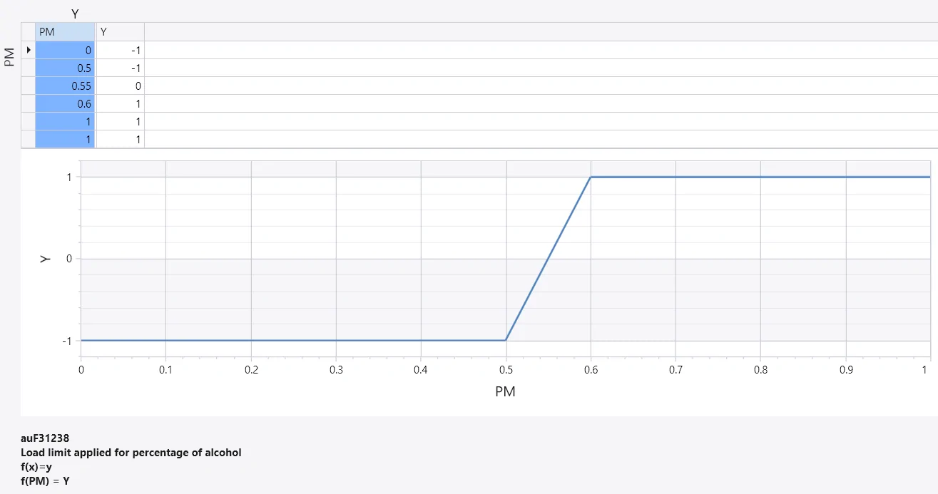

This is how I limit boost as a function of learned ethanol:

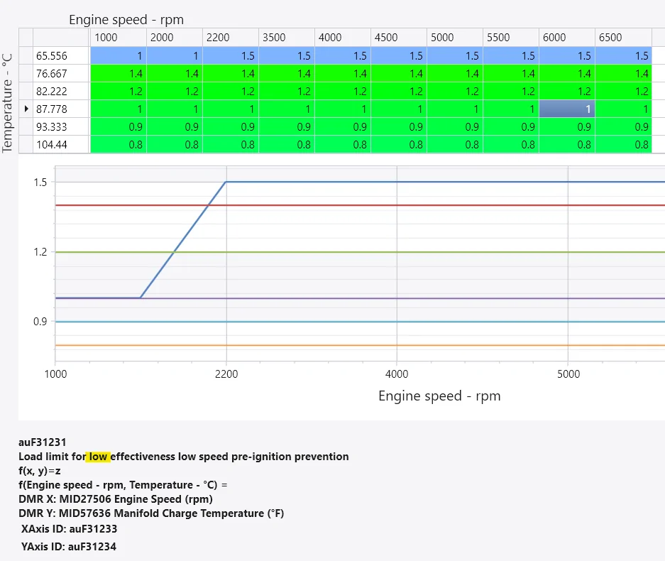

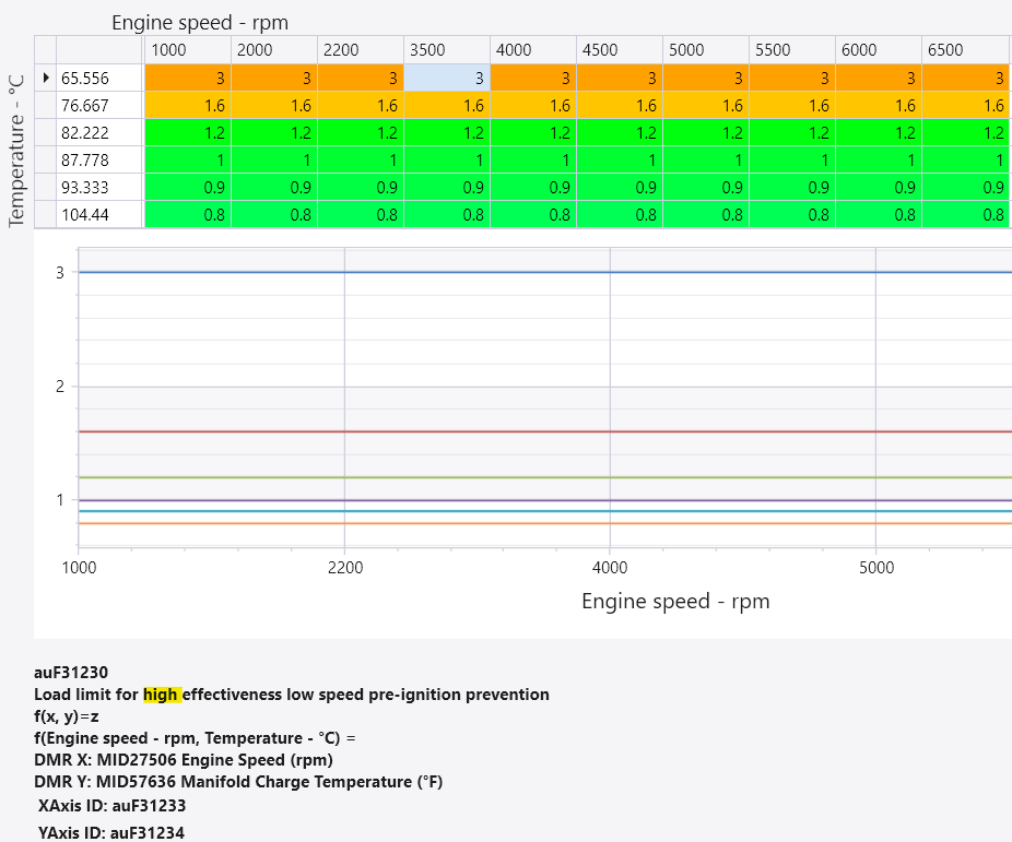

This table converts the learned ethanol % into a factor from -1 to 1, just like octane modifier. It then uses this factor to weight the load limit tables. -1 uses the low load limit table, 0 uses the nominal table, and 1 uses the high table. Below is how I have the low and high limit tables configured:
When learned ethanol is less than 50%, the -1 factor causes it to use the above table which limits load to 1.0 (about 0 psi boost) at low rpm and 1.5 (about 10 psi boost) at mid and high rpm.
This table changes the load limit to 3.0 when it learns 60% ethanol or more.
Both tables still limit load when the charge temp rises excessively, though I could probably increase this a bit when high ethanol is learned.
