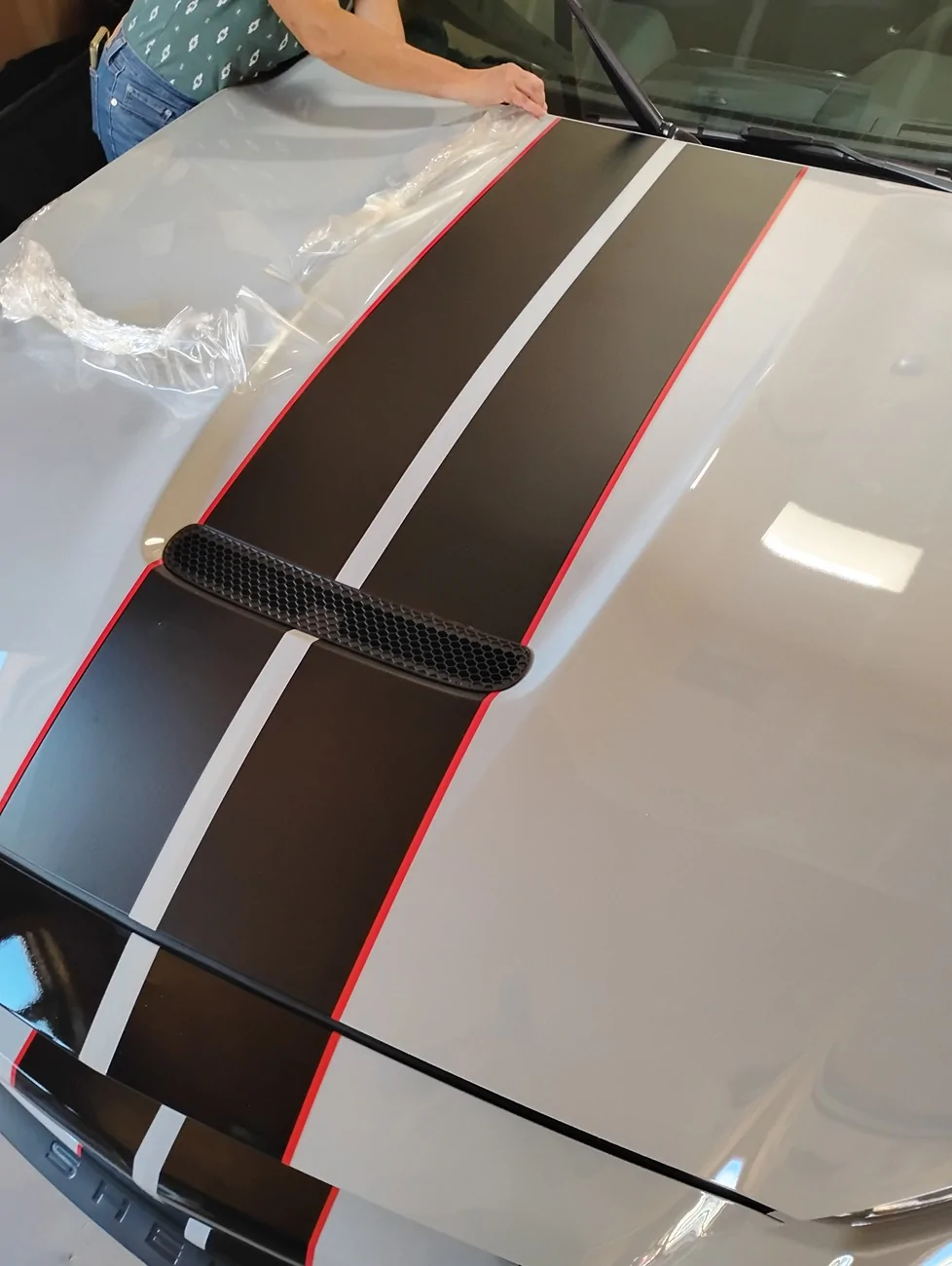

I'm reviving this thread as I'm thinking about removing the PPF on my 17 R. The original owner had PPF done over the stripes and was hoping to remove it without damaging the vinyl stripes. Anyone else have success doing this and what technique did you use?

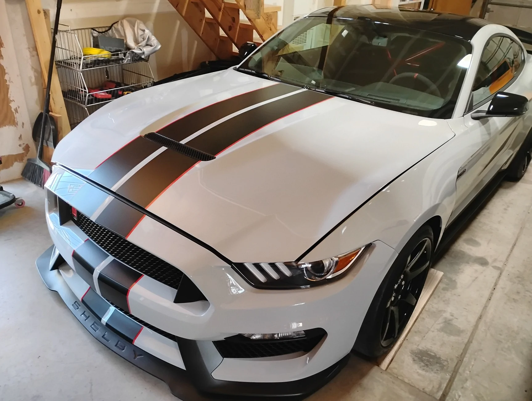

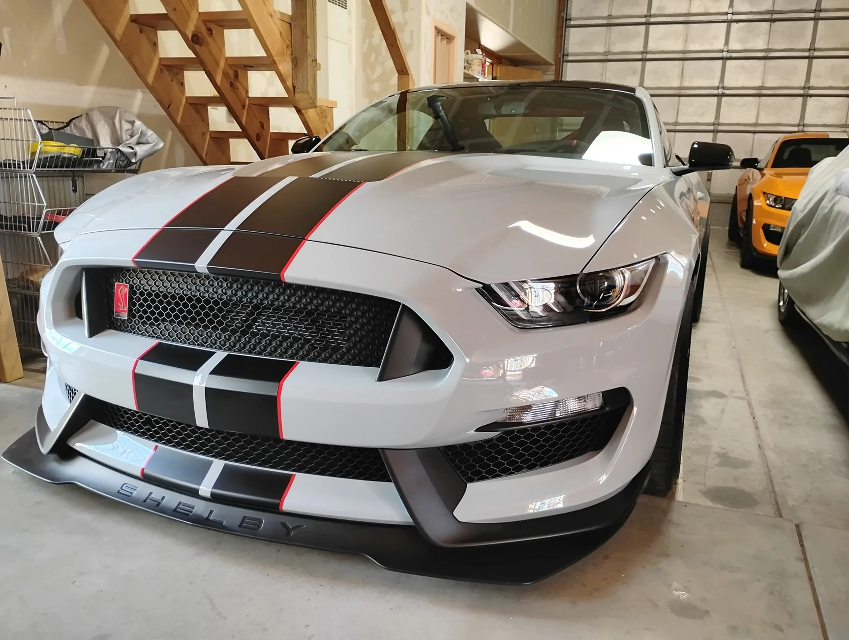

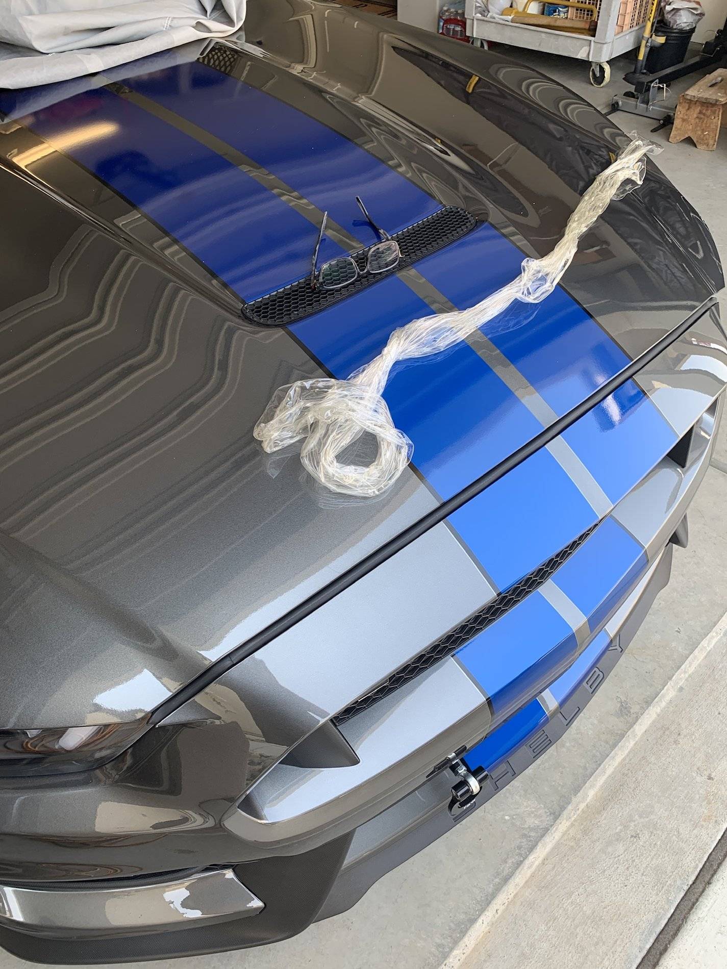

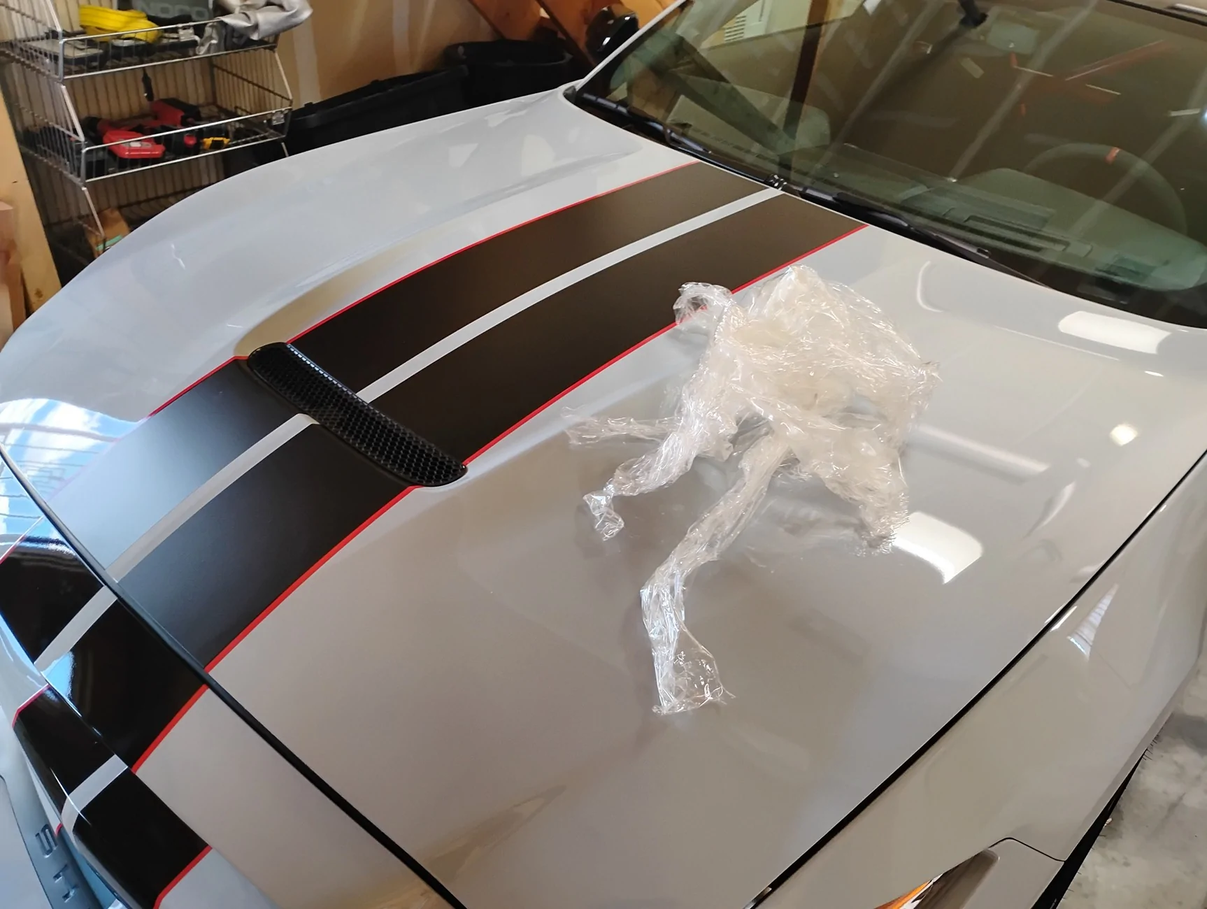

Success! I was able to remove the PPF from the hood today! It came off the stripes with no issues! I used a hair dryer in spots but didn't use any heat near the stripes. My back and non working mans hands are suffering though! Took a couple of hours. Still have the bumper cover and the fenders. But the big part is done! The original owner said he had it done shortly after he bought it in 16 so it's 9 years old. Its XPEL so at least it's a quality brand.

Just be careful on the bumpers since they’re plastic. I’ve seen a few people try to pull vinyl/PPF off of plastic bumpers with little to no heat and it pulled paint with it. Use some heat to loosen up the glue (or rent a steamer, steam is the best to remove vinyl IMO).
