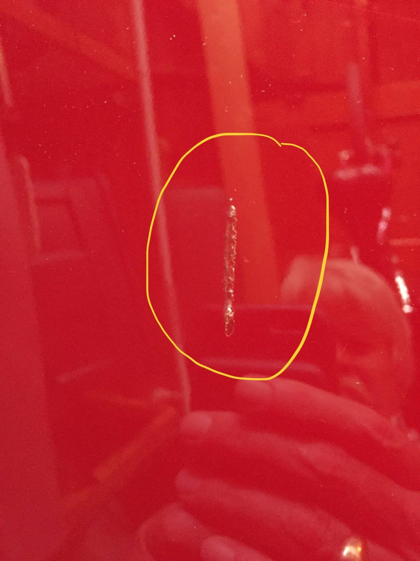

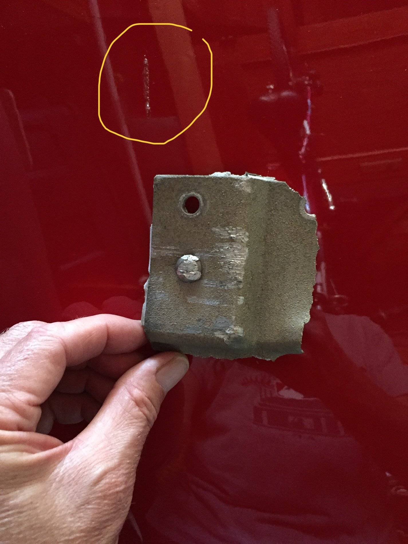

Unfortunately I have a sad story that starts with I saw the rock in slow motion...
That being said I am left with this awesome mark on the hood. I dont think it made it to the stripe, however I want to remove the PPF and deacon the car. Polish ans ceramic coat it before winter. Has anyone taken off PPF with stripes? Any issues.
I have had success with removing ppf over vinyl but I'm not sure if the technique would apply to a car hood that's double walled (or reinforced, or whatever you call it.). In one instance I went very slow removing the PPF with minimum heat and held the vinyl stripe down with a plastic vinyl applicator as I lifted the ppf. In the other instance I held a cold pack to the back of the panel while I applied just enough heat to the ppf to let the glue release. The cold pack kept the vinyl glue from heating up just enough so vinyl stayed adhered.
I cant stress enough how much of a pain in the ass both approaches were, and if your replacement vinyl is cheap enough, just be prepared to replace the vinyl.
