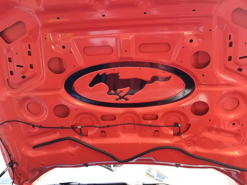

Is there still the Mustang logo under the headliner ?
No pony logo under hood liner on 2018 (at least mine doesn't have one when I took it off).

I'm afraid the running hosre doesn't look as good on the 18 as it did on the 15- 17

Is it painted under there?

Love the logo, I've seen a vinyl kit that highlights it.
