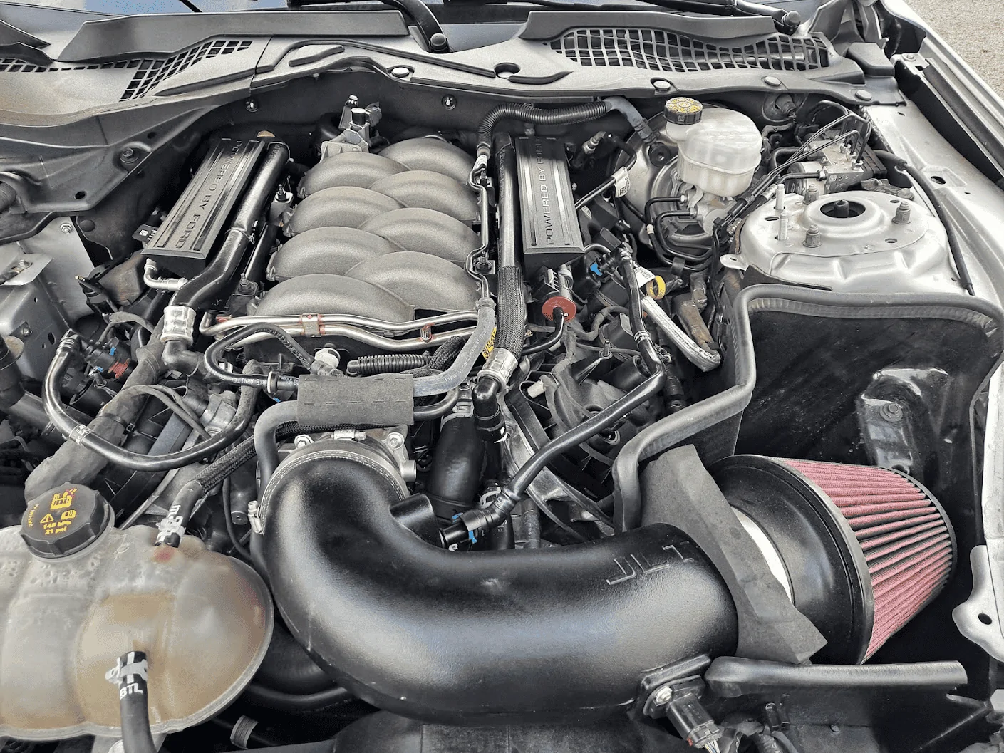

Twist off , twist on.
20210720_173406 by chefjpd, on Flickr
